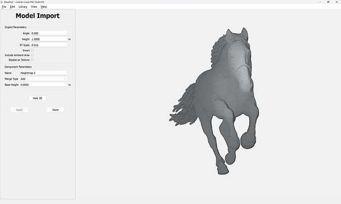

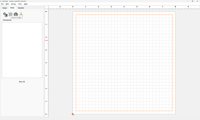

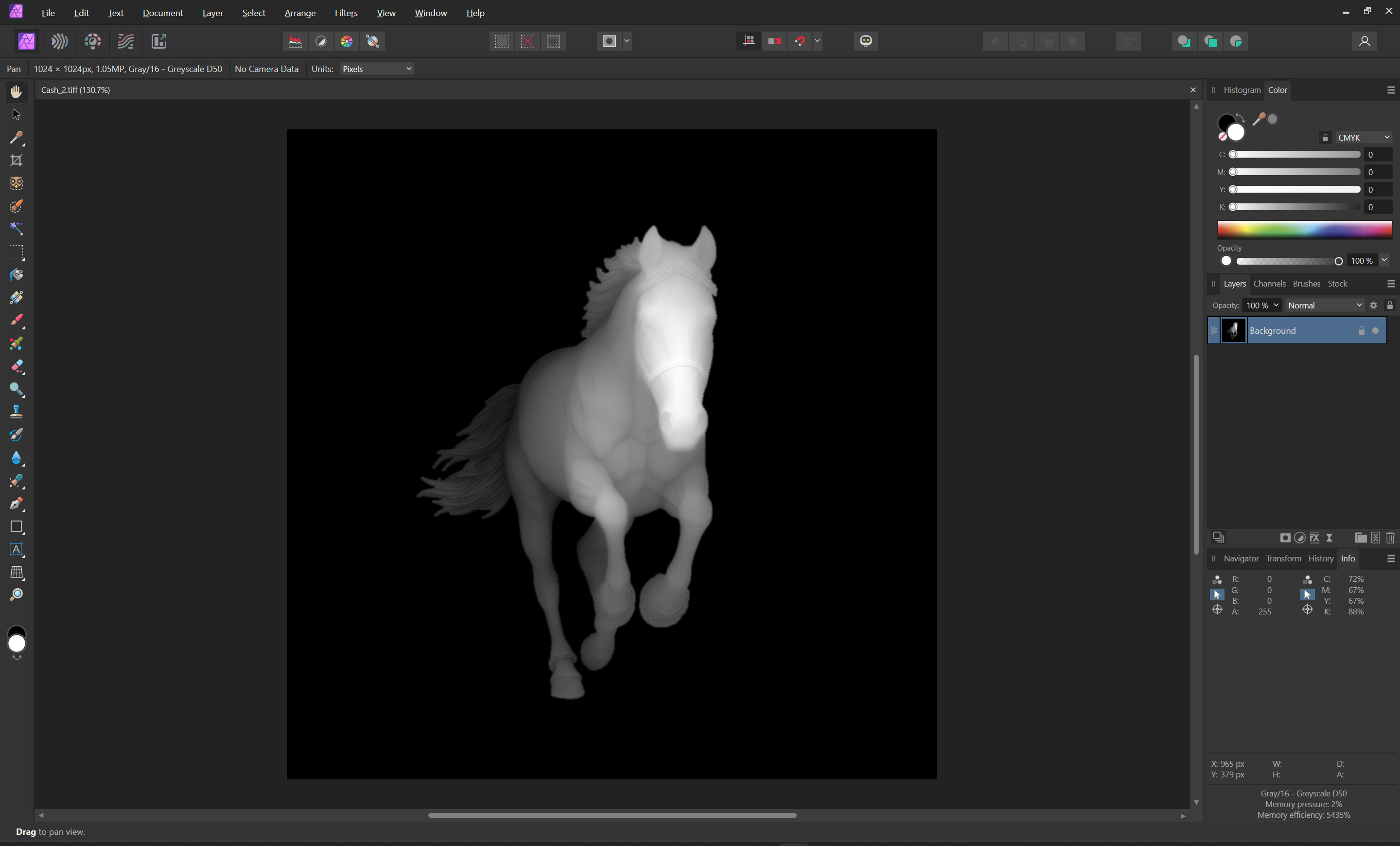

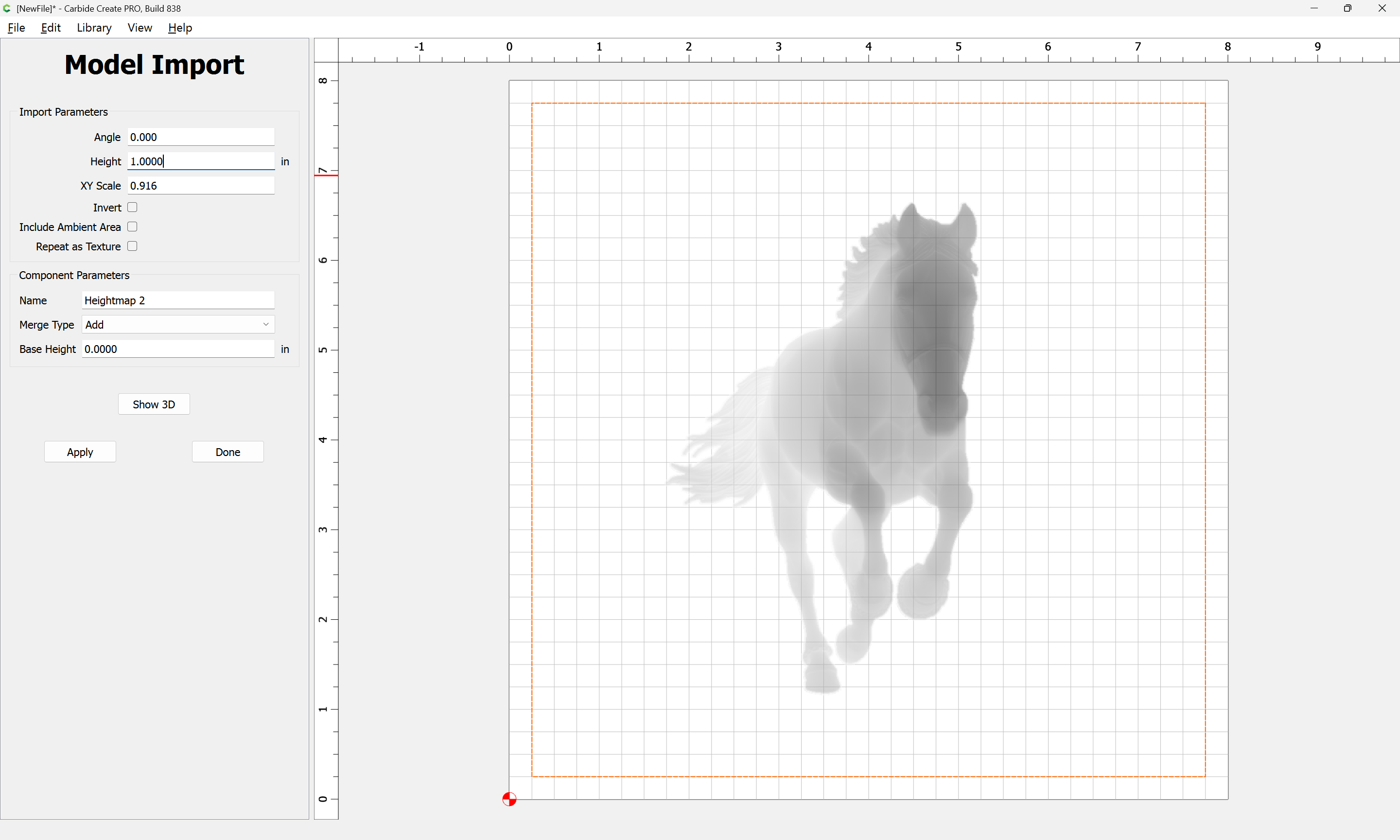

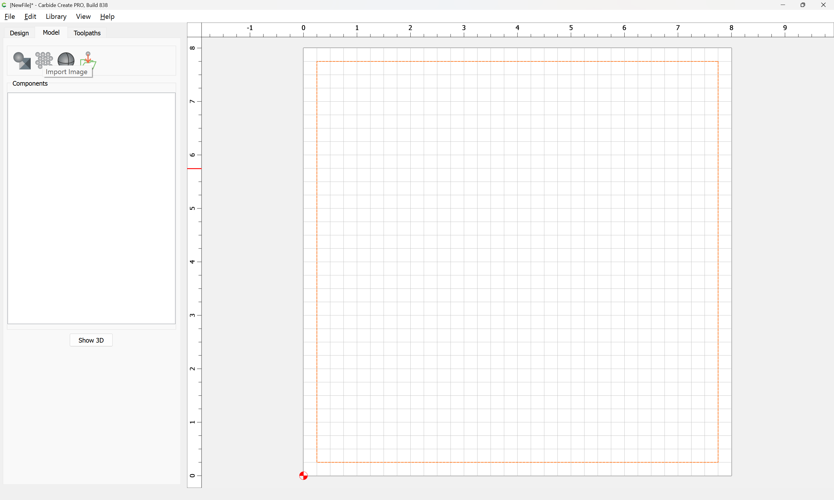

If you have a TIFF file which is a height/depth map, it should work to open it in a pixel editor and re-save as a PNG or JPEG which Carbide Create Pro will import.
Opened in a pixel editor:
exported as a PNG and imported into Carbide Create:
Show 3D
Attached as a v8 file.
cash_horse_v8.c2d (748 KB)

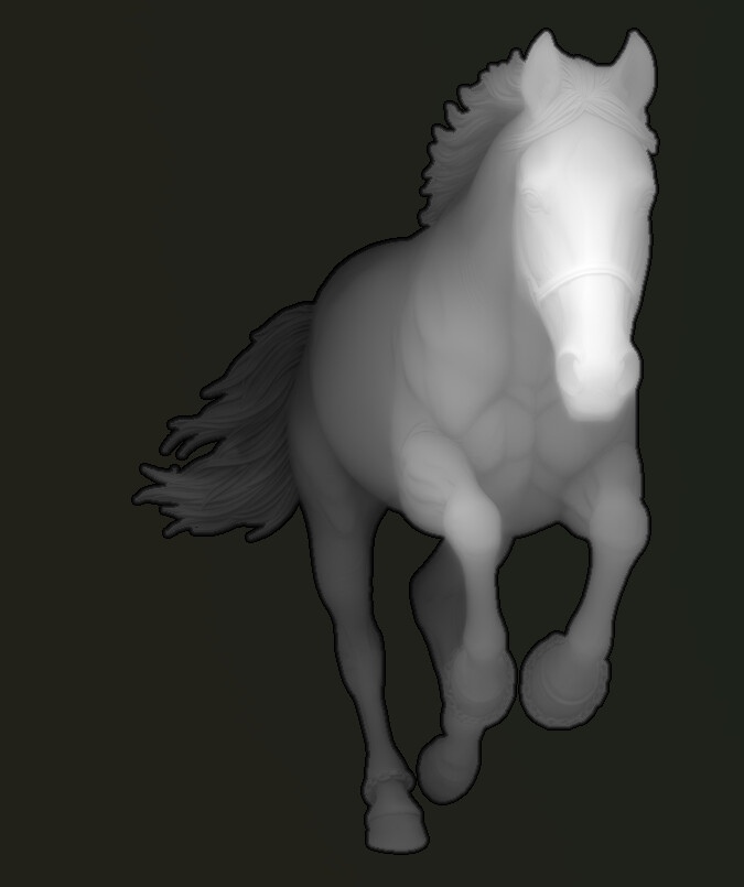

I use https://www.sculptok.com free version to convert my photos to an STL. It does not need to be a grey scale image, but I sometimes use ChatGPT to convert an image to grey scale before use, if needed. You’ll need to play with the adjustments in sculptok to get the look you want. I did these two STL samples off a download of your image. They were too large to attach, but you can get them from the links below and import one into CC. You will need to create your own toolpaths.

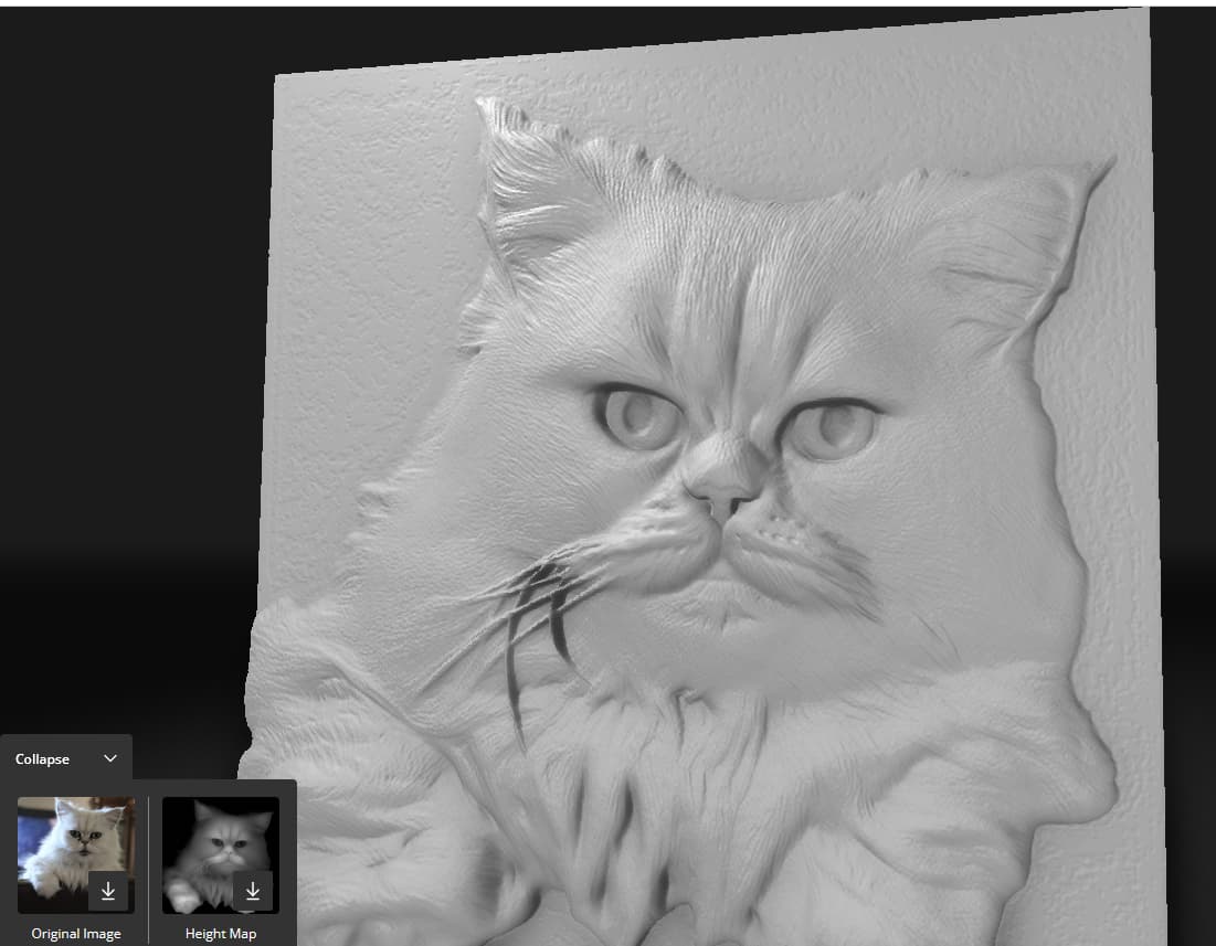

MakerWorld has a Relief Sculpture Maker in its Maker Lab section of the site. If you register an account, you get a certain number of free credits per month to create reliefs from photos. As you can see from the screenshot using a photo of my cat, you can download an STL 3D model or a 2D height map. BTW I am not affiliated with them other than being a regular user.
https://makerworld.com/en/makerlab
