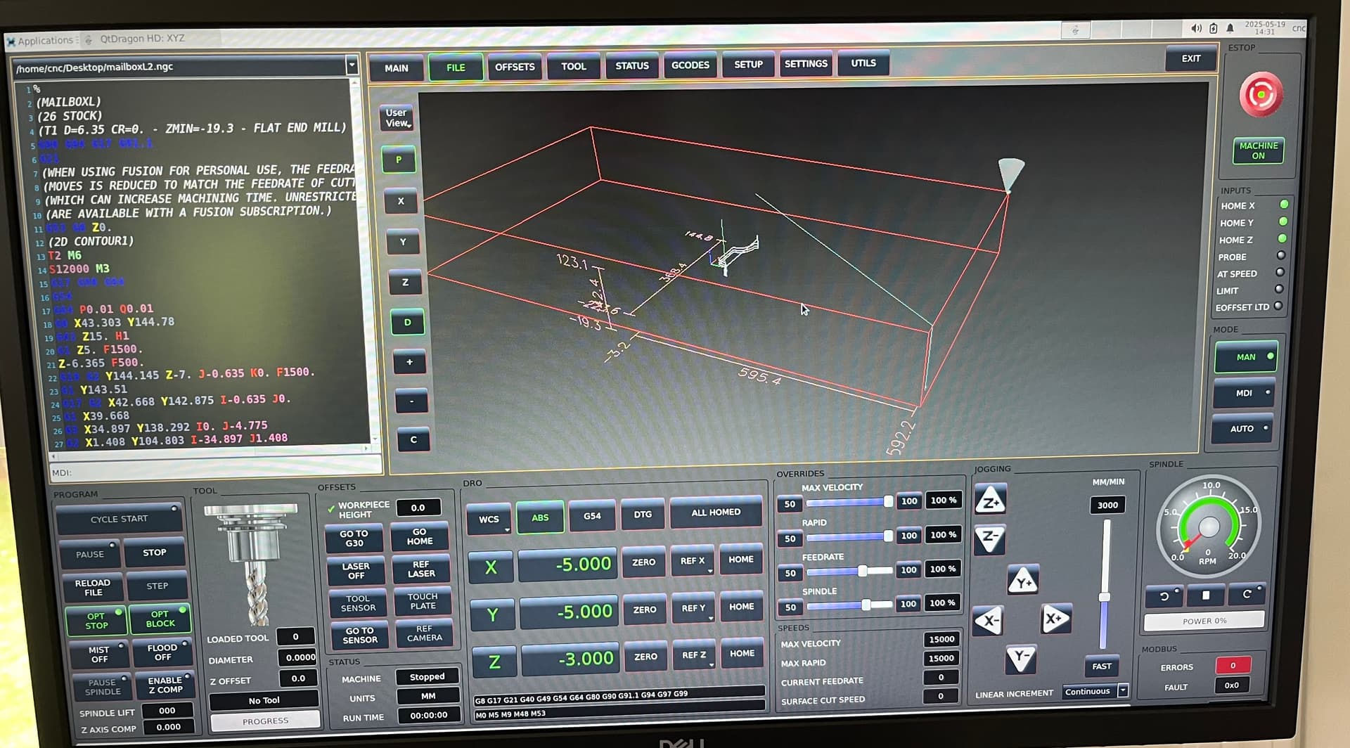

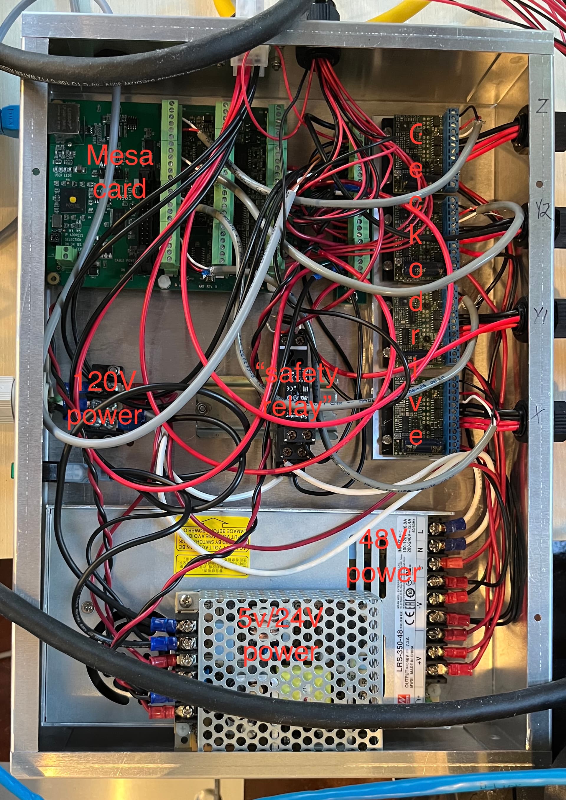

I converted my SO5 4x2 to a LinuxCNC control system and it’s vastly more capable and easier to use. All for about $650, including the Raspberry Pi 5.
Probing routines are available in various UI’s. I’m using QTdragon.
I’m happy to share the details.

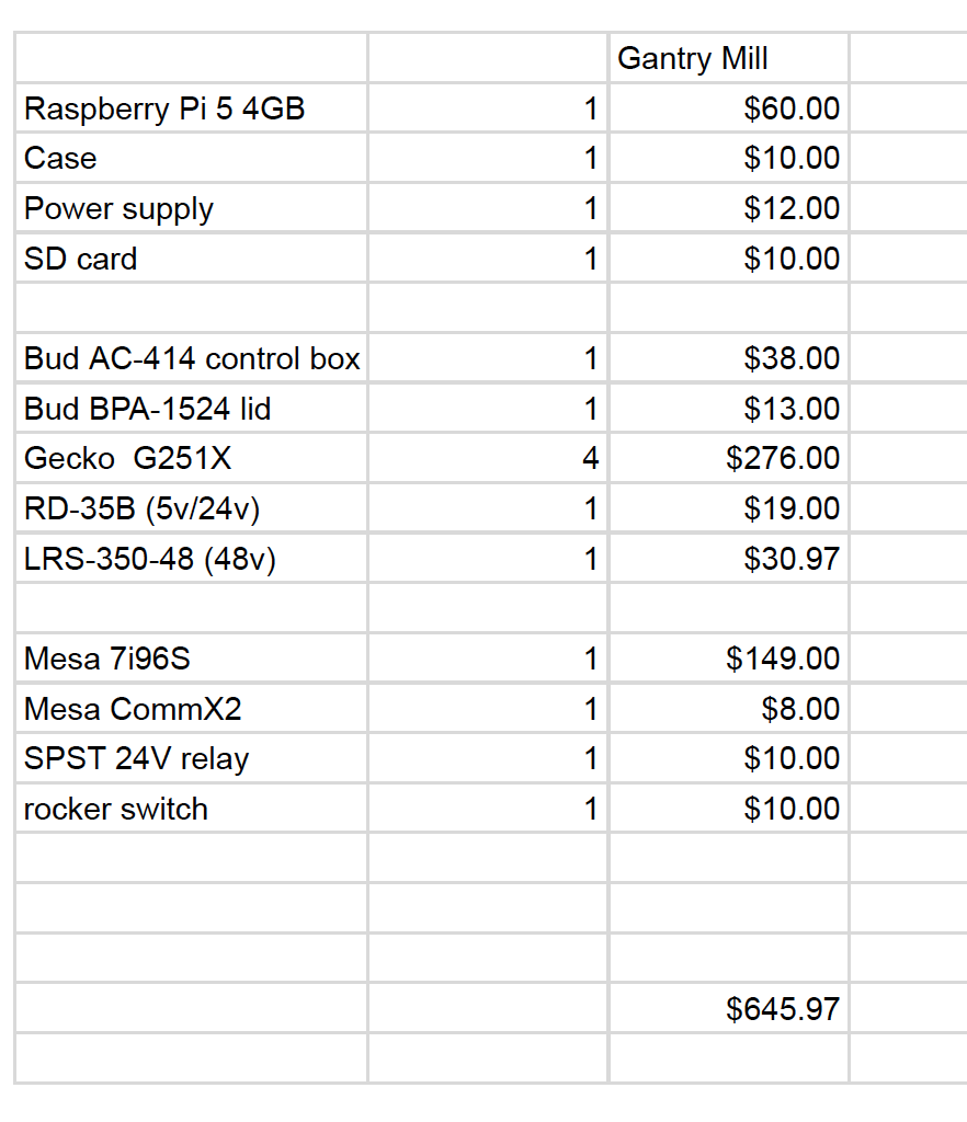

As an introduction, LinuxCNC (linuxcnc.org) is a free, open source software used to control CNC machines, robots, etc. It is fairly agnostic to hardware, so it is not a “system” and it’s not plug and play. My system uses LinuxCNC running on a Raspberry Pi 5, a Mesa Electronics ethernet interface board and Geckodrive stepper drives. There are several choices of UI, but the nature of LinuxCNC is that everything is customizable. I use the “QTDragon” interface on my system.

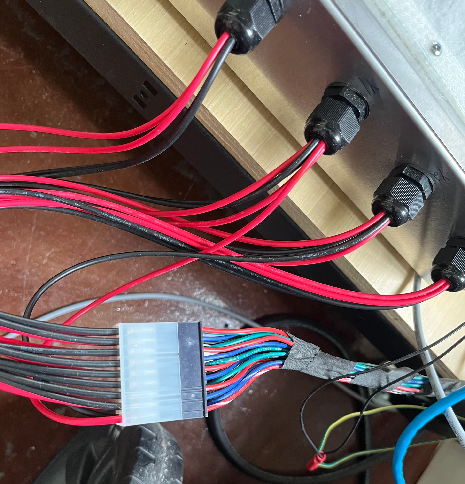

The stock SO5 controller has three connectors: an 18-pin for steppers and LED, a 22-pin for home switches and bitsetter and a 6-pin for power/estop/pause. My goal was to use the factory wiring as much as possible (i.e. just replace the controller).

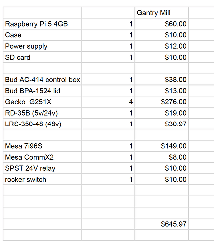

The cost breakdown (less wire, connectors, etc.):
The actual control box:

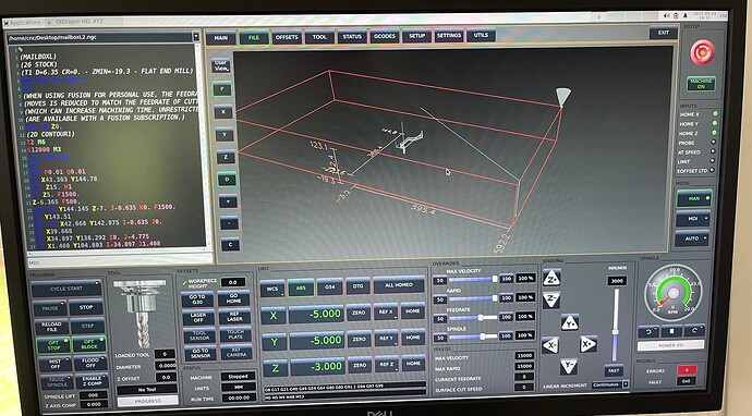

Screen (QTDragon UI):

I’ve been using it for over a year, but I’ve used LinuxCNC for over 10 years on a CNC mill. It’s rock solid and used by many to run production machines.
Easier to use: Jogging, homing, work coordinates, start / stop spindle all from the main interface. G-code scrolls as its running. Visible indication of tool position, work envelope (soft limits) and toolpaths. From cold startup, I’m ready to run the machine in less than 60 seconds, including homing.

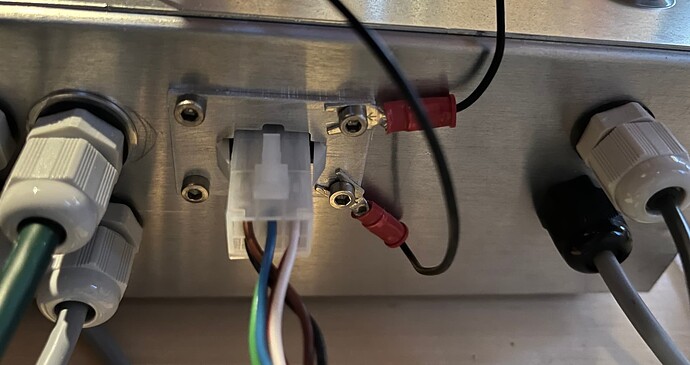

Curious, were you able to use all of the factory connectors/do you have photos of the connector setup you ended up with?
I used precrimped 18" wires available from Newark/Allied/Digikey to make pigtailed connectors for the stepper and home switch connectors. Then ran the wires through cord grips. I used a panel-mount connector on the box for the power/estop connector since it has a long cable. Had to make a little machined plate to fit the locking tabs.
