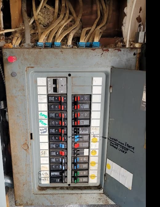

Hopefully you don’t have any AFCI breakers.

Is the AFCI breakers not good for the VFD spindle, like GFCI? I am not experienced with electric, so I am going to have an electrician come and do an inspection/give quote for any needed circuits/upgrades. Not sure if you can tell much from this pic, but here is the breaker panel for the whole house (I still have to check to see which breaker is responsible for the outlets in that room):
I am assuming that work will definitely need to be done so I can run the Shapeoko, the 1.2kw spindle, PC, and dust collection system simultaneously . I was also planning to get a small WEN air filtration unit (which shouldn’t use much power), some LED shop lights, and some other small power tools.

I downloaded your picture but it was too blurry to tell for sure about your breakers. That seems like an old box but it could have had the breakers updated.
GFCI is Ground Fault Circuit Interrupter That is constantly checking for a delta between each of the 3 legs. If the GFCI sees the delta decrease it snaps the breaker off. The purpose is to keep you from getting shocked. A washing machine is usually steel sitting on rubber feet. So if the hot was to short to ground or the case when you touched the washing machine case you would be shocked. Because the GFCI would sense the short of the hot to the case it would preemptively shut off the circuit keep you from being shocked. On VFD (spindles) they are creating 3 phase power and when the motor slows or speeds up the GFCI senses the imbalance and shuts off the circuit breaker. Although the change is normal the GCFI does not agree and that is why you usually canot run a VFD on a GFCI circuit.
AFCI Arc Fault Circuit Interrupter Your AFCI breaker trips due to hazardous sparking, helping to protect you from electrical fires. Common reasons for your AFCI breaker trips include incompatibility, faulty devices, damaged or faulty wiring, and overloaded circuits. Identify the problem by isolating the device or circuit that’s having issues. If you have ever plugged in a lamp that was already switched on you get an arc at the plug. This would trip the AFCI to prevent that arc from catching your curtains on fire.
AFCI/GFCI Combination This is a relatively new device that combines both the Arc Fault and Ground Fault into a single breaker and/or outlet. You can install AFCI/GFCI breakers that would protect an entire circuit or just an outlet and only protect that outlet.
When I installed my home electrical circuit I used the outlets for GFCI because the breakers for GFCI and/or AFCI are double wide. I only had so many places for electric breakers and space was at a premium. GFCI is required any place you are subject to water. Usually your front/back porch outlets are GFCI as well as outlets in a garage. When you drive your wet car into the garage you are subject to electrical shock. They have been using GFCI per US electrical code for about 20 years. Before in older homes you would have to retrifit the breakers or place a GFCI outlet to protect that outlet and any down the line. GFCI has a Load and an Input lug. You put the incoming wire on the input and any down the stream outlets on the load side. AFCI is similar with an input and a load lug. For my living spaces I installed the dual GFCI/ARCI per electrical code. They took up a lot of room in my breaker panel so for circuits that only needed GFCI I just put a GFCI outlet in the first circuit in a run to save space in my panel.
I had a Jet 1220 variable speed lathe. If it was attached to a GFCI outlet if I changed the speed it would trip the GFCI outlet off. So I have a single nonGFCI outlet in my shop. I sold the little Jet and got a Jet 1642 with a VFD. The same thing would happen if I plugged the 120v Jet 1642 VFD into a GFCI outlet. So I use that single nonGFCi outlet to run that lathe. If I were to get a spindle with VFD I would have to have a nonGFCi outlet for the spindle.
These GFCI/AFCI outlets are designed to make us safer. However in certain situations that are making you frustrated. Just do not circumvent these safety devices without considering the consequences of what could happen with them defeated. It is fine for a particular situation like a VFD but in general you should keep the GFCI/AFCI in place whenever possible for the safety of yourself and your family.
