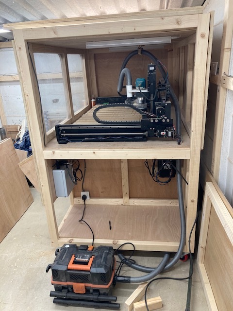

I’ve been tackling this on my own enclosure recently - there is the main compartment for the CNC, and then a separate compartment below for the vaccum and control unit.
I have put removable panels around all of this (with a bit of insulation inside) to make it both air tight and to greatly reduce the noise of the spindle and vaccum.
I found temperature is a significant problem in the vaccum cupboard - the air temperature will heat up above 60 degrees celcsius and continue climbing. Not good! I had to do two things to fix this:

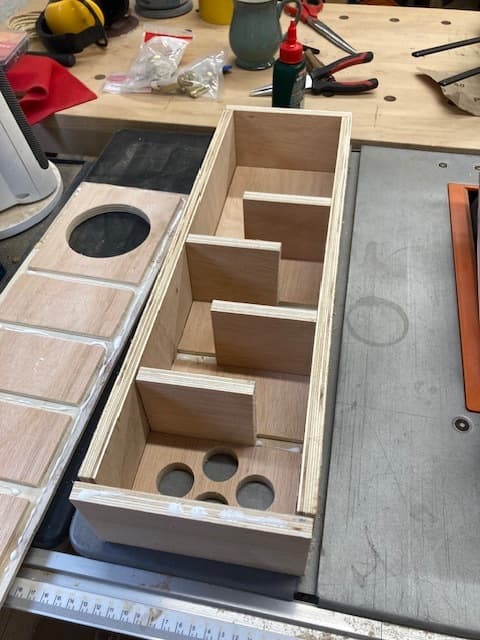

  1. Extractor fans - I have two extractor fans inside the vacuum cupboard that pull air from inside the cupboard and push it out through some baffle boxes to dampen the noise (pictured below mid-assembly). They act as induced draft fans (rather than forced draft fans) and generate airflow through the whole enclosure (as there are some holes to allow air from the main CNC area into the vaccum cupboard).
  2. Vent the vaccum exhaust directly out the machine, do not have it blow into the ambient air within the vaccum cupboard. Luckily, my vaccum has an exhaust port so I route that air directly out the machine (via a third baffle box).
I have found this setup to give me stable temperatures over long hours of machining (maxing out at 40 degrees celcius). It also keeps things deliciously quiet which I really like.

Hi, does anyone have a pic of such an intake baffle? I can’t find anything online. Pierre
@robinhartleywillows posted one above, just no carpet.
Ah, I didn’t realize that was the baffle. Thx!
