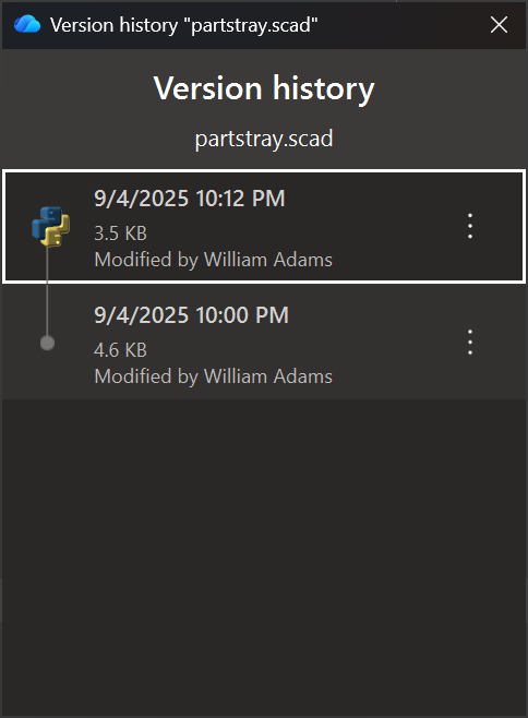

Please use the OneDrive “Version History” right-click contextual menu":
to retrieve all the versions of a file which has such problems and see if you can determine when/how the problem arose.

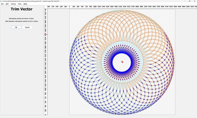

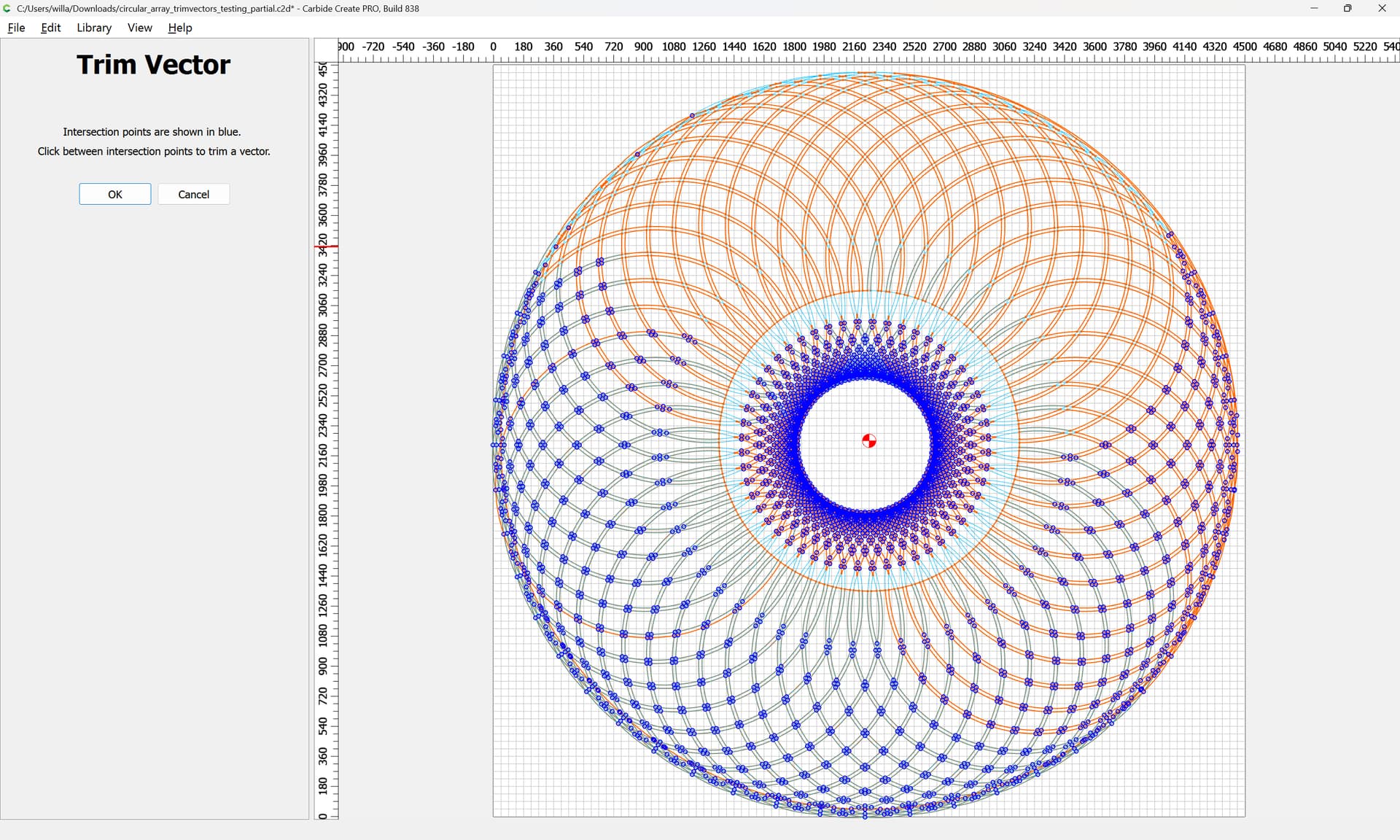

I leave files open for days-on-end, esp. when testing things such as:
(trying to work through manually using Trim Vectors so as to arrive at a file which should be a thorough workout for the “Join Vectors” command)
