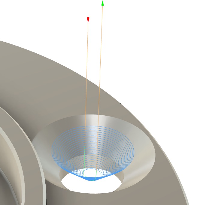

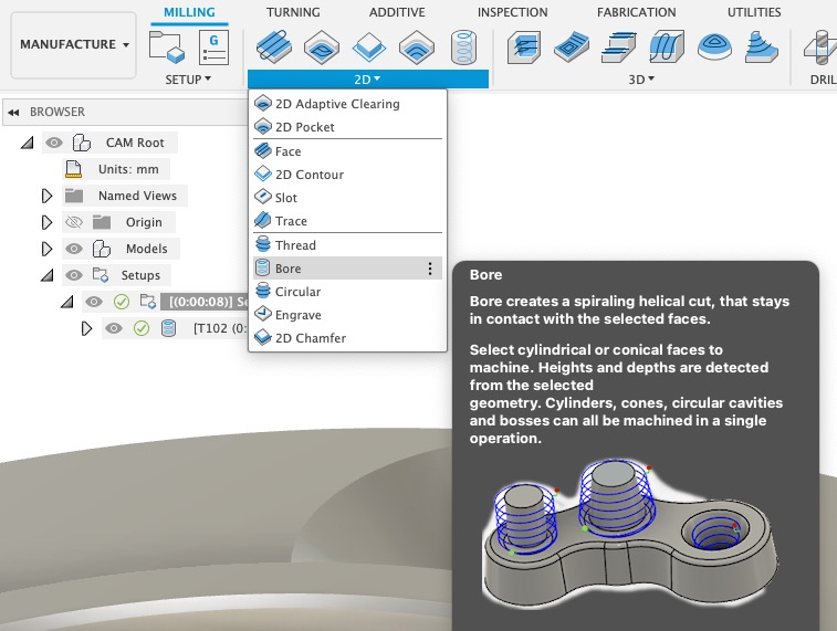

Or, use the “bore” toolpath, and select the tapered face of your countersink. Use a ball endmill, or heck, even a regular flat endmill to spiral down the face with a small pitch, and it’ll be nearly as good, and save you from needing a specialized endmill.

I thought about the ball operation, but the biggest issue is that I don’t have a ball endmill small enough for the hole (~2.25mm). The stock is only a little over 1.5 mm thick though, so I was thinking of doing the drilling op with pecking but still unsure if that would be very stressful on a standard countersink bit with a quarter inch shank.

This is the toolpath I was referring to in the second part. It makes an endmill spiral down the face of any cylindrical or conical feature. Even if you don’t have a ball endmill, using a flat endmill will still get you a pretty good taper. If your spiral is very shallow, the steps between each pass will be nearly imperceptible.
