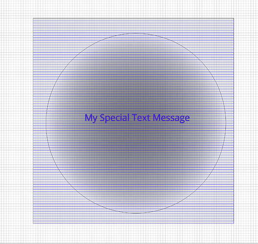

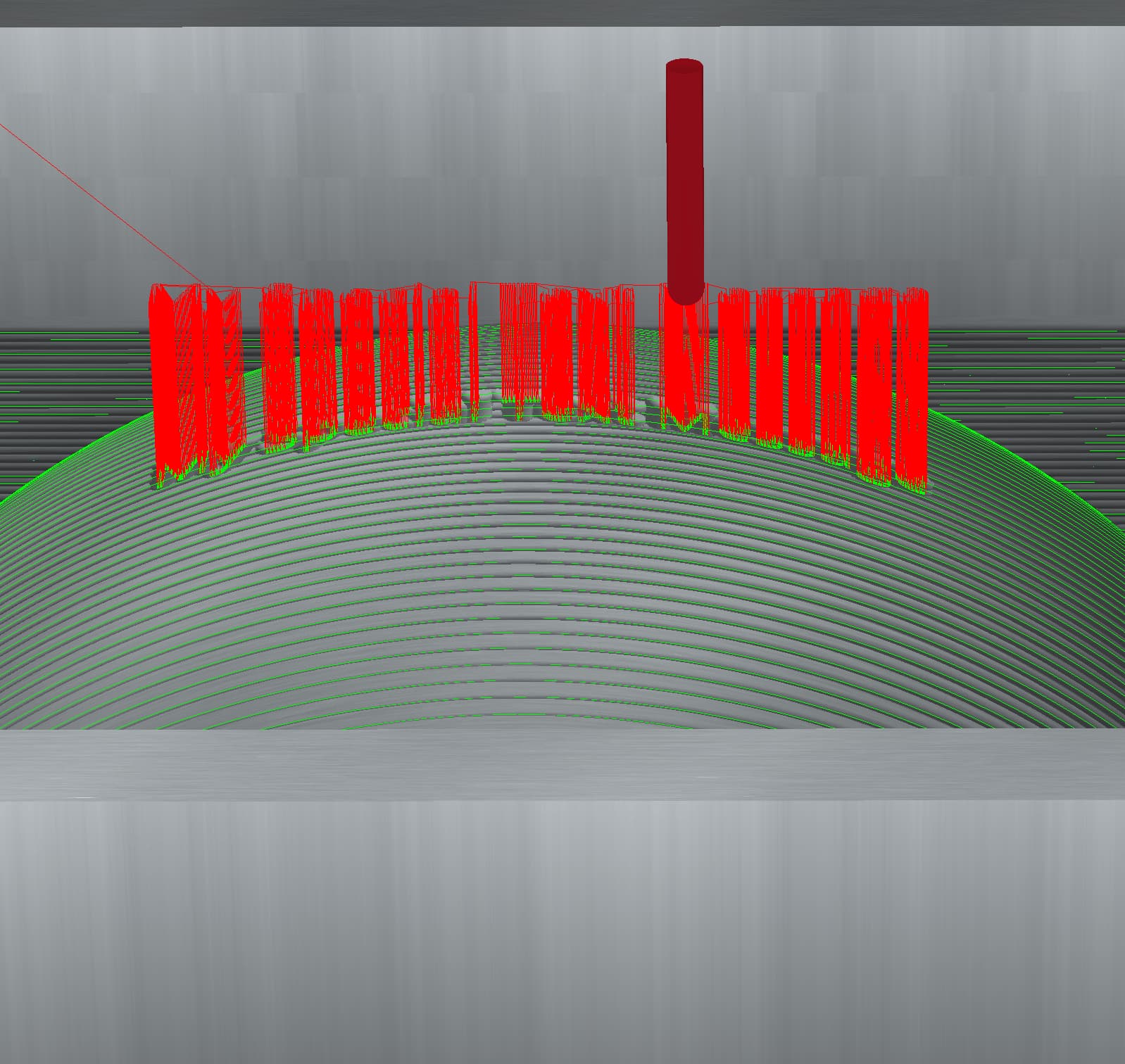

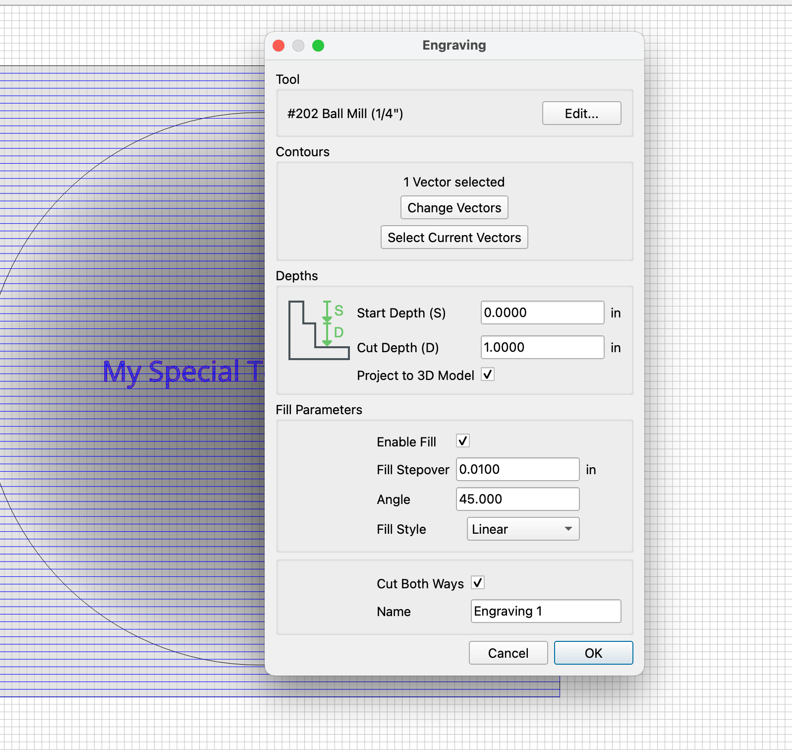

I’m trying to understand how this new capability works so I went through and did some testing at different settings to try to get my head around things.

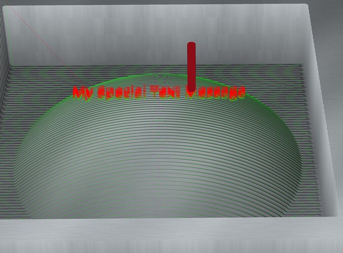

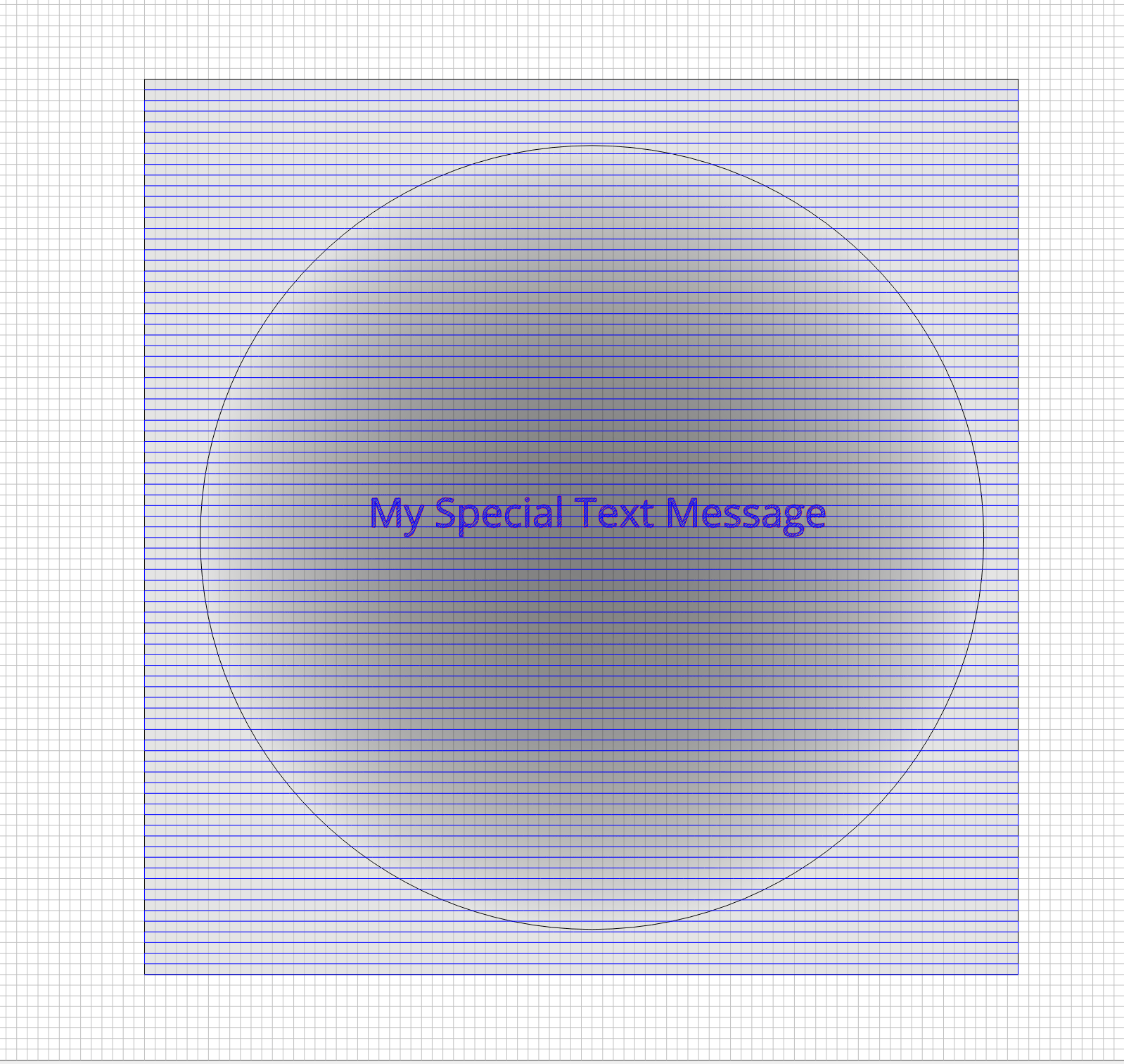

So i have just a dome shape modeled with some text above it.
There’s a 3d tool path over the dome then the engrave tool path for the text.

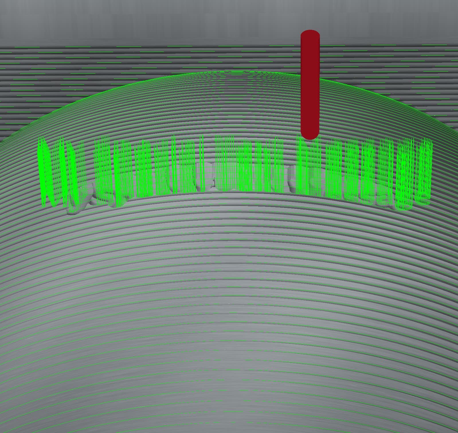

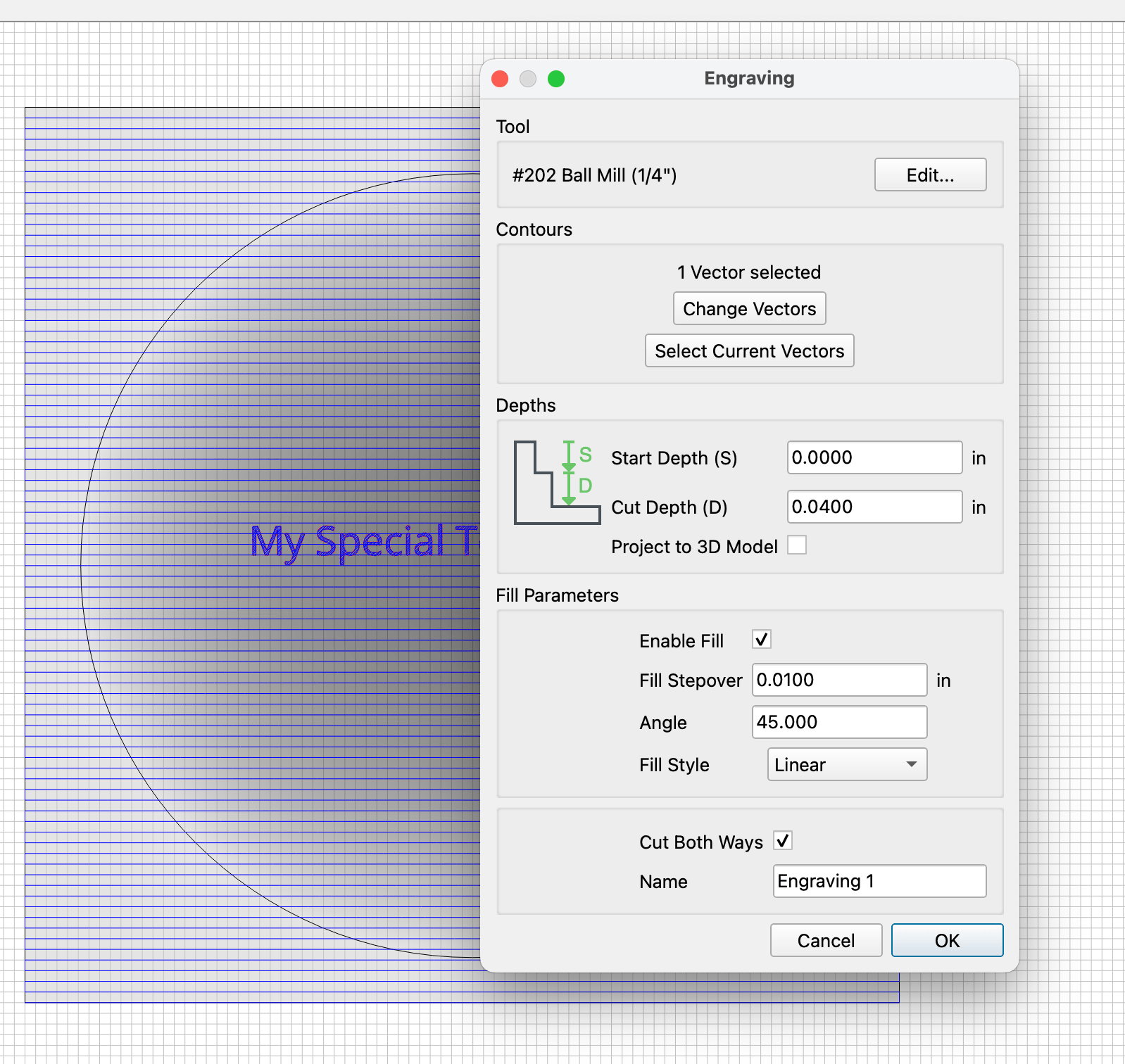

The first thing was to leave everything default and see what happens
As expected, the engrave is just hovering above the model since it’s a 2d path above a 3d model.

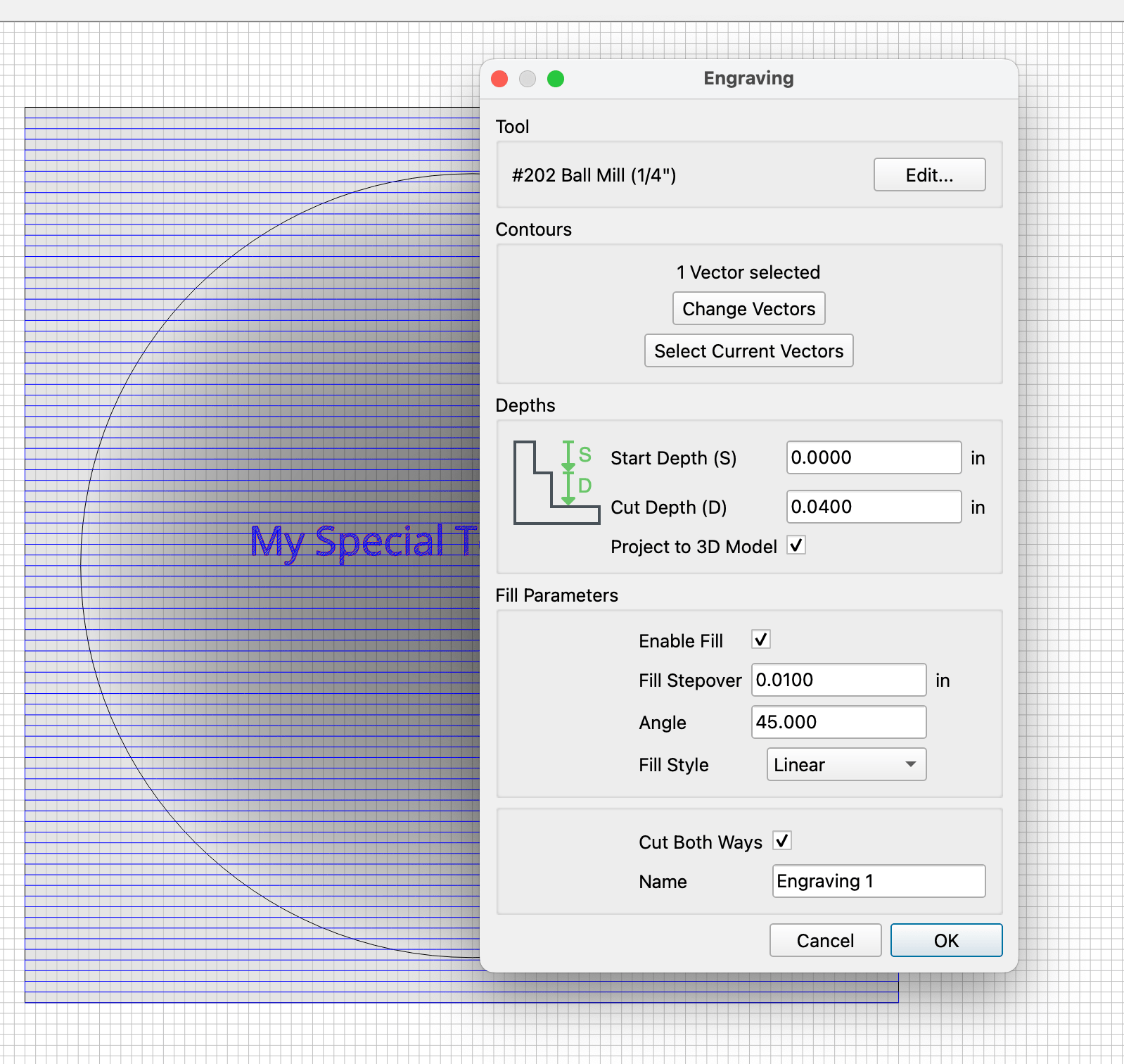

So next I enable the new 3d projection checkbox. My expectation would be that the text should now be projected onto the dome since the “start depth” I would assume to mean how far in from the top of the 3d model to start
But nothing appears to be any different, the text is still floating up in space at the top of the material.

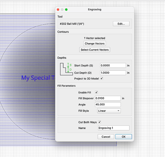

I try changing the cut depth to be 1" to make sure the cutter gets low enough to cut into the dome
But the text just cuts into the dome as if it was a 2d path that cuts deeper

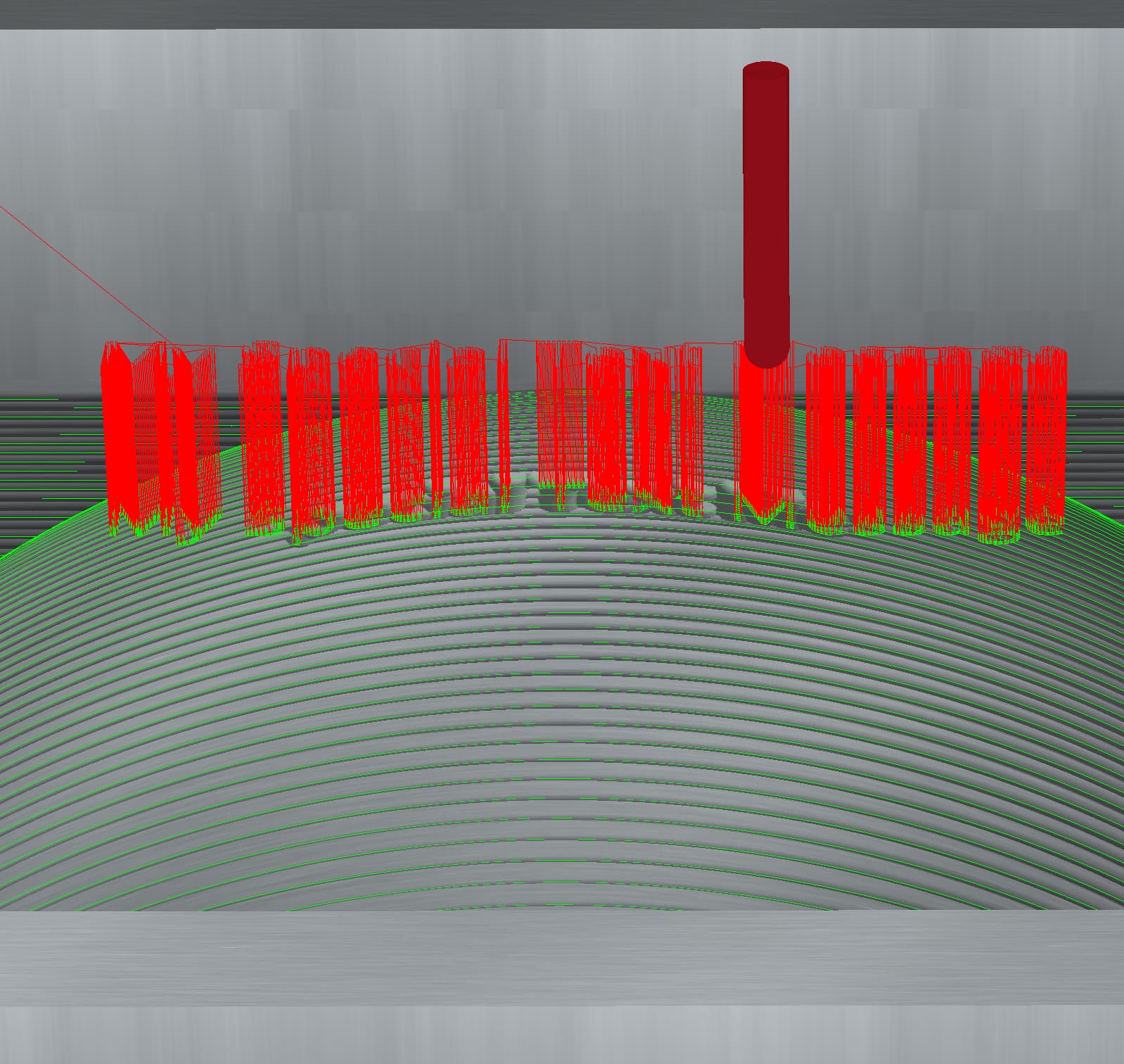

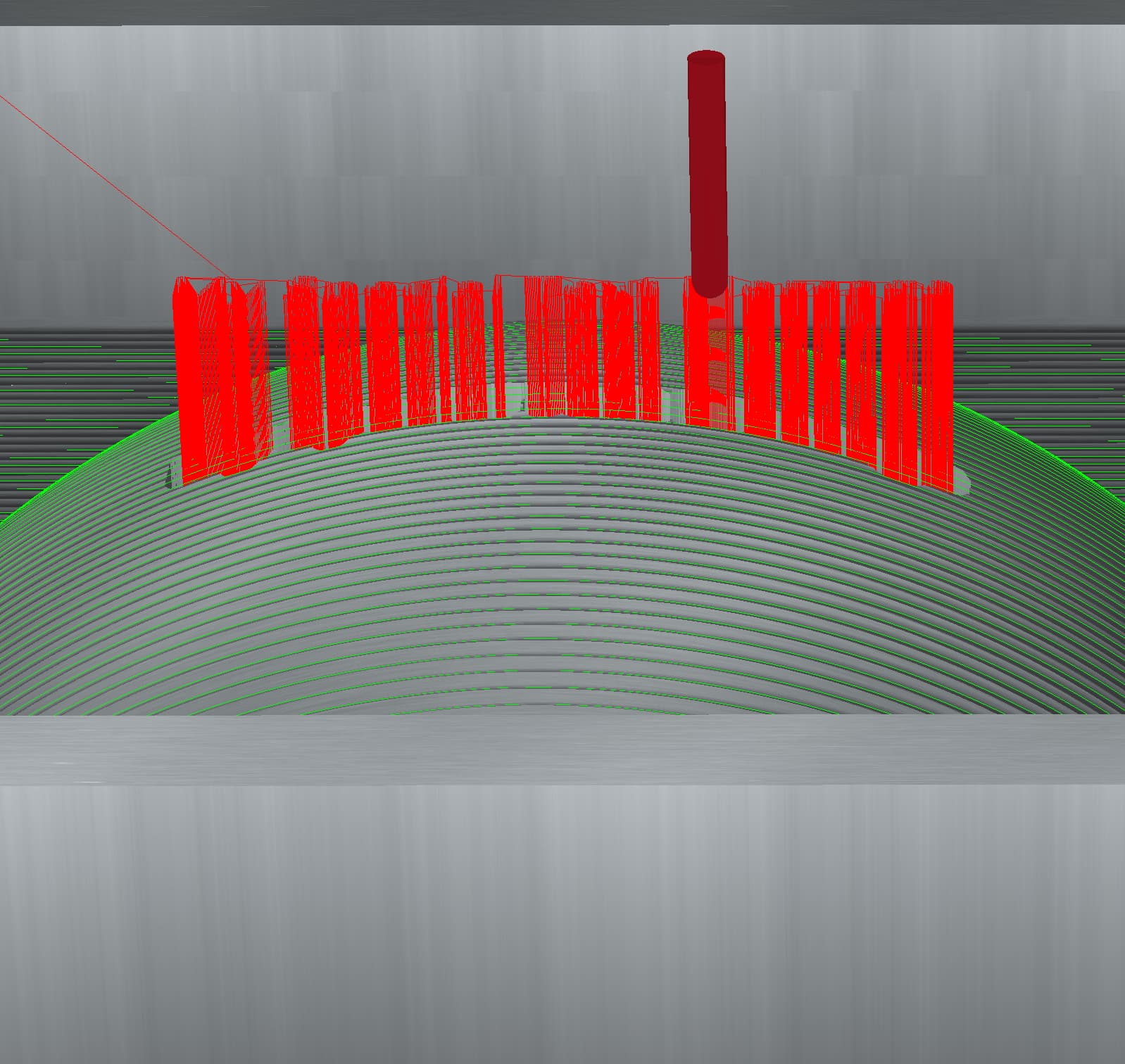

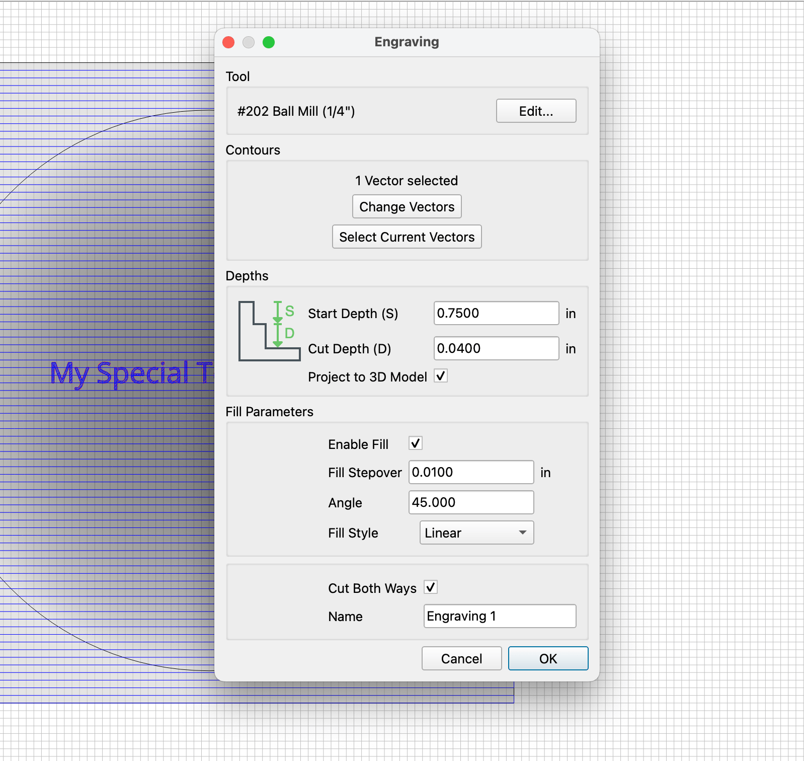

So now I try changing the start depth to 3/4" without the checkbox and see what happens
And as expected, the text just blindly cuts through the model

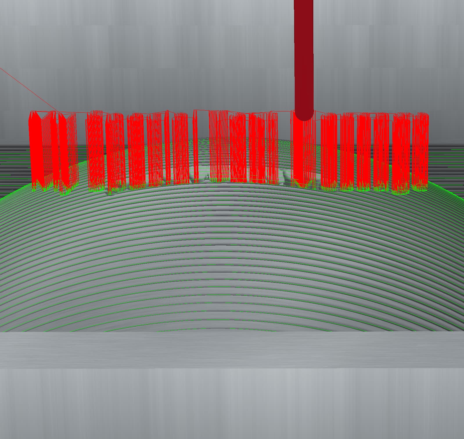

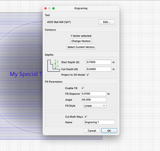

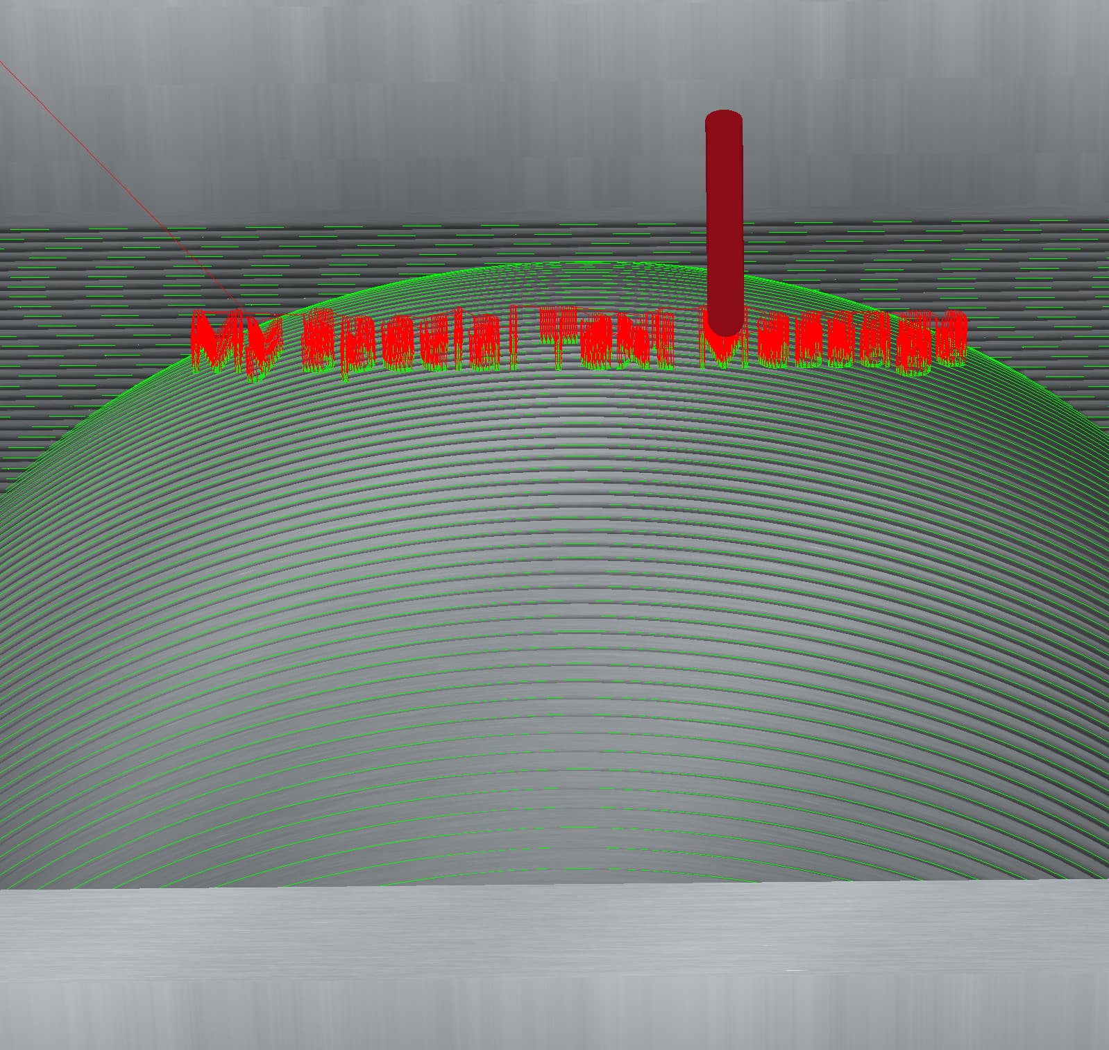

Now I re-enable the checkbox still at 0.75" start depth

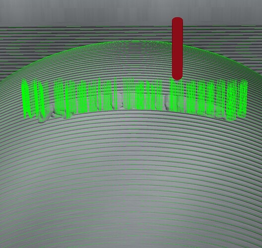

And I can see something happening now. The text that overlaps with the model doesn’t just cut through the model, it now follows the curve as I would expect. However, the part that still is floating out in space doesn’t follow the curve, only the part that cuts in does.

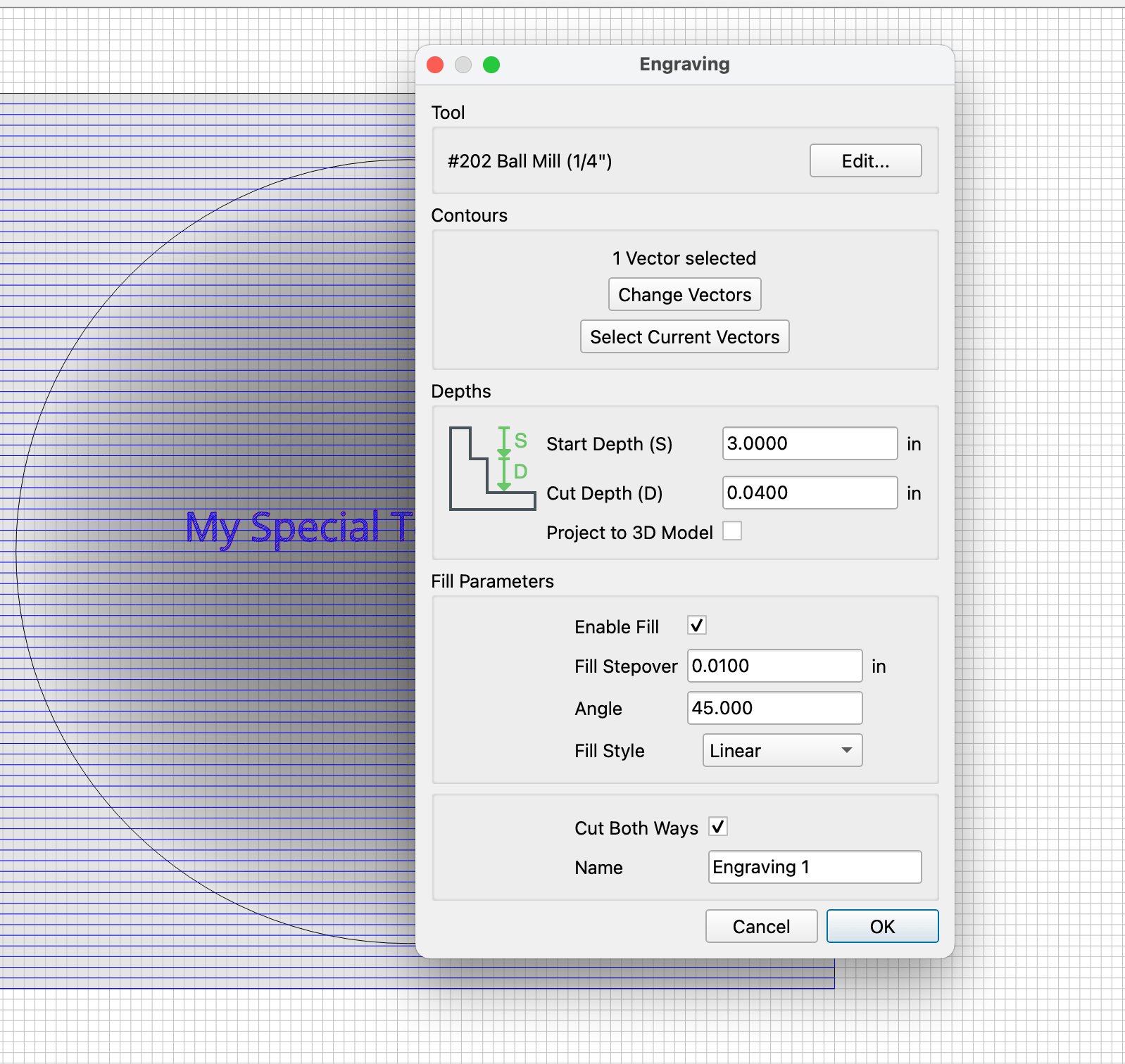

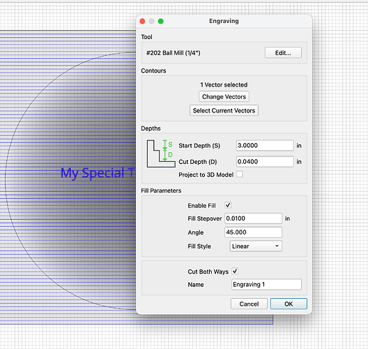

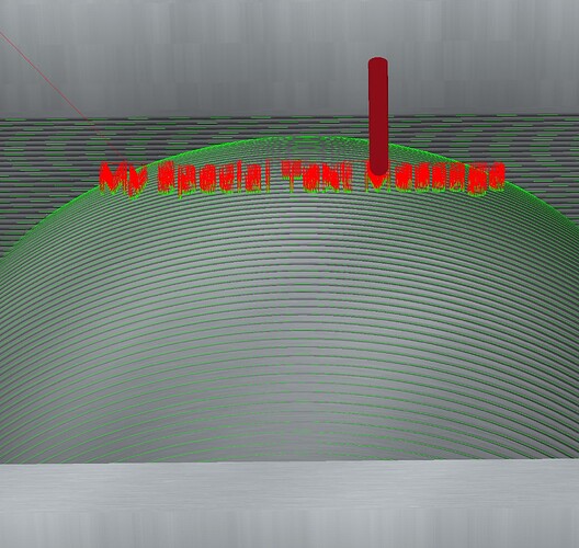

So now I set the start depth to “t” for the material thickness, unclick the checkbox, and the text cuts through the model completely as I would expect for a 2d path
Then when I go back to check the 3d projection checkbox I notice that the depth has changed from “t” to the actual thickness of the material of “3.0000”, which I assume is a bug
But with the checkbox checked, the text projects onto the dome the way I expected it to be with the start depth at 0. The text fully covers the dome and is inset only the amount it’s set to go based on the cut depth.
So regarding the “Start depth” question, it would probably be better to omit that checkbox when the “project to 3d” checkbox is checked assuming that the behavior is what we are observing currently when we set the “start depth” to the thickness of the material.

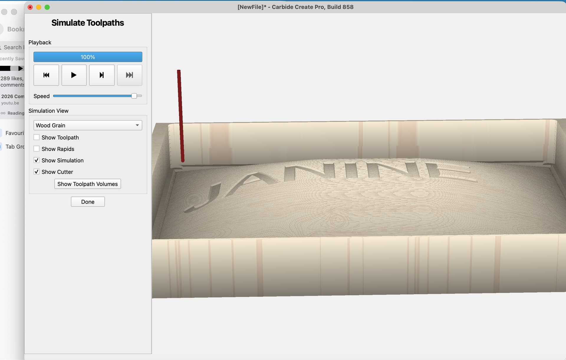

Rob that is the issue I am experiencing Will has had me reset my mind set so I am going to follow word for word what you have done and lets see how I go.
Rob,got it thanks so much.

Just done a projection trial on a few domes and works brilliantly,thanks Rob

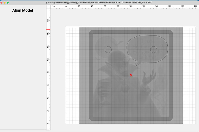

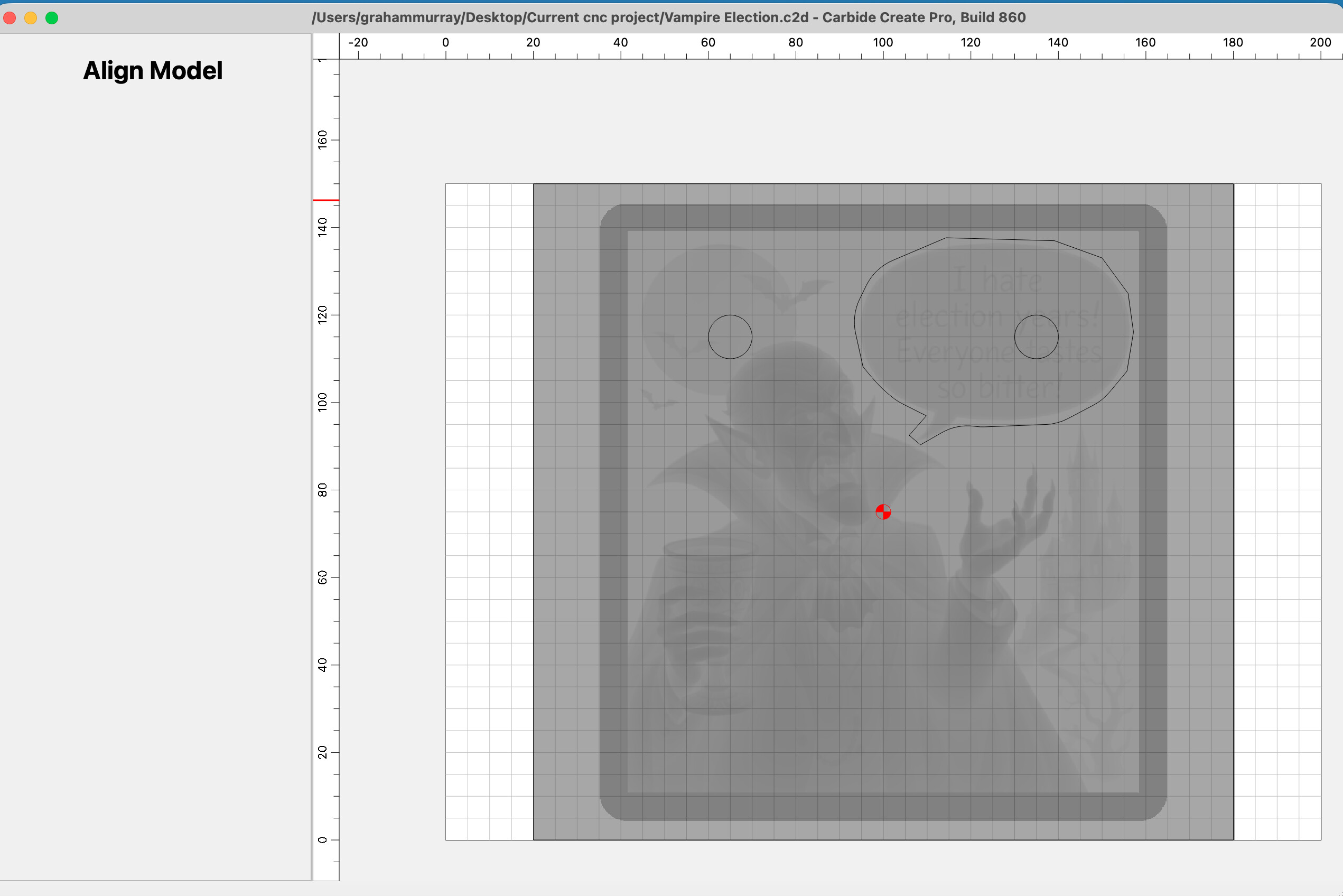

I’ve got no idea how to make the “align model” command work. Can someone tell me what it’s supposed to do and how? When I invoke it, if I move an object, the Model dialog disappears. I’m probably not using it right
Same here, just pressed the align icon and all I got was this.Can not get out of the screen
CTRL-Z will eventually get you out, if ESC doesn’t
