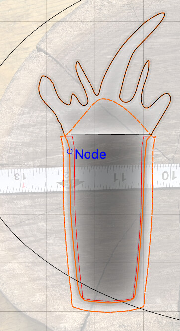

here is a cup outline I’ll pocket and fill with clear epoxy. then cut the drink out and fill with brown epoxy. then use CC Pro to shape the cup onto a round. then slightly round the spilt liquid. It sounds simple, but CC Pro don’t seem to be able to do it.

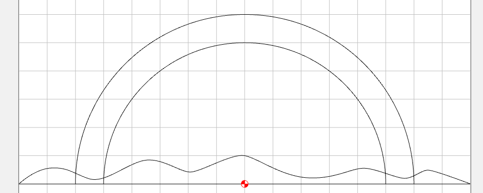

I’m imagining something like this cross section? With the outer part being clear, the inner part and the spilled liquid being brown?

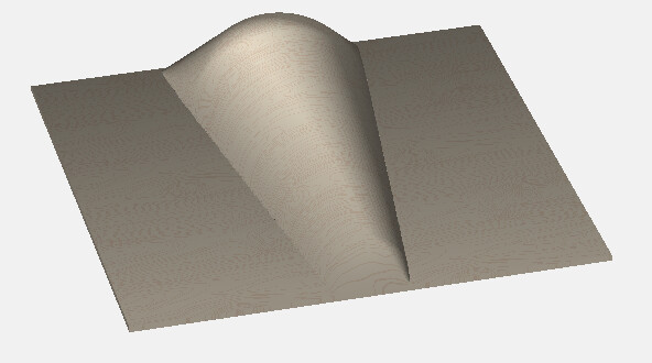

So… I don’t have CCpro but I think you are looking for a two rail sweep…and I think Pro has it. After you cut the pockets you are filling and then should use a two rail sweep (set at different depth/angles/radius) to cut the finished pieces?
this is pretty much what I’m looking for. although the lower larger sweep should follow the lines of the cylinder “cup”. CC pro don’t have anything like that sweep you showed.
That would be ideal. but not really possible in CC pro. it would be a multis step process.

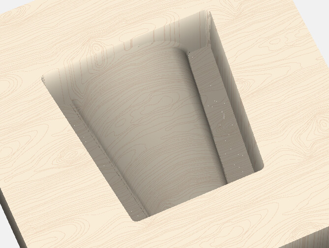

As noted, in Carbide Create Pro, this would be a multiple step thing, probably it would be necessary to selectively enable/disable parts.
If you upload the file you are having difficulty with, we can look into this with you.

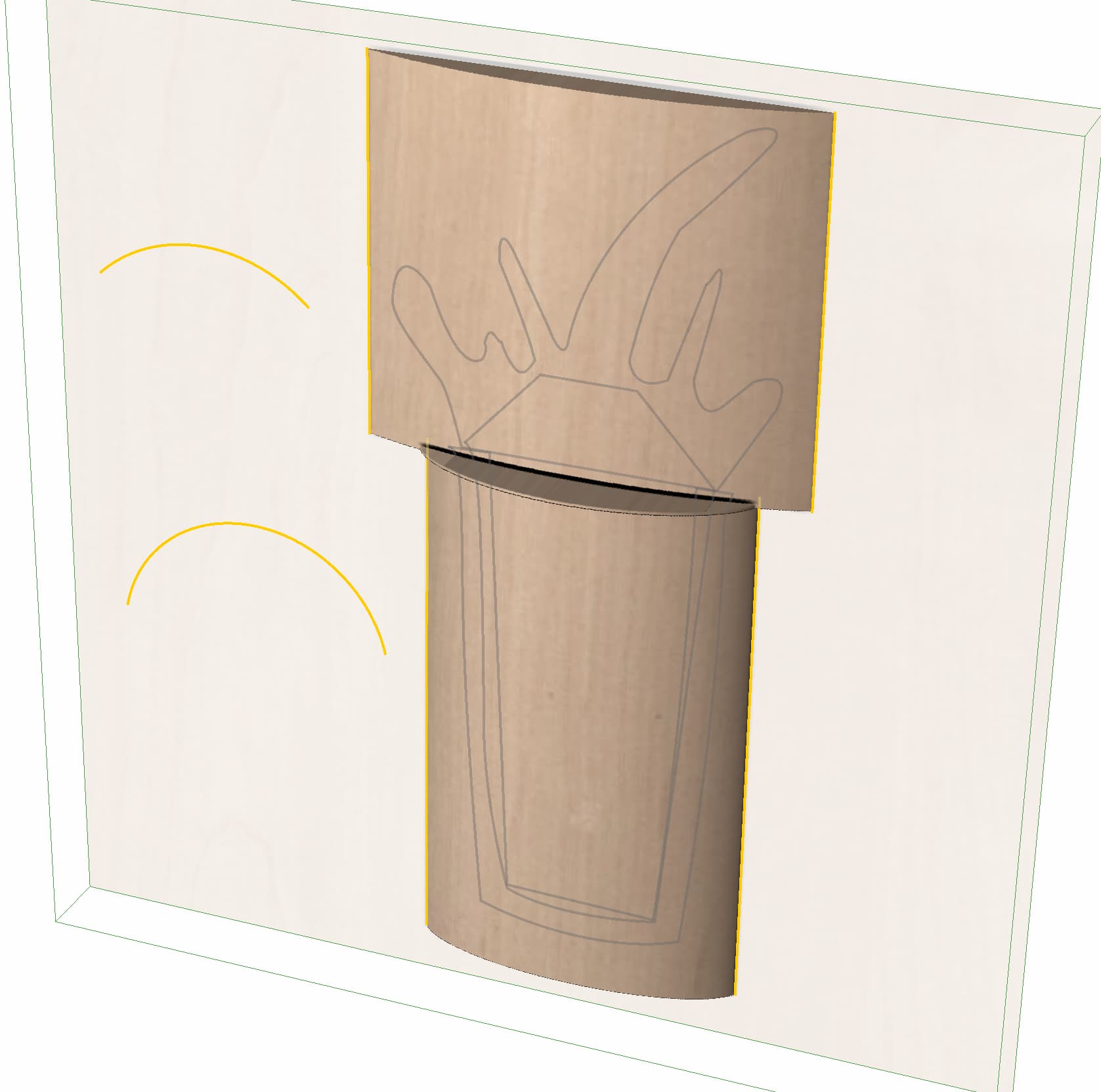

Cut pocket for brown & pour.
Cut pocket for clear and rough & finish the brown.
Pour the clear.
Remove the outside wood down to the level of the spill.
Rough & finish the clear.
Pour the spill
Rough & finish the spill along with the remaining outside stock.
So the brown model is built oversize, but the cut is limited by a boundary.

yep I figured it out thanks. my head was thinking the shape in the model and the shape on the tool path needs to be the same. I realized I just need to make the model larger and just cut out what is need in the tool path.
