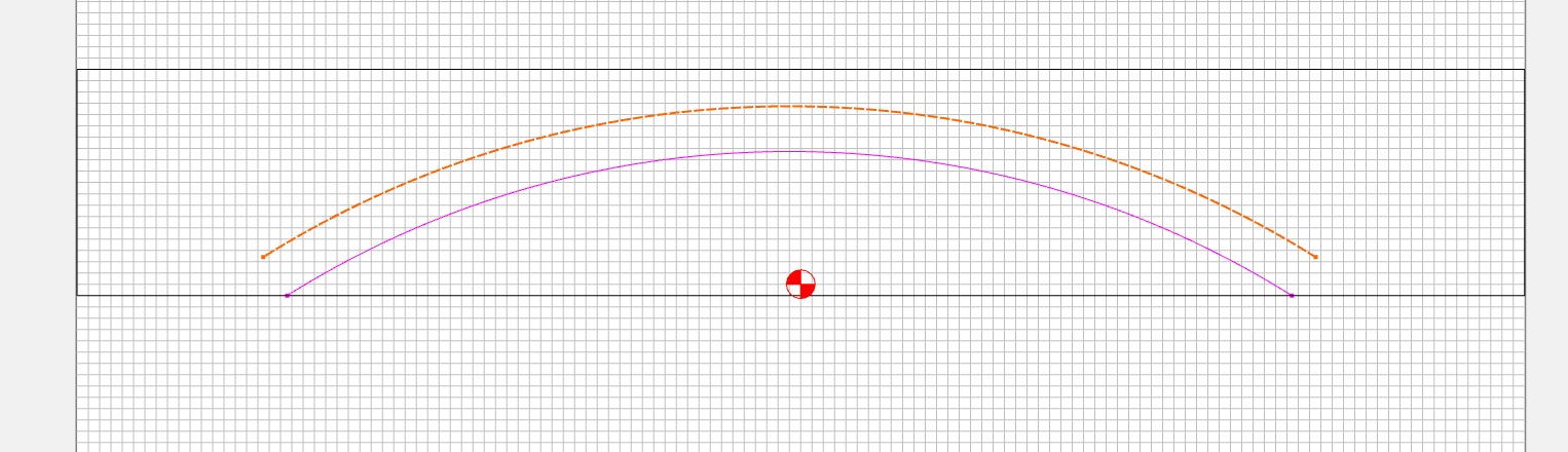

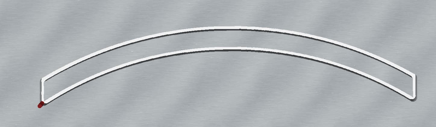

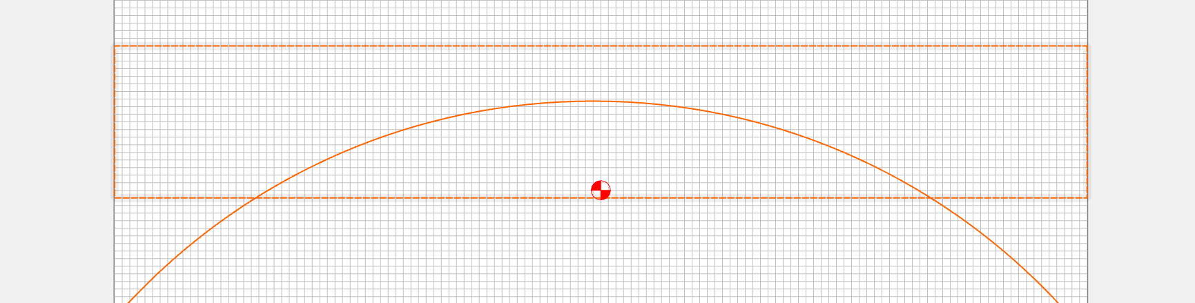

If you overlay the circular arcs you’ll see both curves are not arcs.
Here’s yet another method…

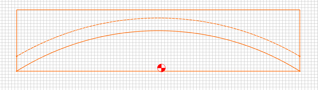

Create the arc as Will suggested, but when you trim the nodes, use an oversized rectangle from the one you eventually want (not trying to get the arc right for this demo):
Now, just select the arc and use the offset tool to make a corresponding arc 1" thick (for me, it was OUTSIDE)

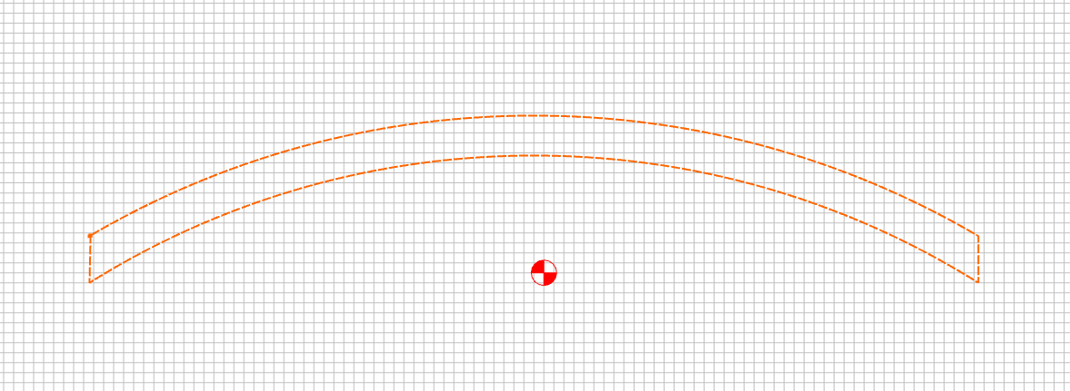

Then draw the rectangle to the size you really wanted, retrim all the ends… Draw the two small lines to connect the ends of the vectors, select the four vectors and join. Done.

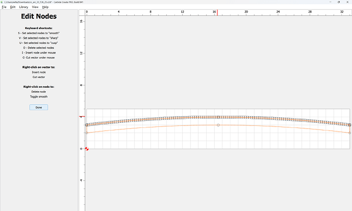

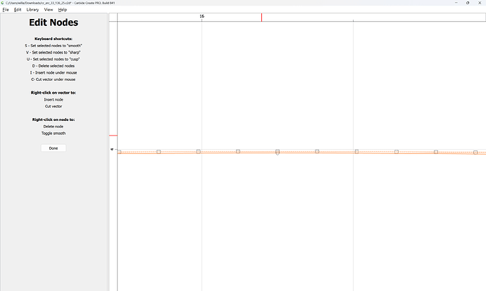

The problem with doing that is that the offset arc is a polyline.
Try Node Editing and/or zooming in.
I’m overly sensitive to this (spoiled by years of drawing w/ compasses and using Adobe Illustrator and Freehand).
The math for this sort of thing is hard and most companies working in this space have a dedicated team of folks handling the geometry/trigonometry/algebra/calculus of the vector (and other math forms) calculations involved in such operations — moreover, there’s a PhD, or possibly a Fields Medal or Turing Award for the first person to come up with (and publish) a general solution for determining the correct curve descriptions of such intersections — while I’d love to cheer (goad?) Rob into achieving that, I also don’t want him to stop running the company or having a life outside work, which is what I suspect this research would require.

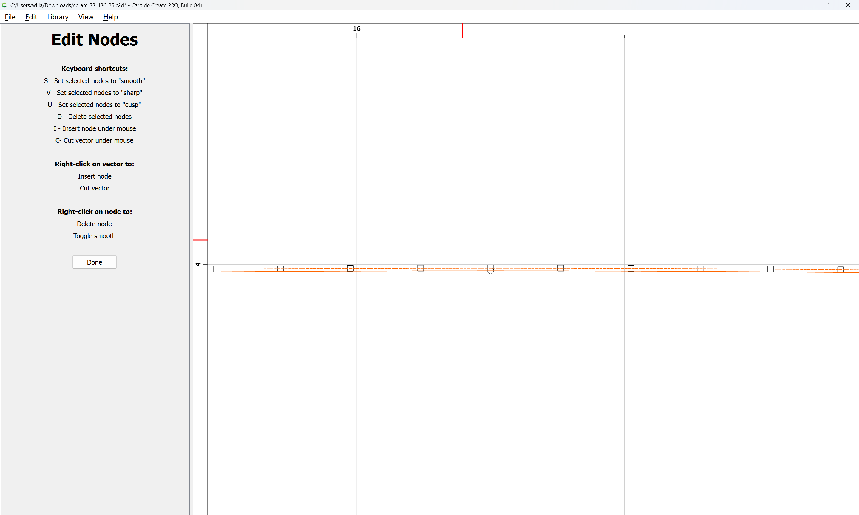

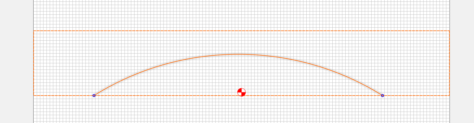

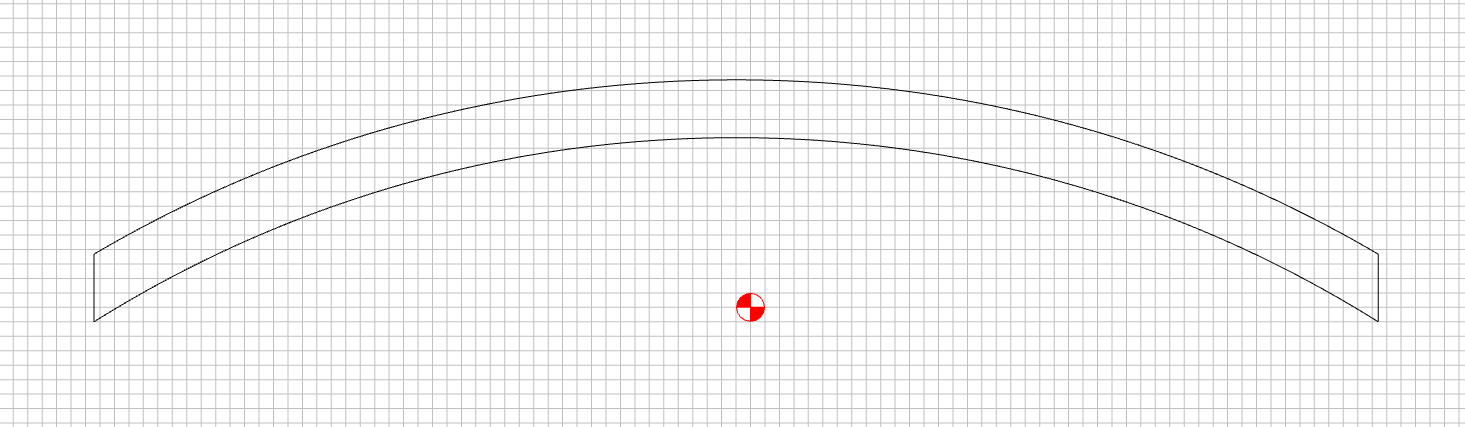

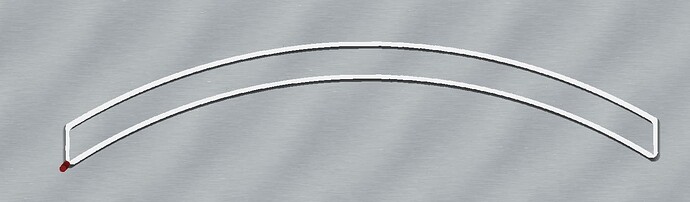

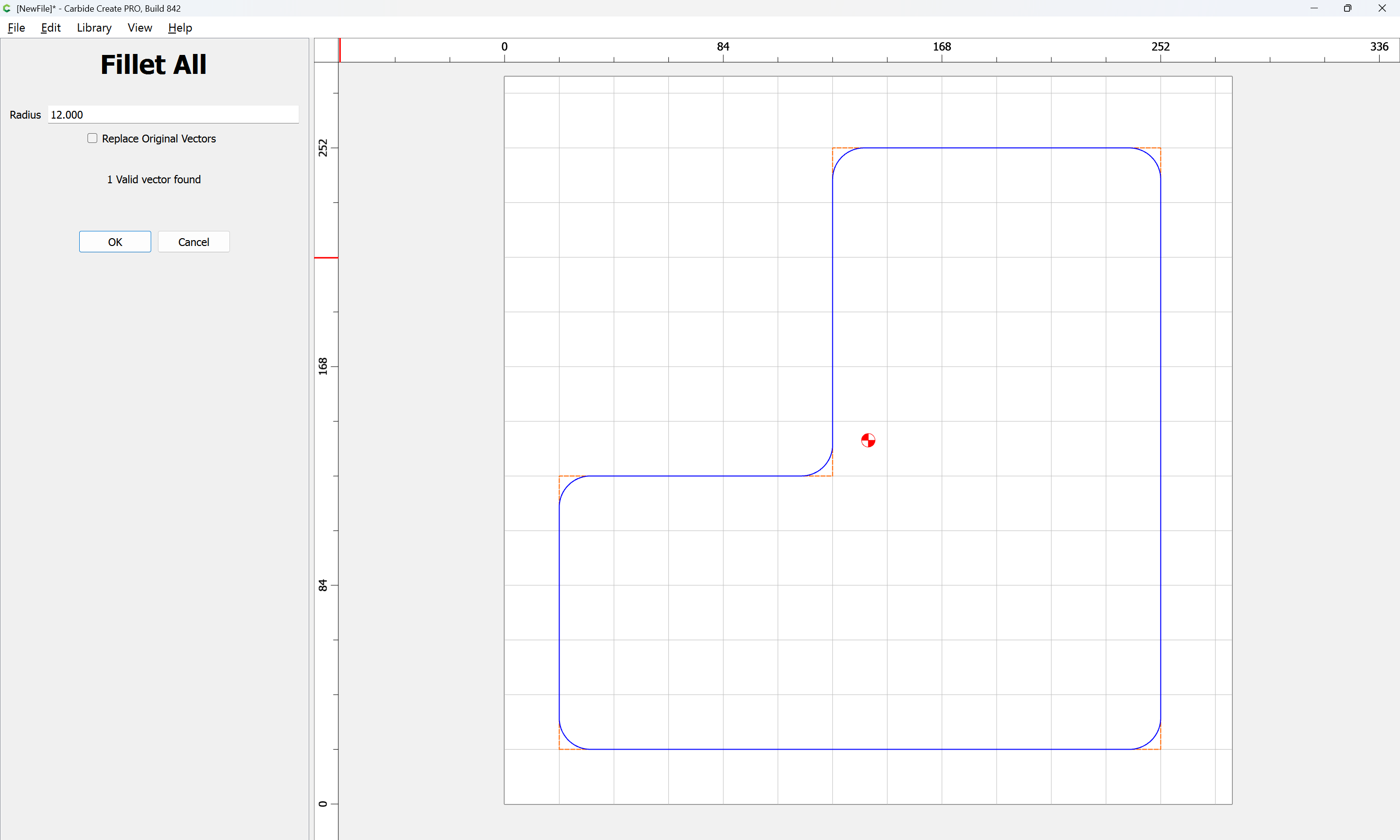

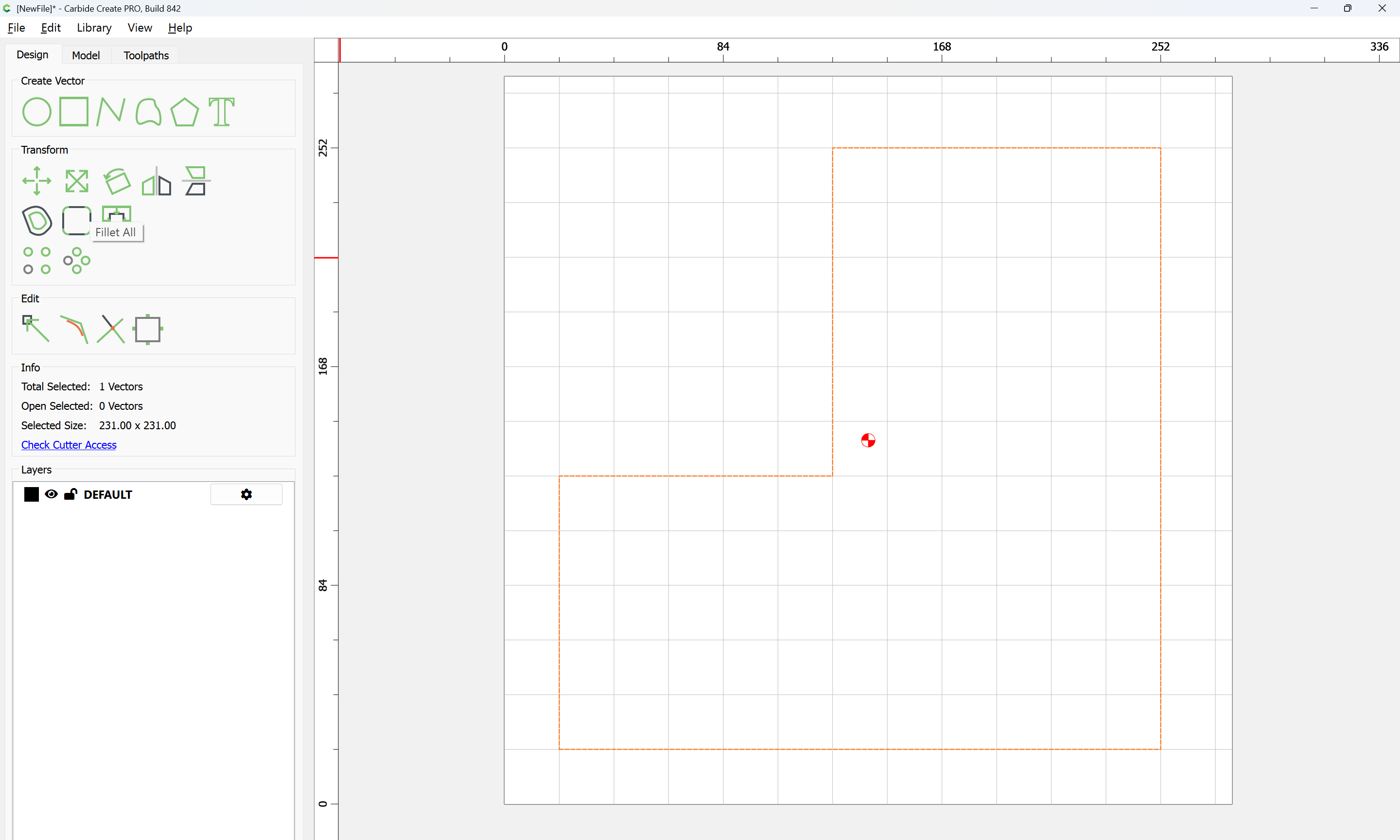

I’m not sure what you’re saying the issue is… I redrew the lines more carefully ( I was sloppy before)…and got this one:
I see no issue…and I didn’t have to calculate the 1" arcs / radii.

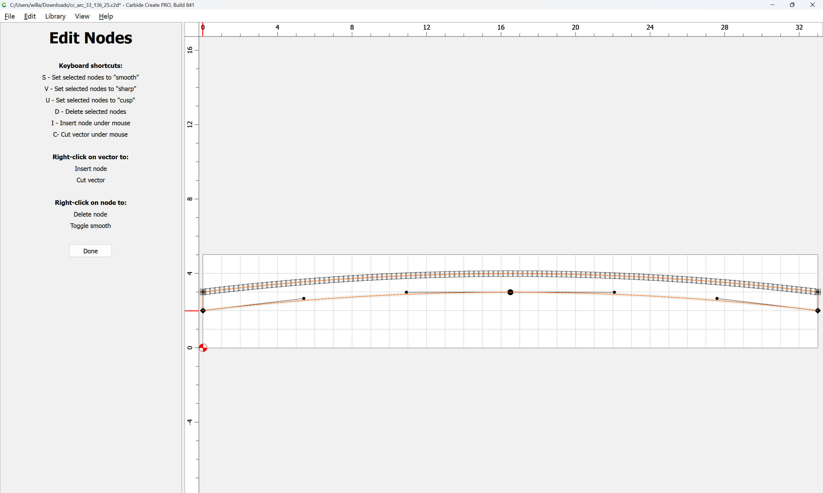

Top shows a polyline, bottom shows a Bézier curve which approximates an arc:
(Note that a Bézier can only approximate an arc/circle)

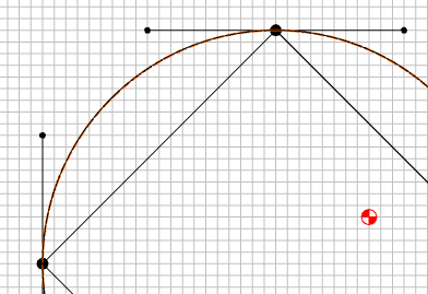

The simplest example I presented before was a square being smoothed into a circle.
If I create a square & smooth it, the simplest, smoothest curve would be a circle.
I’m not privy to the smoothing algorithm being used, but I think I could modify it to get ‘close enough for all practical purposes.’ without diving into all of the complex math behind it.
In the square to circle example, the magnitude of the vector is about 28% of the tangent distance to the next node.
I’m suggesting something like 55% to get it very close to ‘as smooth as it can be’
Indeed! I’m only suggesting we approximate it much closer than we are currently. ![]()

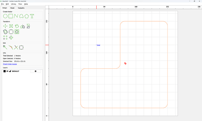

I moved it to the Carbide Create area, since I haven’t seen an explicit feature request, and if one was made, I’m not sure a good case can be made for the difference between a “real arc” and the approximation of a Bézier curve being meaningful to the folks who are the intended users of this program.

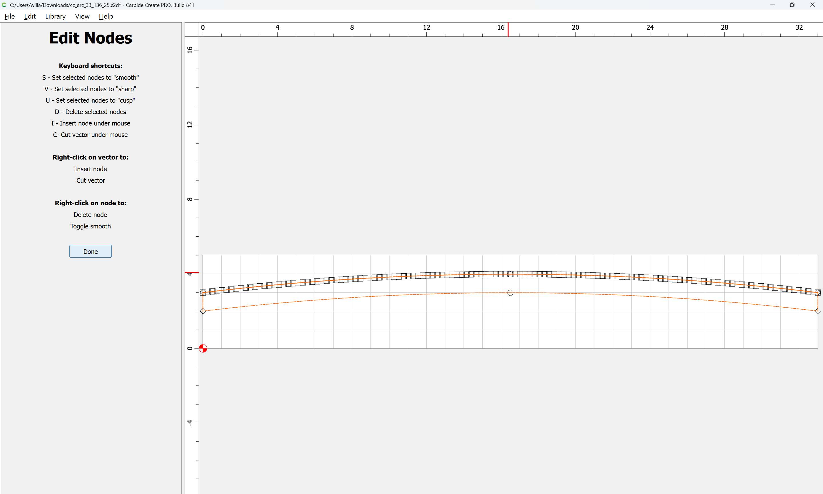

Case in point, curve contrasted with polyline:
Determining how a curve differs from how a polyline would result in machine movement in Grbl is left as an exercise for the reader, but c.f.,

Agree. Arcs are only appropriate in the previous 3 point example, and in the square → circle example as the nodes are equidistant.
A smooth curve through these 3 points is obviously not an arc. But extending the magnitude of the curvature vectors does improve the ‘smoothness’
