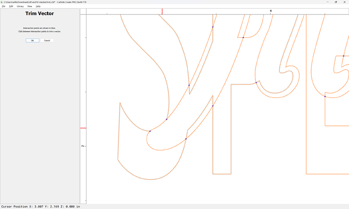

We then hide the top text and select the lower text and the offset geometry for the top text:
and use Trim Vectors to remove what is not wanted:
Note that it may simplify things to re-create the original text design:
until one arrives at:
