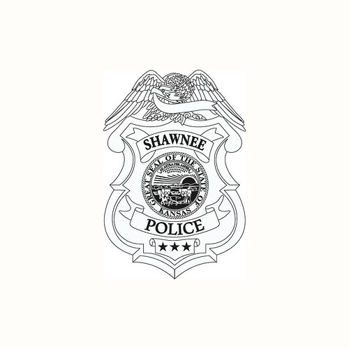

as requested on support…
given a low-resolution pixel image:
but being provided a greyscale SVG:
in order to get a file suited for cutting we launch Carbide Create (we’ll use v8):
Set Background:
importing the image and adjusting as necessary.
Done
Import the greyscale vectors (after converting to SVG if need be):
