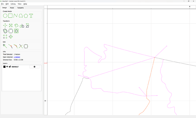

Select the outline:
and copy-paste it:

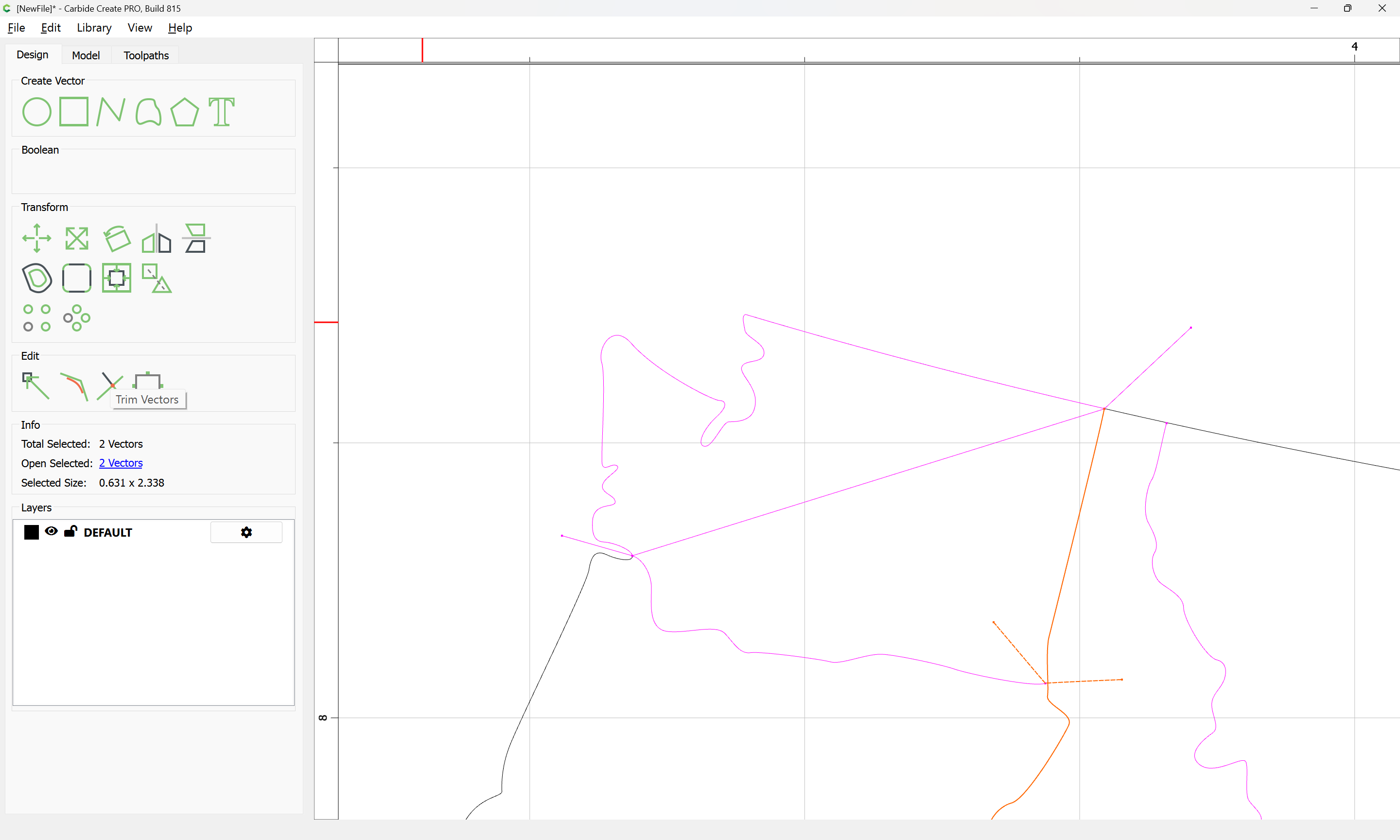

and then add the sectioning geometry to the selection by shift-clicking:
and use Trim Vectors:
to remove what is not wanted:
OK

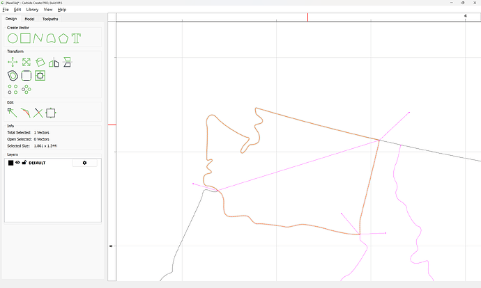

Repeat for each piece of geometry:
Ok
Then select the geometry for the completed state outline (after duplicating any which might be needed for surrounding states)
and use Join Vectors to close:
