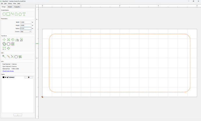

Why don’t you share your file as people here will be able to usually pinpoint pretty quickly what is going on.
I will say everything you are wanting to do is well within the ability of the free version.

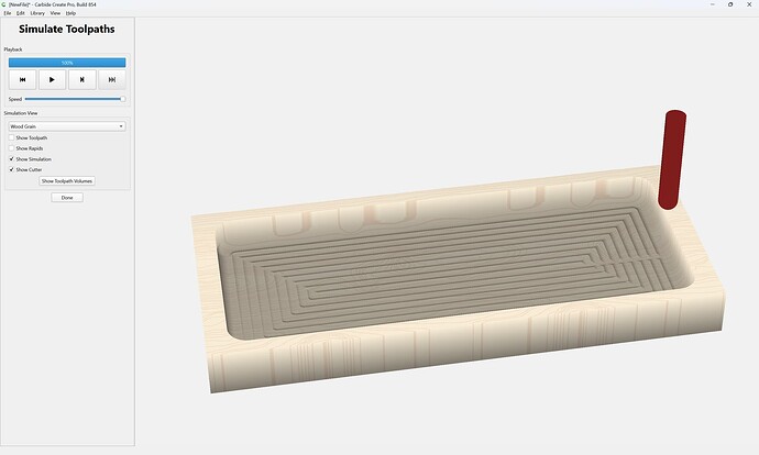

It helps if one draws the tooling which is to be used and the pocket up in profile (and if these two match in terms of radii).

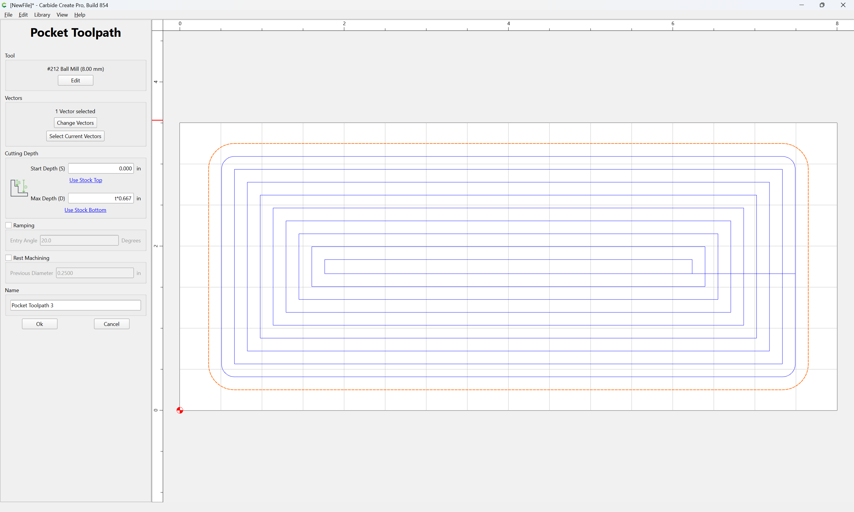

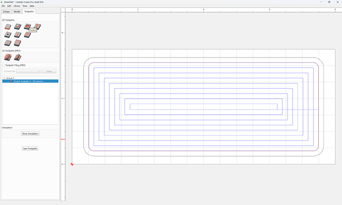

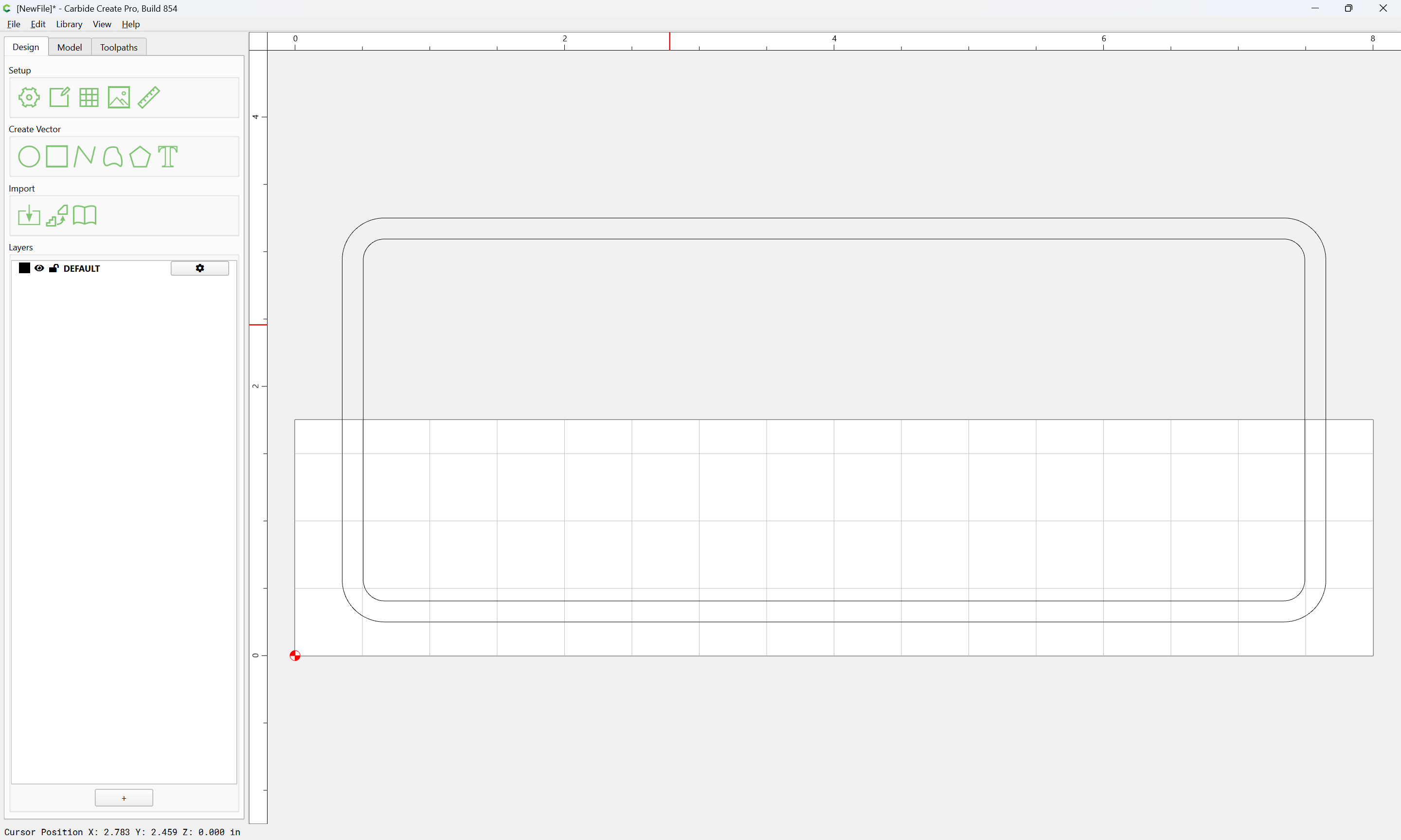

My usual approach is to just cut things out w/ a ball-nose tool:
which will leave a scalloped bottom:

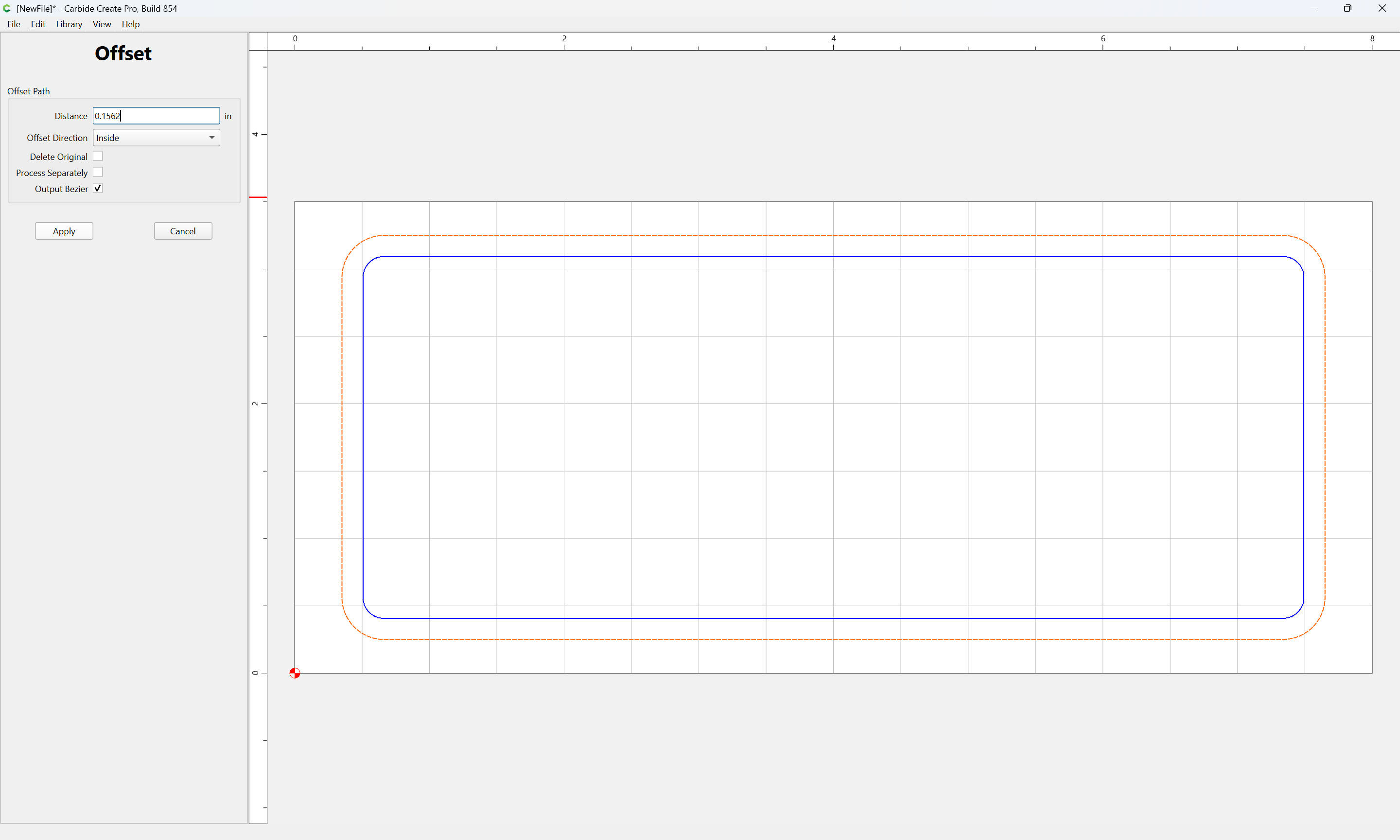

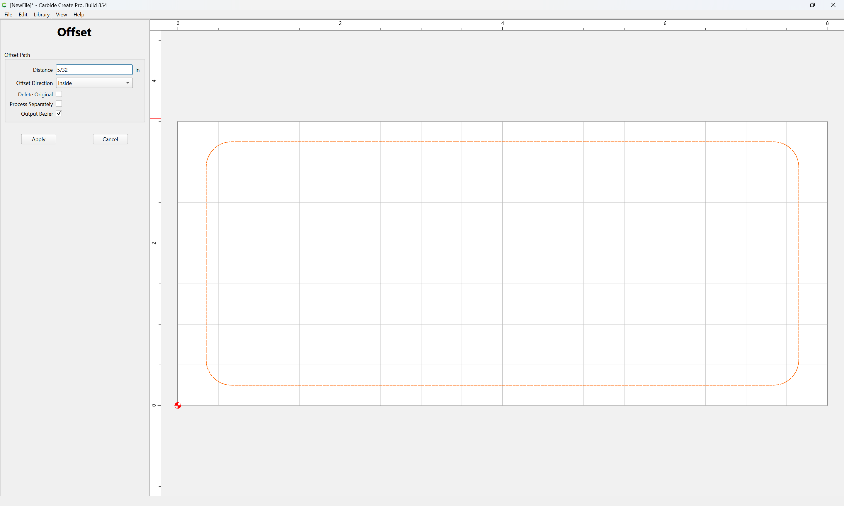

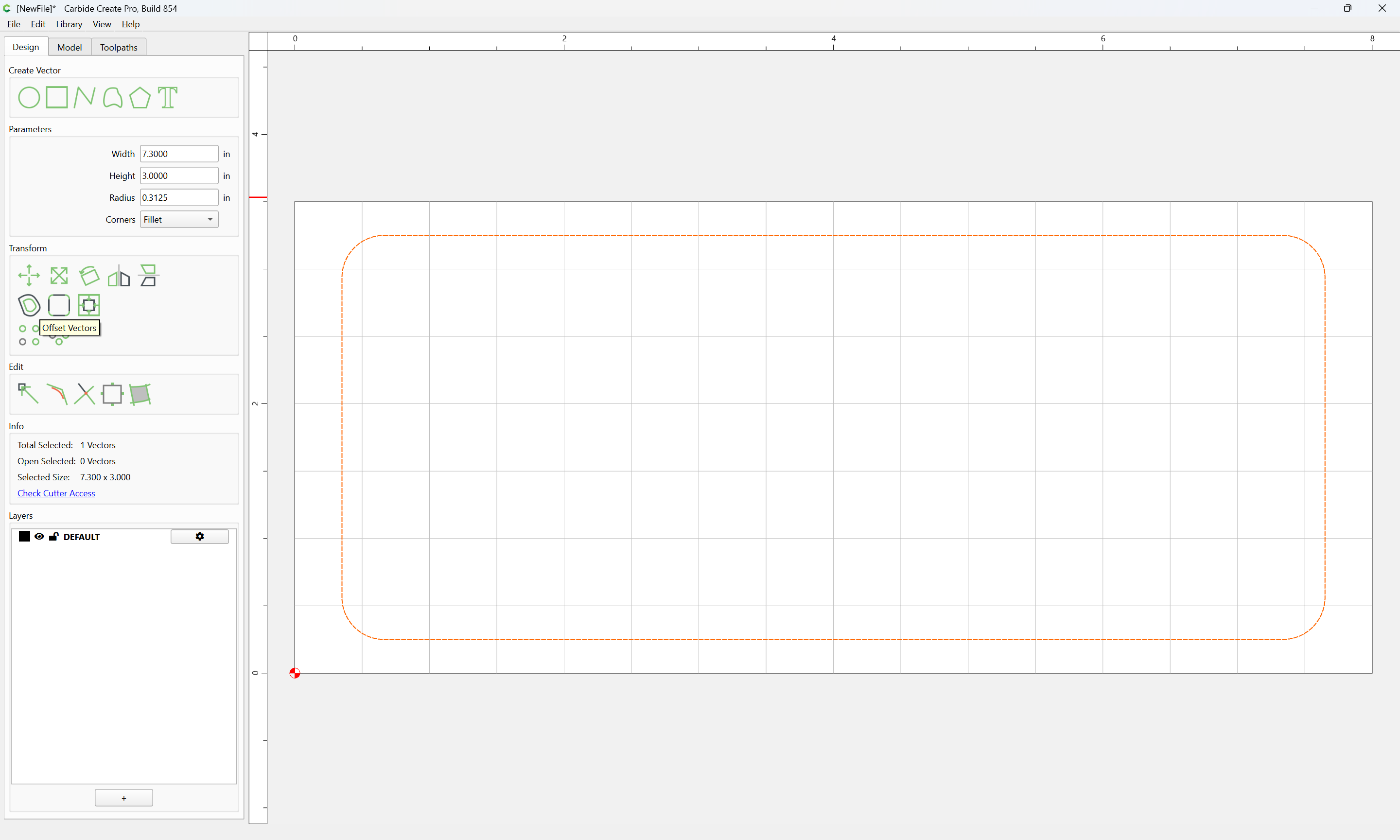

Then inset by the radius of the tool to be used:

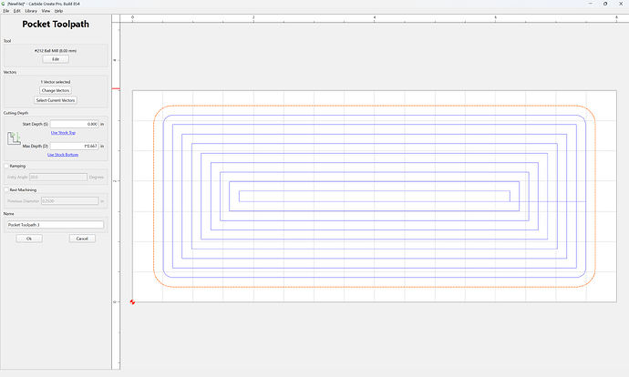

Verify that that lines up w/ the toolpaths:

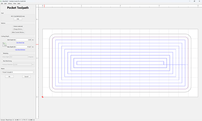

and cut a second pocket:
(and of course, drawing the tool and scallops up in profile so as to determine a suitable start depth)

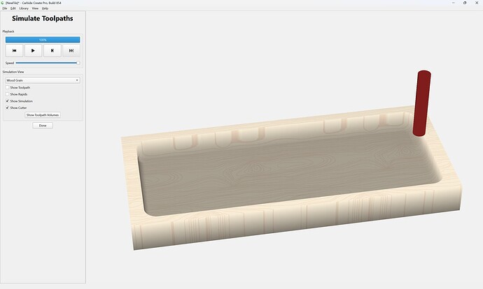

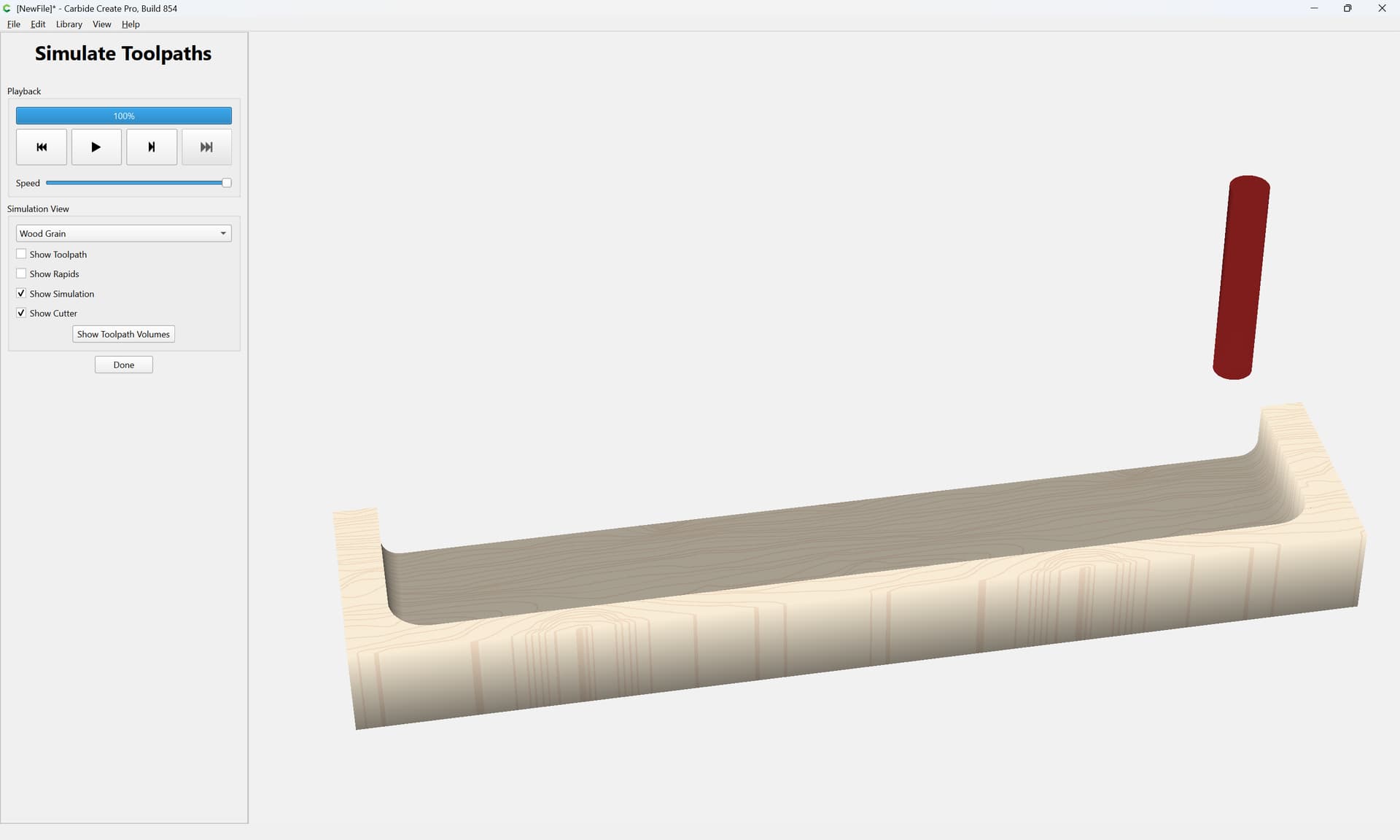

If one shortens the Stock Dimension on one axis:
it is easy to verify the profile of the cut:
Of course, if one had a bowl tool w/ a matching geometry, or if one modified the geometry to match the bowl tool, no second geometry would be needed.
