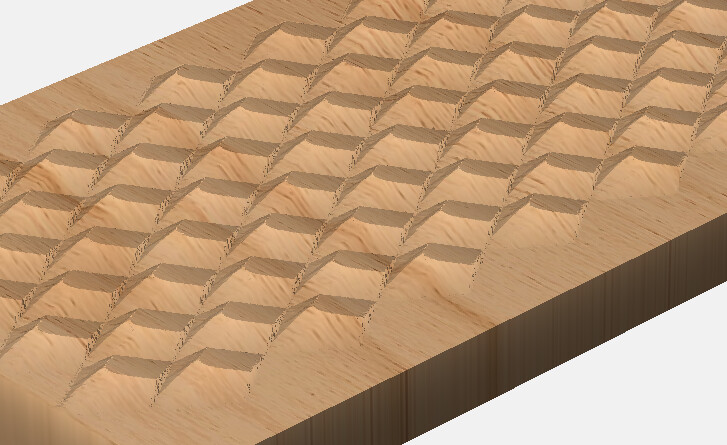

So, I’m getting ready to develop a personal “texture toolpath library” doing both the toolpaths and the samples so I know exactly what I will get when I am looking to create something with texture
I got to thinking… would anyone be interested in joining me in this adventure? I figure if 3-6 of us worked on it, we could come up with a pretty awesome library that people could reference to create the exact texture they are looking for.

CC texture toolpath is somewhat limited in the textures it can create. I think it’s meant to simulate carving out an area with a gouge chisel.
I’ve made other textures using vectors or modeled shapes that could be included, but the library would need to accommodate multiple data types and processes.
Someone had asked me for a dragon scale pattern to apply to a handgun grip. I modeled it in NX & output a STL for them to import…
It could also include ‘tileable’ / tesselations for doing larger areas… ??
