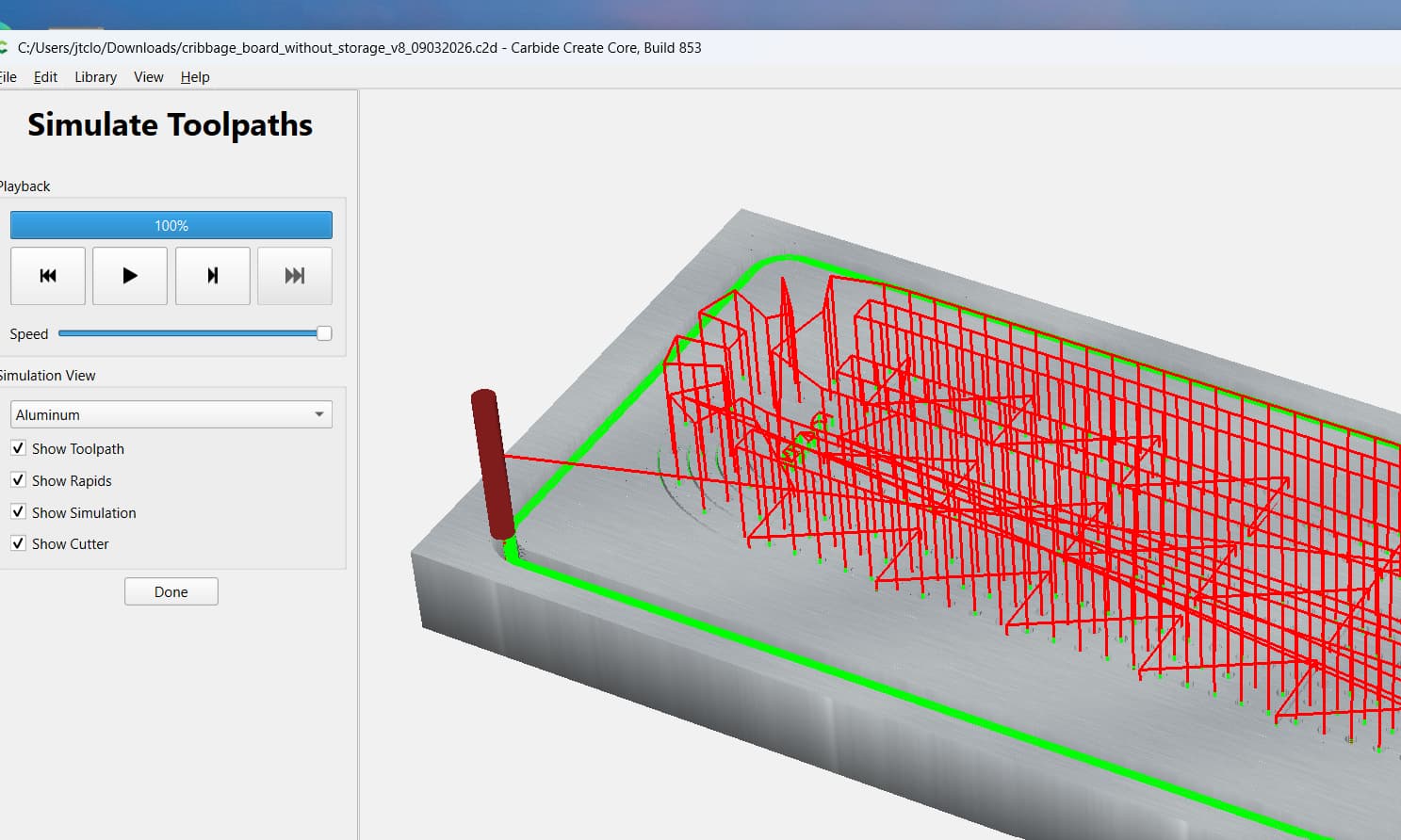

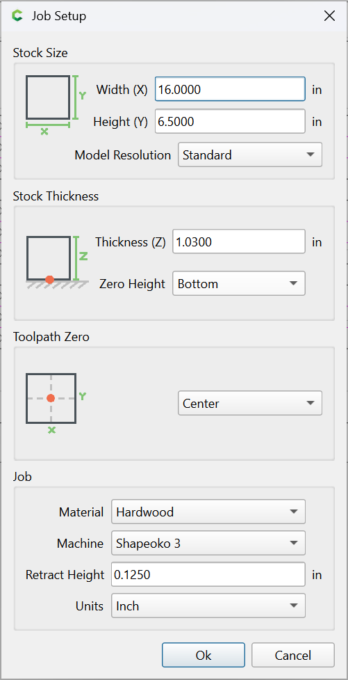

Can someone please look at this file. I have .125" set as the retract height but when drilling the holes the router retracts about 1.5" instead of the .125. I have reset the retract and saved the file but it still retracts very high.

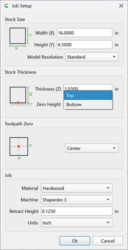

In your file you have z zero set at bottom of stock. Any chance you set on z zero top on top of stock when you set z in CM?
The simulation shows a big retract value. What ever test/fix you find should show there.

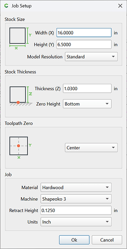

zero is set to bottom of stock:
Change to Top?

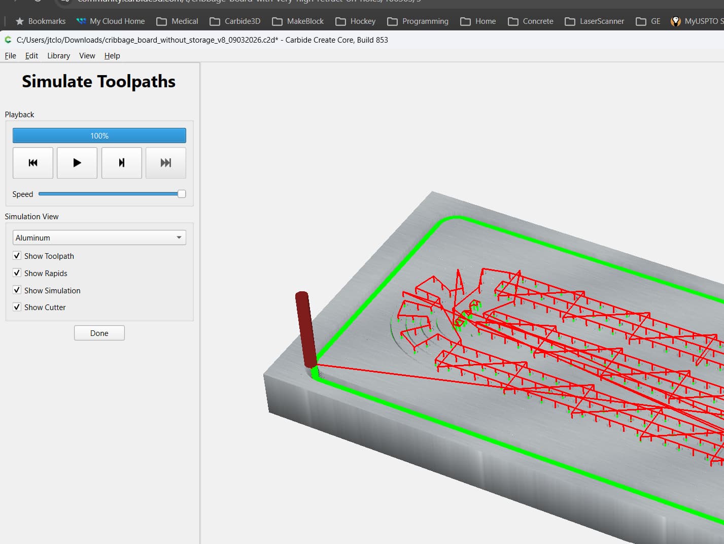

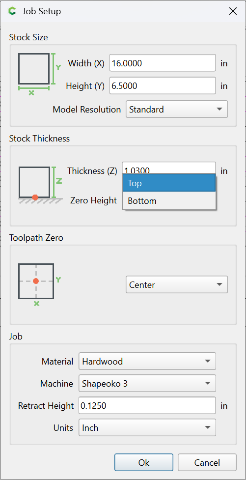

Here is at Bottom
Here is at Top
Retract is relative to where the origin is set.
EDIT: as was pointed out to me in support, retract should be set relative to the surface of the stock so as to ensure consistent/safe behaviour when changing that parameter.
Looking into this now and trying to create a minimal example for a bug report.
The file cut just fine but seems strange that the retract was so high when in setup it was set to .125". The stock thickness was set and I did use bottom of material for Z. That is because I cut out the cribbage board from a bigger piece of stock. Just seemed strange. I almost always use bottom of stock on cut through projects. I will send it to support.

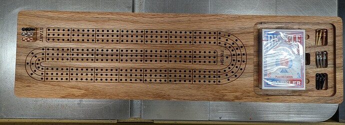

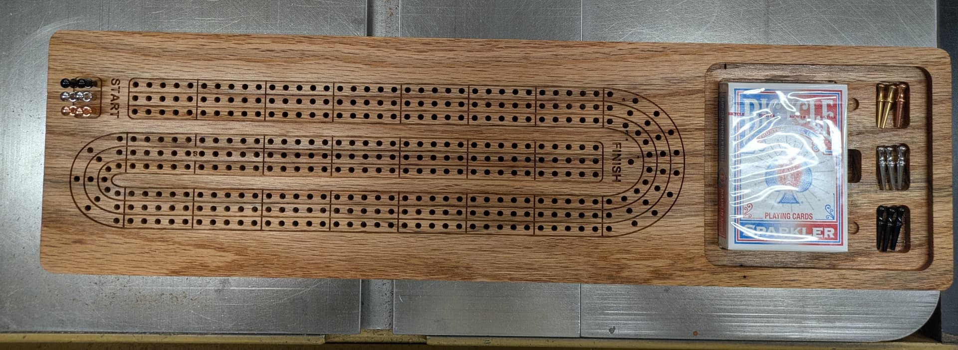

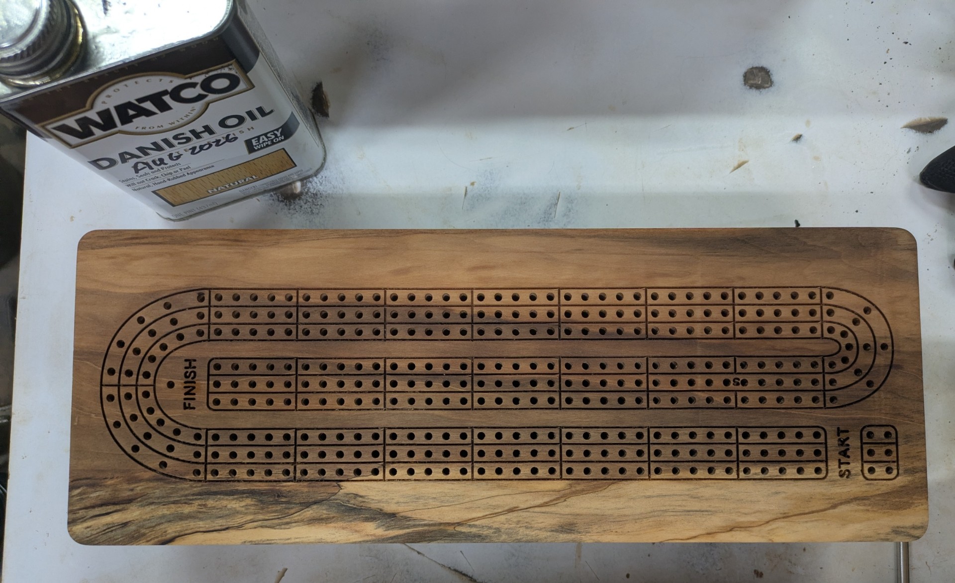

The above picture is with 1 coat of clear Watco Danish Oil. I think the wood is sycamore with some spalting. It was just in a pile of wood around the shop and was big enough after jointing and planning. The material was almost 1.0".
I think the project turned out good. I had cut the same file earlier but with a storage case for the cards and pegs. That made the project rather big.
I just removed the tool paths for the card recess and cover and saved the file with a different name and material size.
