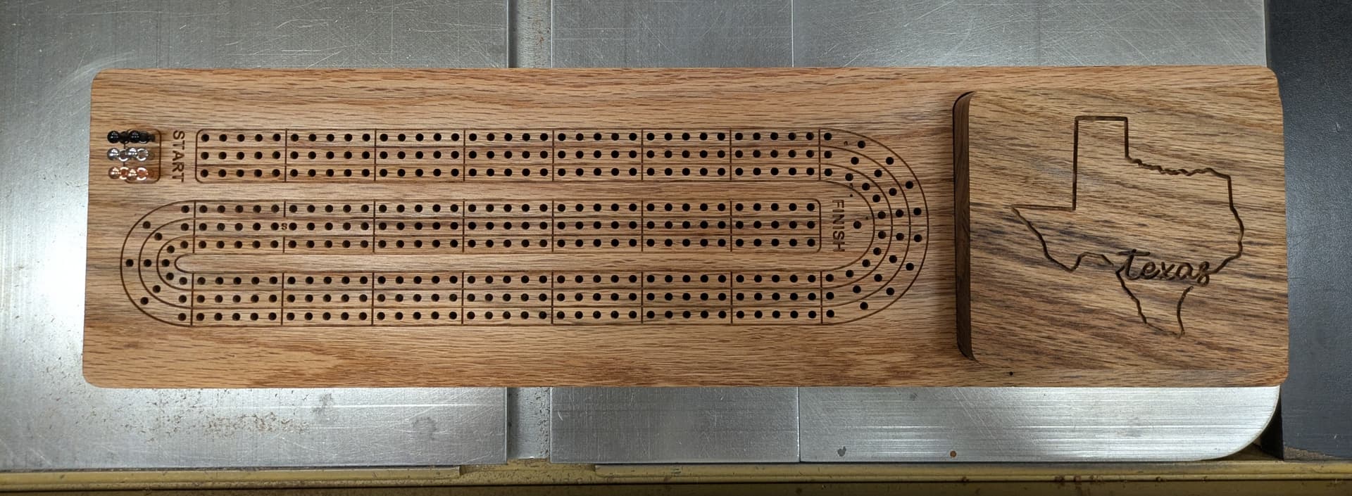

I have been on a making spree. I wanted to make some cribbage boards to sell at the Farmer’s Market and some shops on Main Street in Nacogdoches. I had downloaded some files from Cutrocket and will make some of them. However I downloaded one from etsy.com that was already a C3D file from v8. I had to edit all the tool paths and cut one today from some Water Oak that was a tree that used to be in my yard. I have never played cribbage and have looked at youtube about how to play. I am not a game player and the game has a lot of rules that I will never try to learn. My daughter and grandson love to play video games but I guess the game playing gene skipped a generation with me.
This is a rather long game but I think it came out very well. I used a 20 degree vee bit, #251 1/4" endmill, a #102 1/8" end mill and an extra long 1/4" down cut bit for the cut out. The material is 1" thick and 6.5" wide by 28" but some of the length was cut away.
I bought the game pieces from Amazon and the cards as well. I had bought 2 of the C3D cribbage kits and have 3 more on the way. I will use those for the files from Cutrocket.com.
I applied one coat of Watco Clear Danish Oil and the wood looks very nice. Now to just figure out a price. Since the card and game pieces had a cover I found a Texas outline and carved that into the cover.

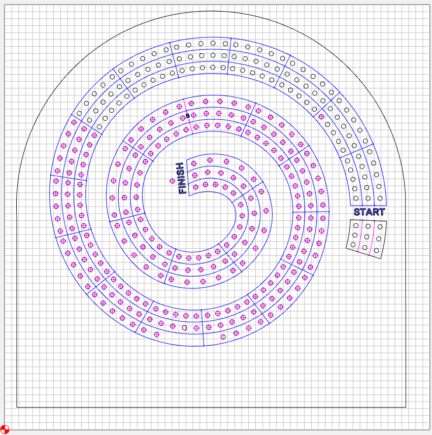

From what I read you can have 3 players on this board and it seems you move only one piece of the two at a time. Not sure why they have two slots at the start. Many cribbage boards I saw on line have a similar look. I did download a round one I am still editing. I got the size so the peg holes are just over .125". There a bunch of X’s on the holes I am removing so I can group all the peg holes and will have to glue up some boards for this 12" x 12" material. I will incorporate something similar to the above for the card and peg storage.
