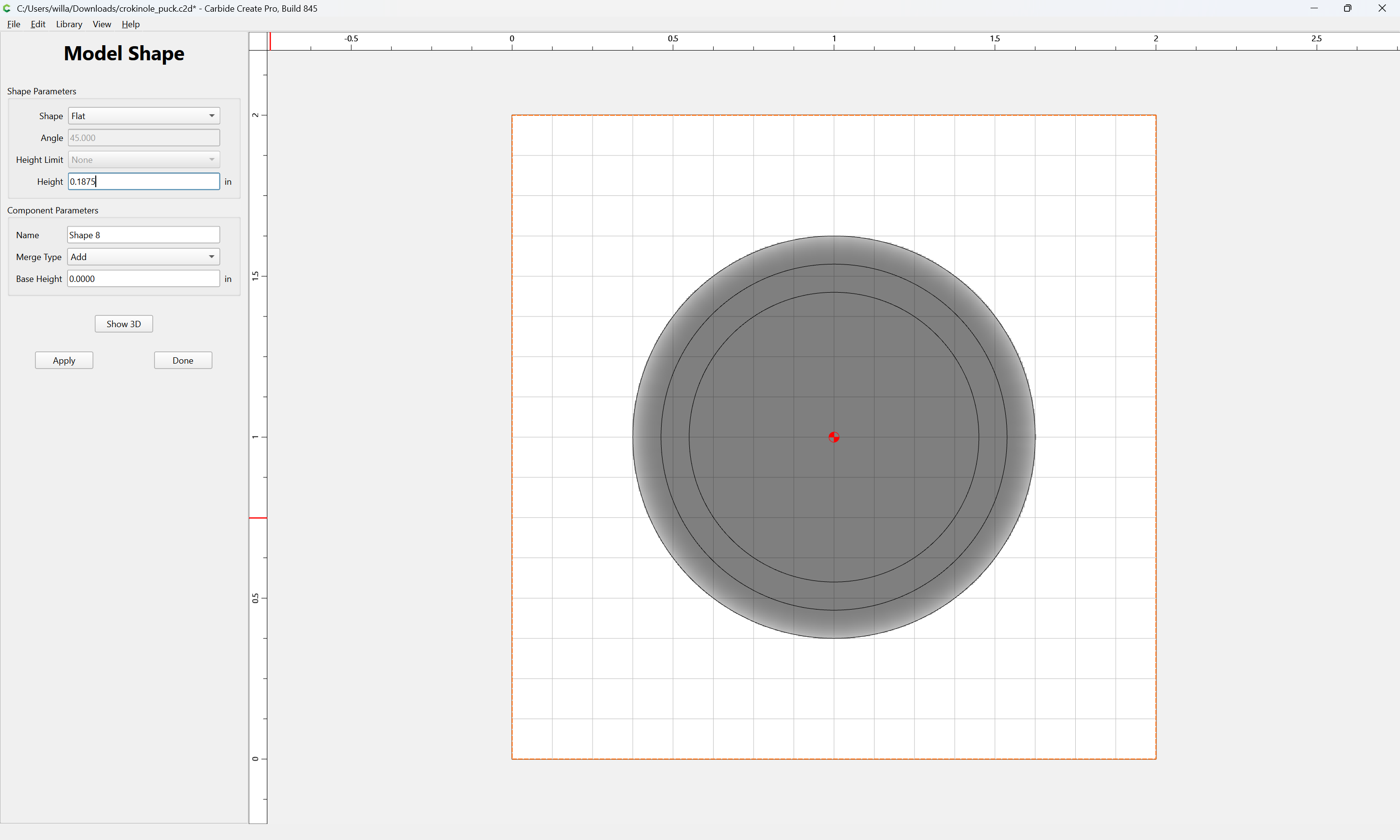

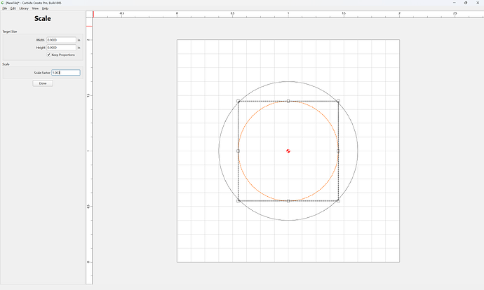

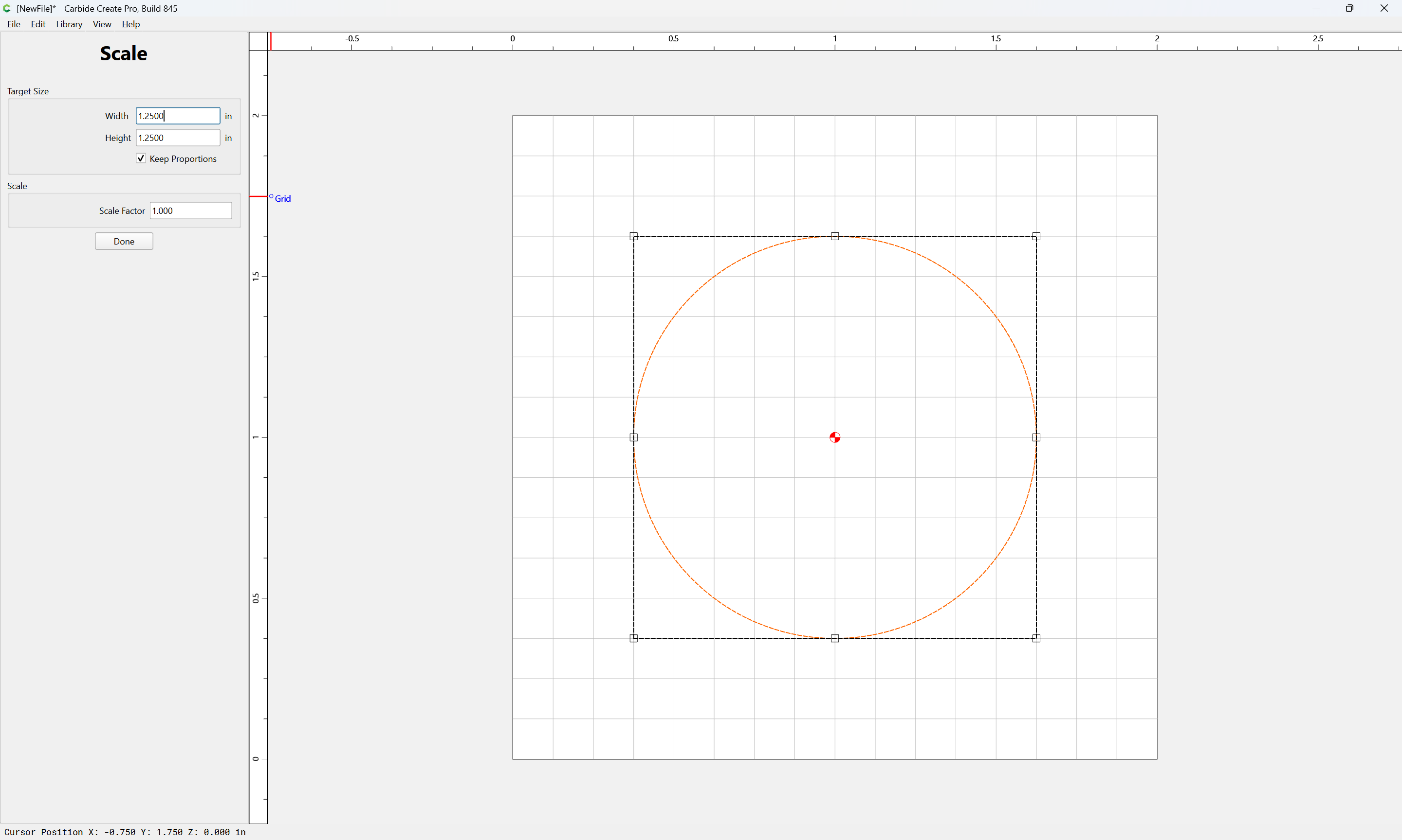

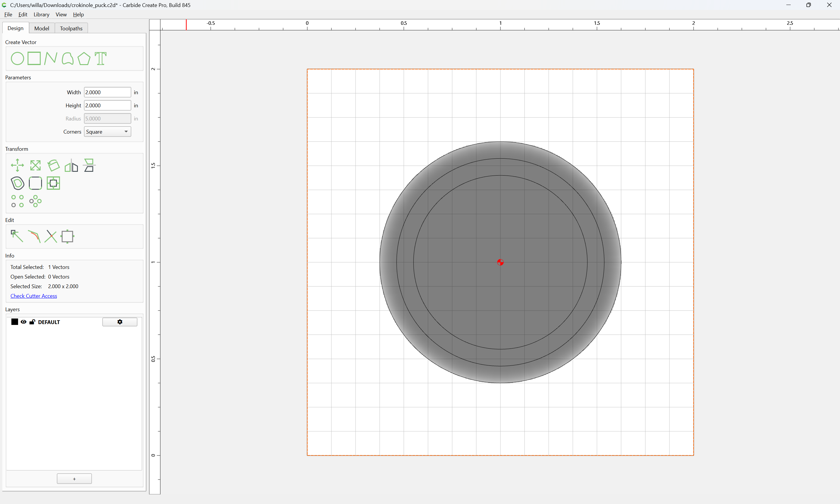

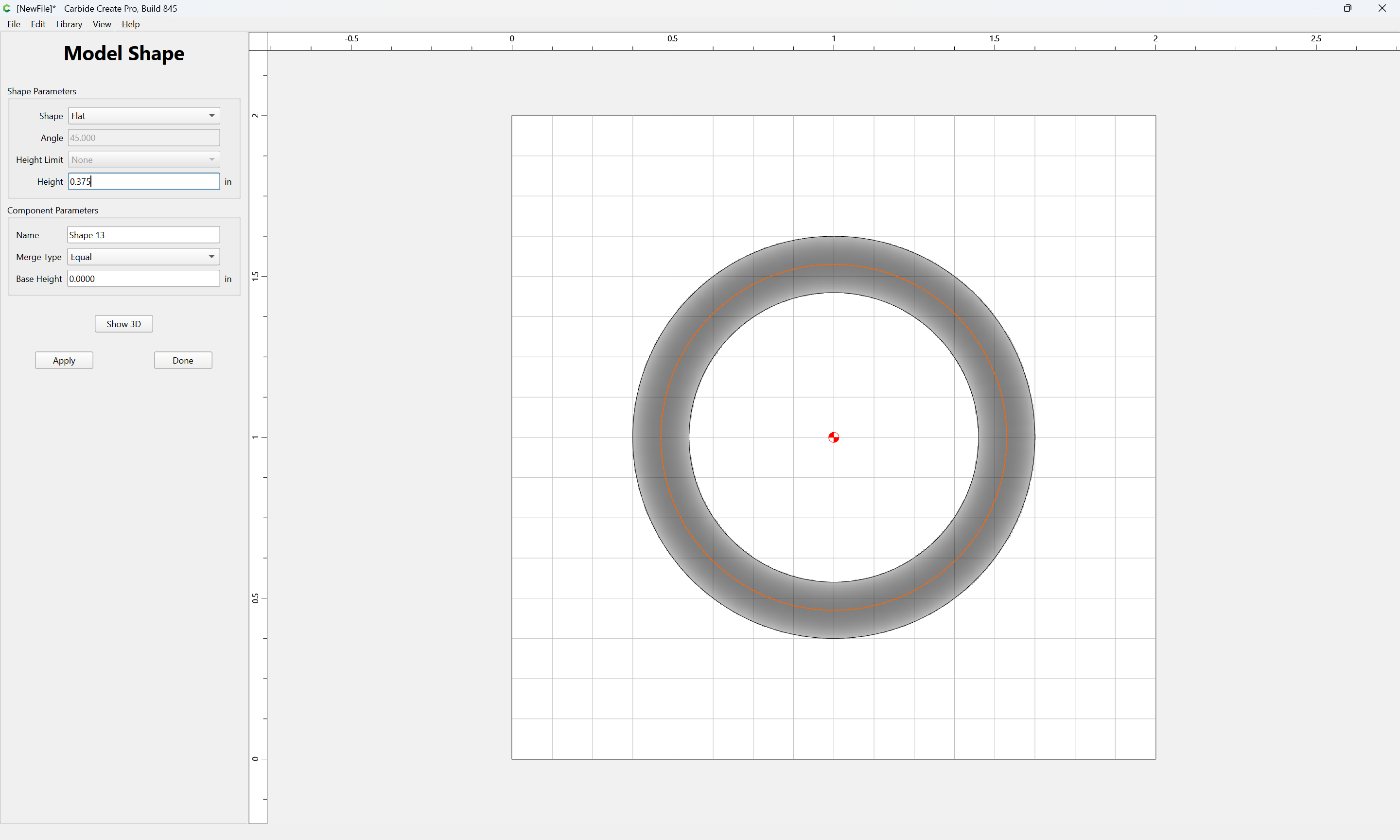

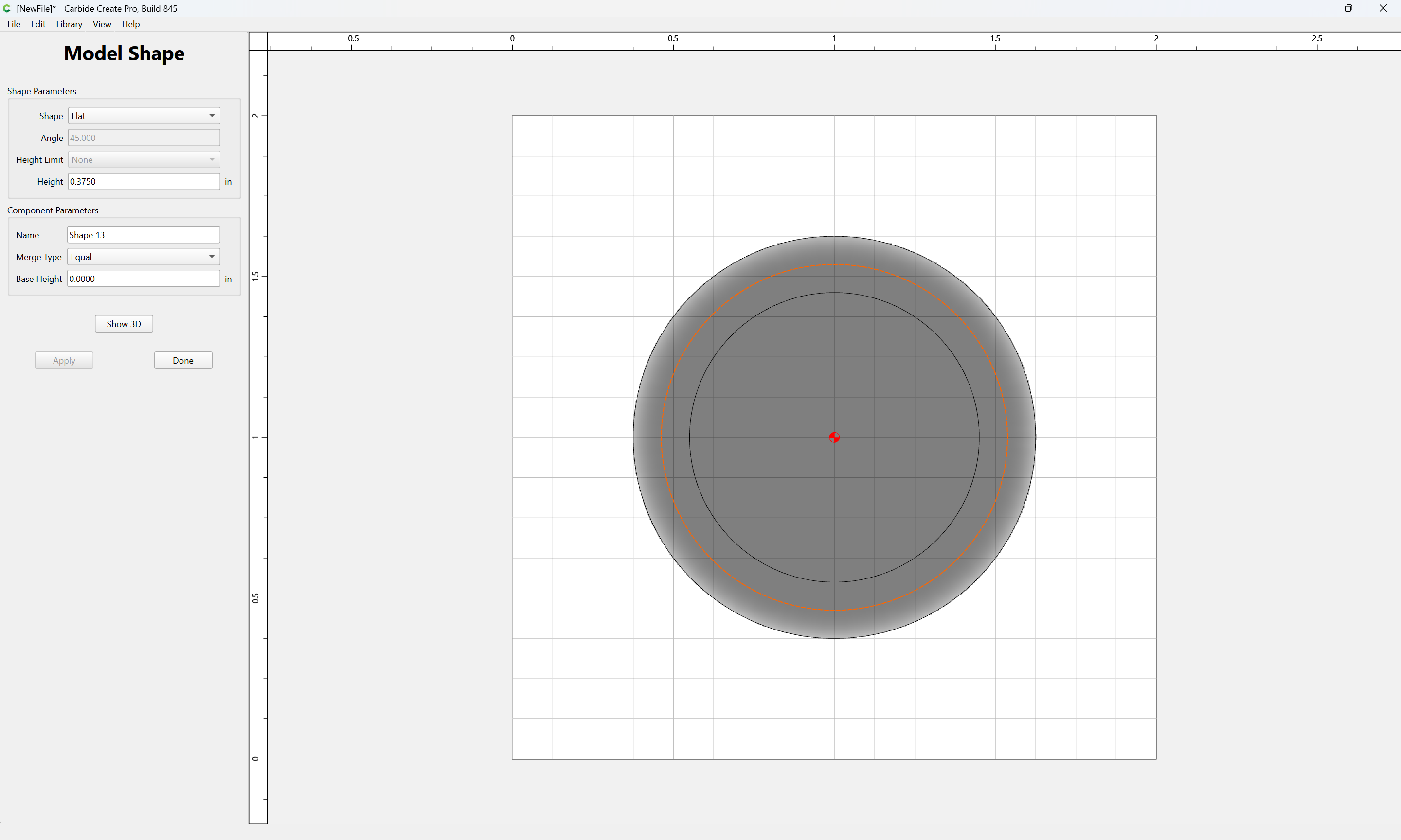

I’m trying to learn 3D modeling and have crashed too many times. Here’s my goal: I want a file where I can set some 3/4" maple scrap on the machine, flip it once, and have some crokinole pucks. They are 3/8" thick when finished so I figured I could just carve down and leave a middle 1/16th" inch of the center as a “tab” and then flip. It’d be simple sanding after that. They’re 1 1/4" diameter.
The curved side is the challenge. If it was straight sided, you could do this with CC free version no problem.
How much sanding are you willing to do? You could cut the edges with a V Bit, then sand them to be rounder. Again, CC free would do it.
Being so small, they are poorly sized for work on a router table, so I think that it out.
A large radius round-over bit might fit the curve, but the bearing boss would likely interfere with the tabs.
Full 3D could model the shape, but the cutting time is going to go up a lot. What’s your time spent VS result trade-off like? Is it worth to you 10x machine time to get rounded edges vs straight edges?

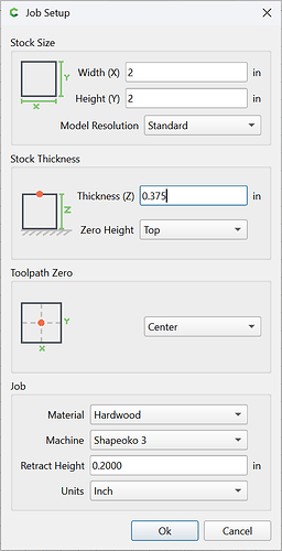

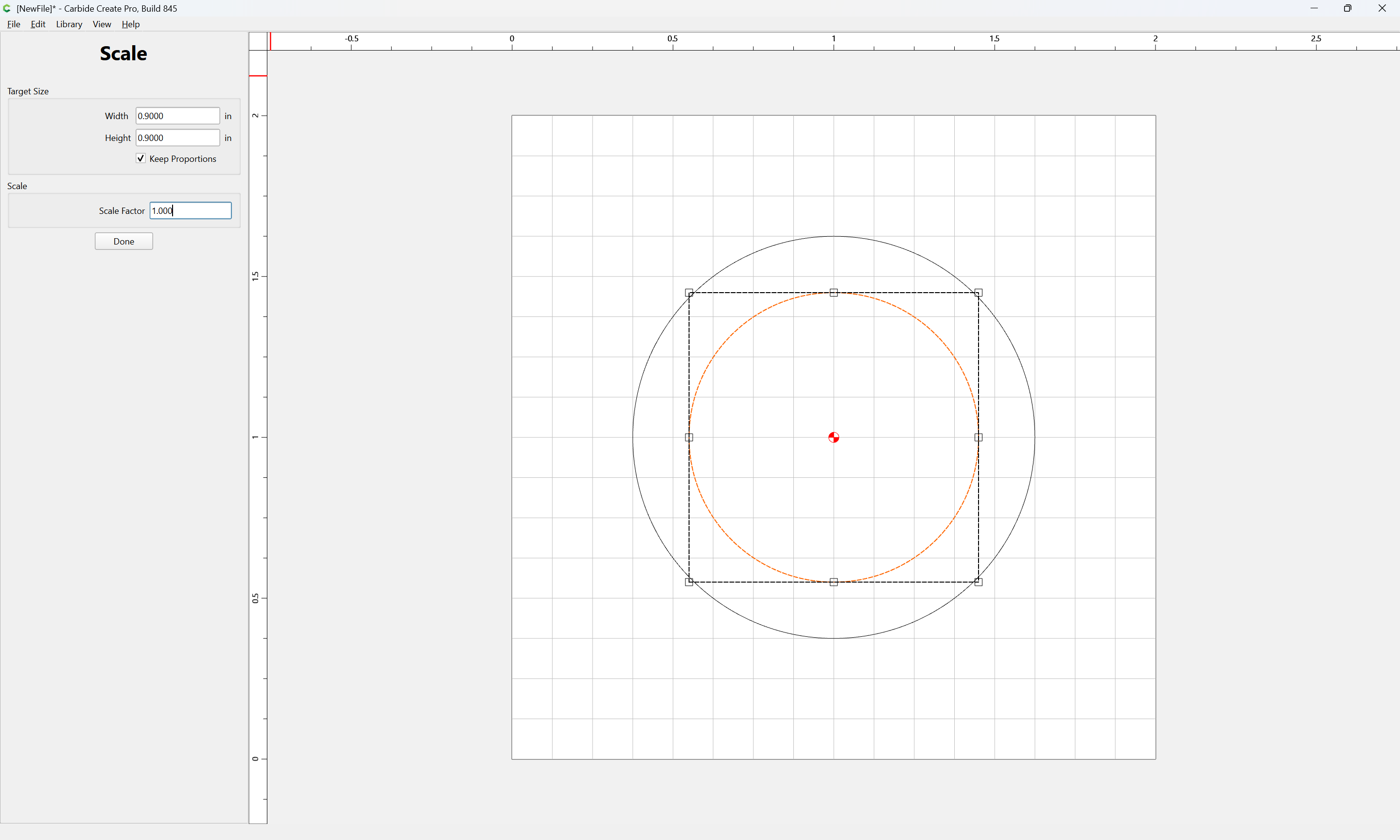

Set up the file:

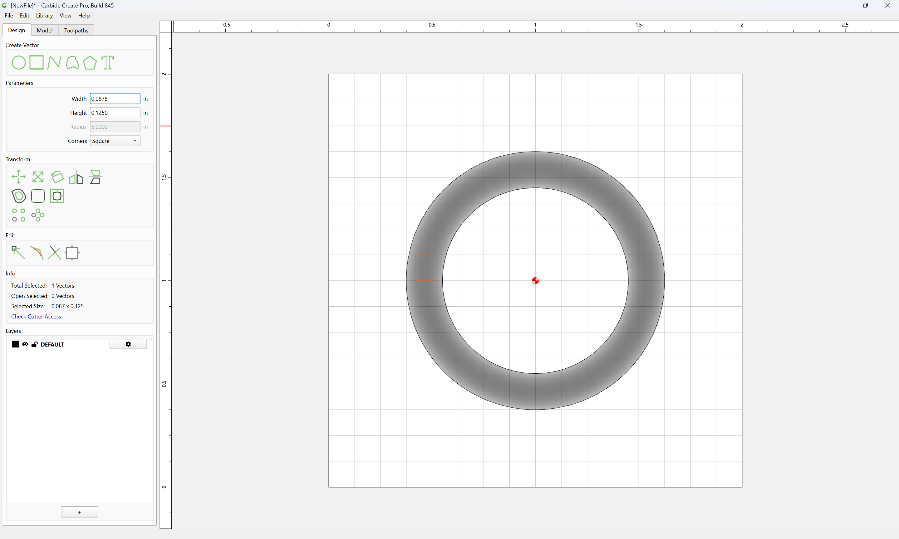

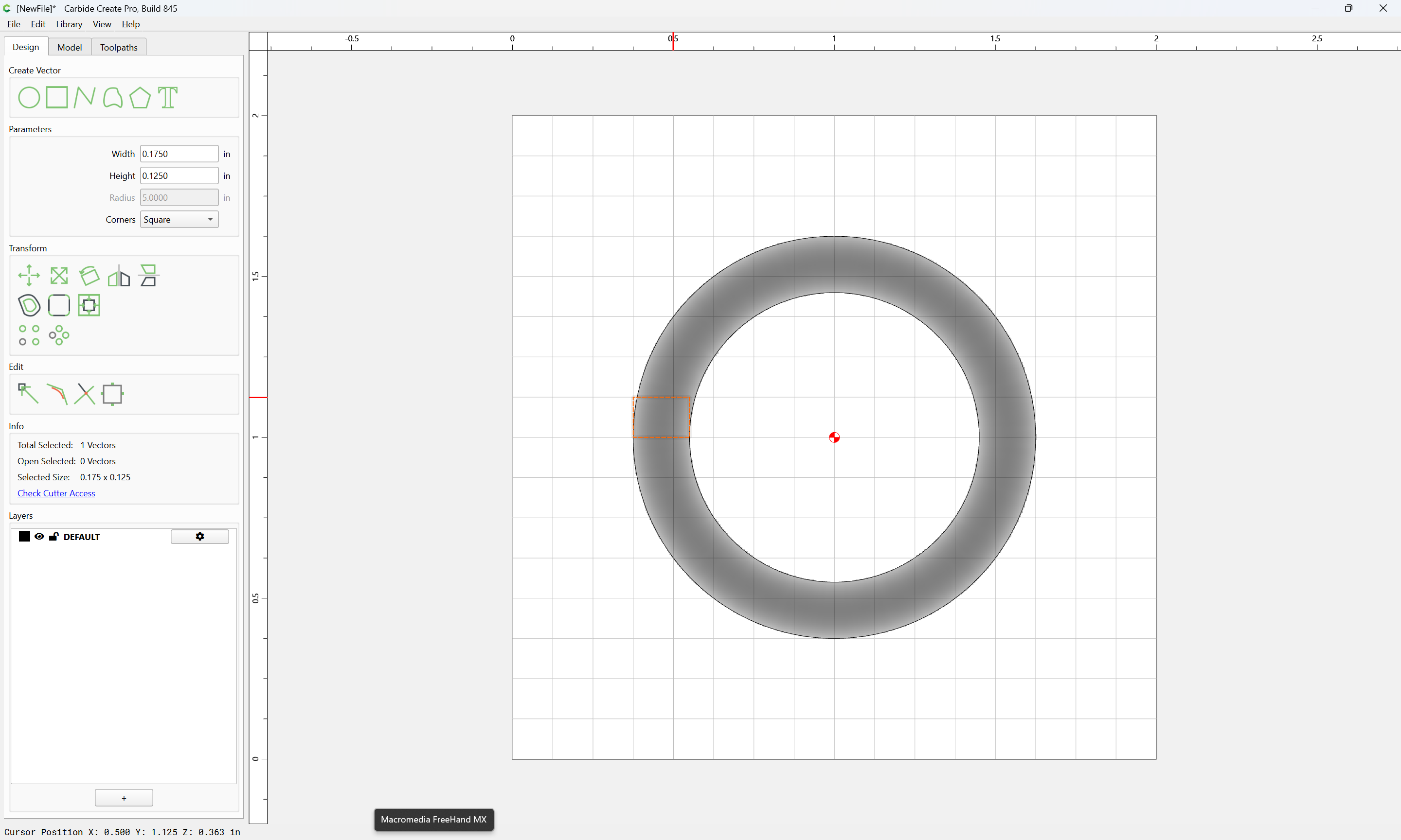

Draw the outer geometry:

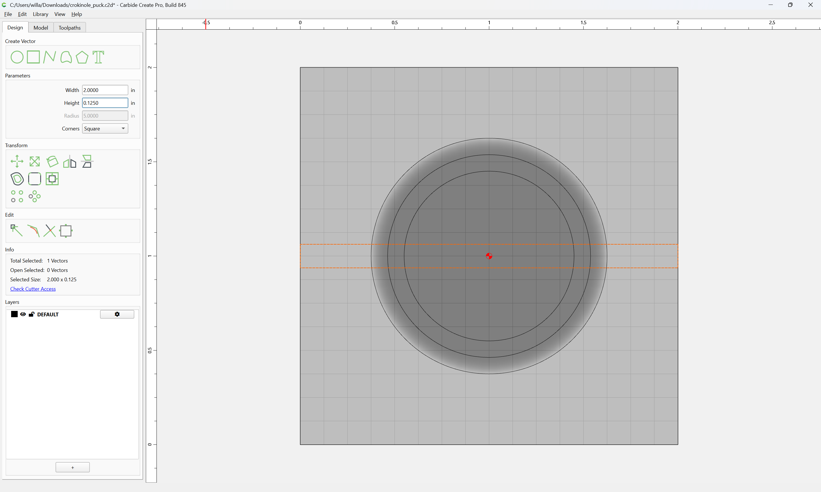

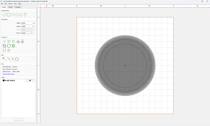

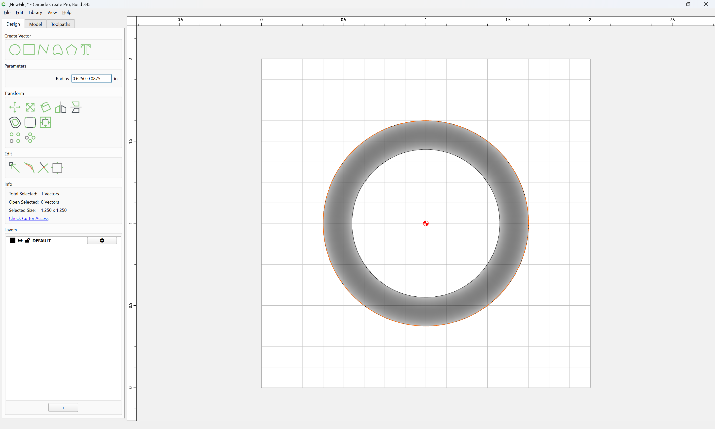

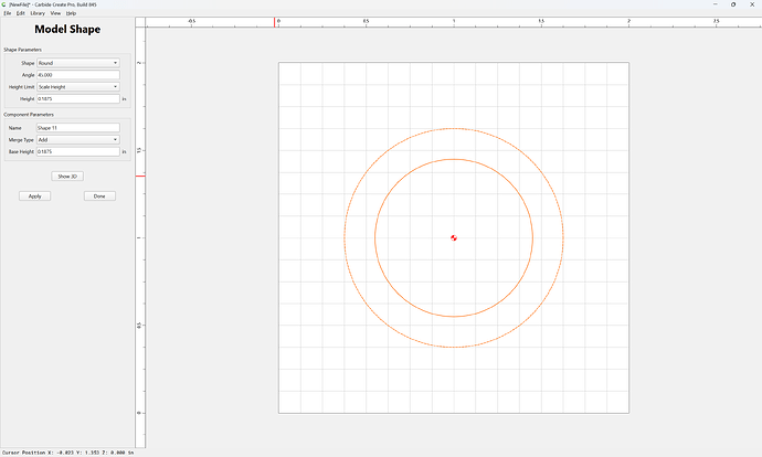

Then draw geometry which is more than twice the rounding of the inset:

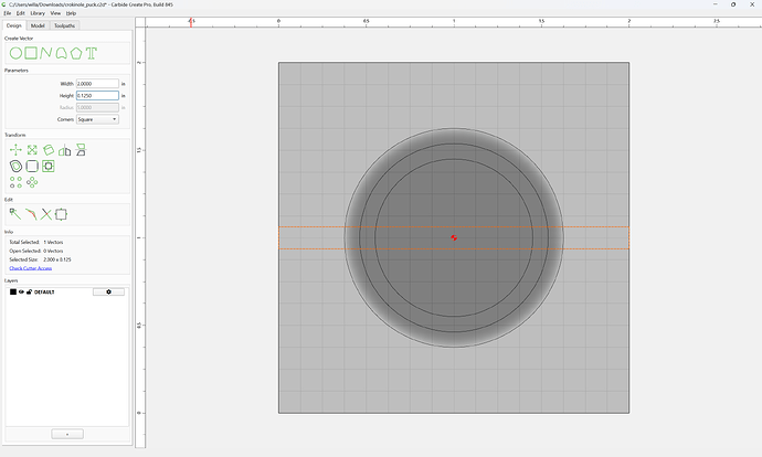

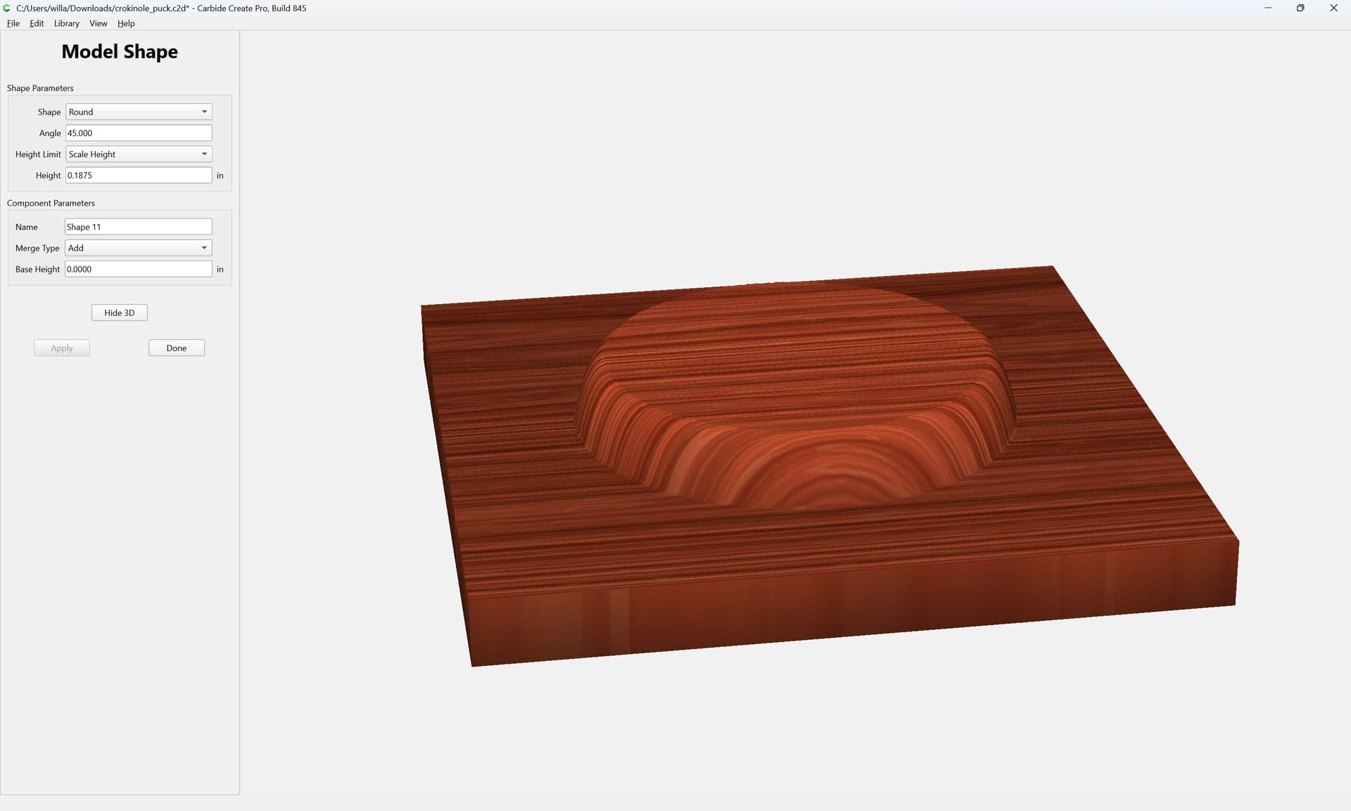

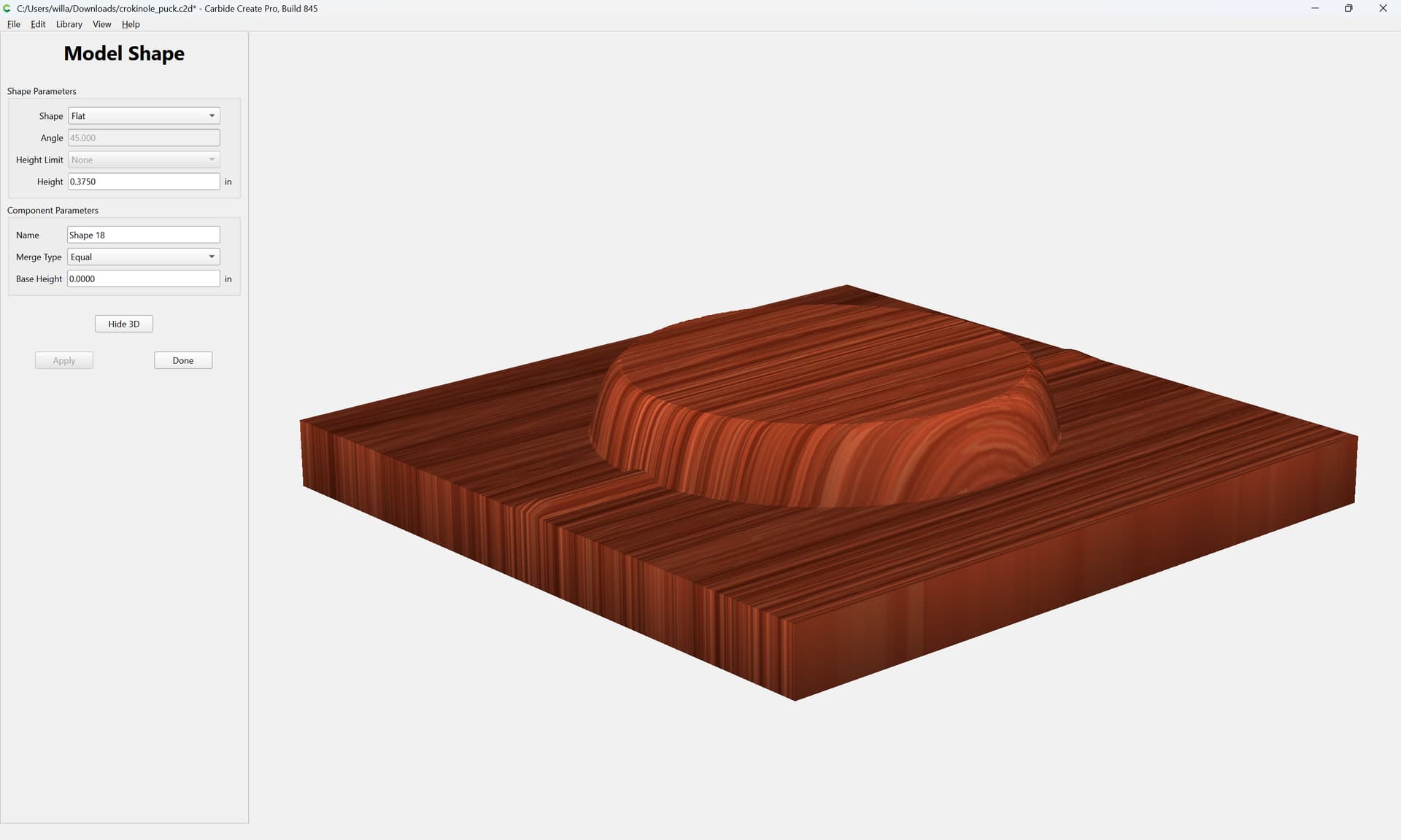

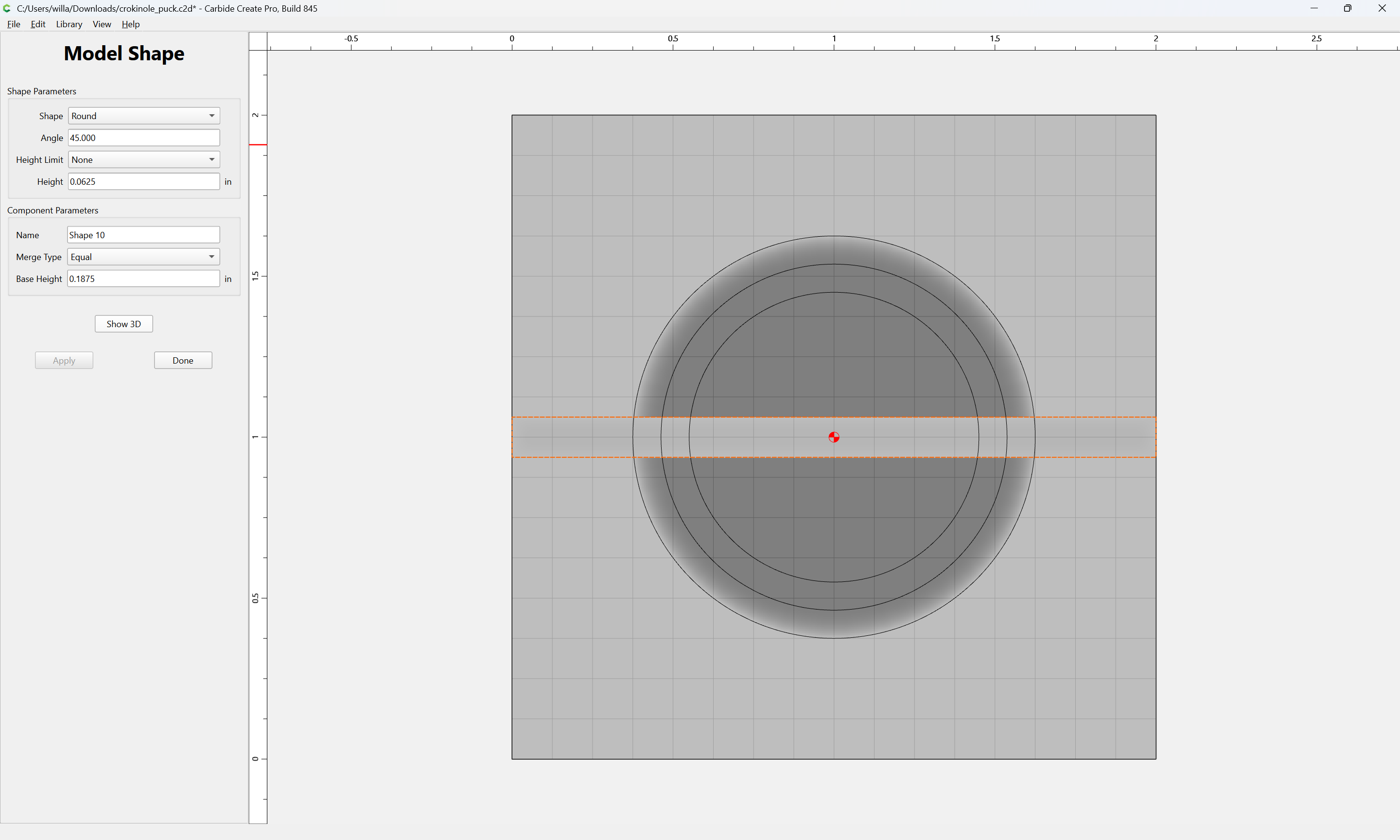

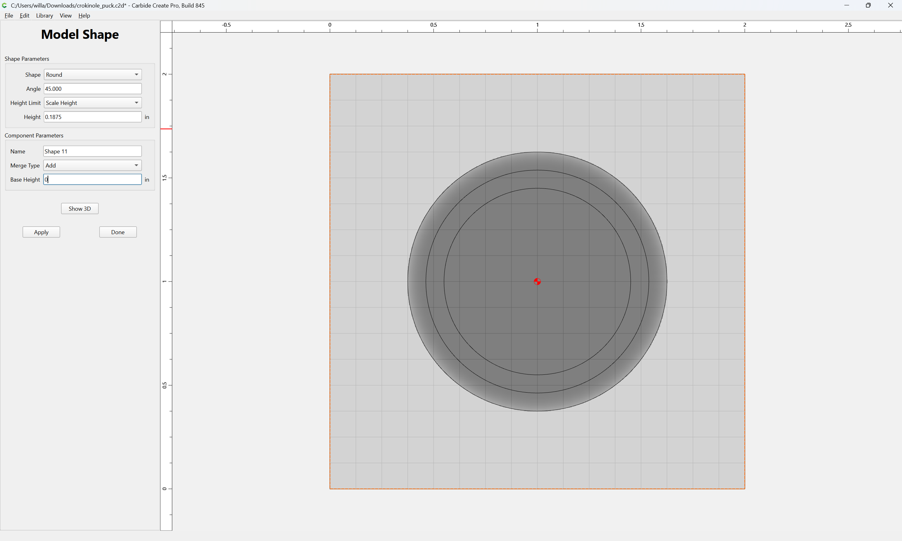

Then model the rounding plus half the thickness as a Base Height:

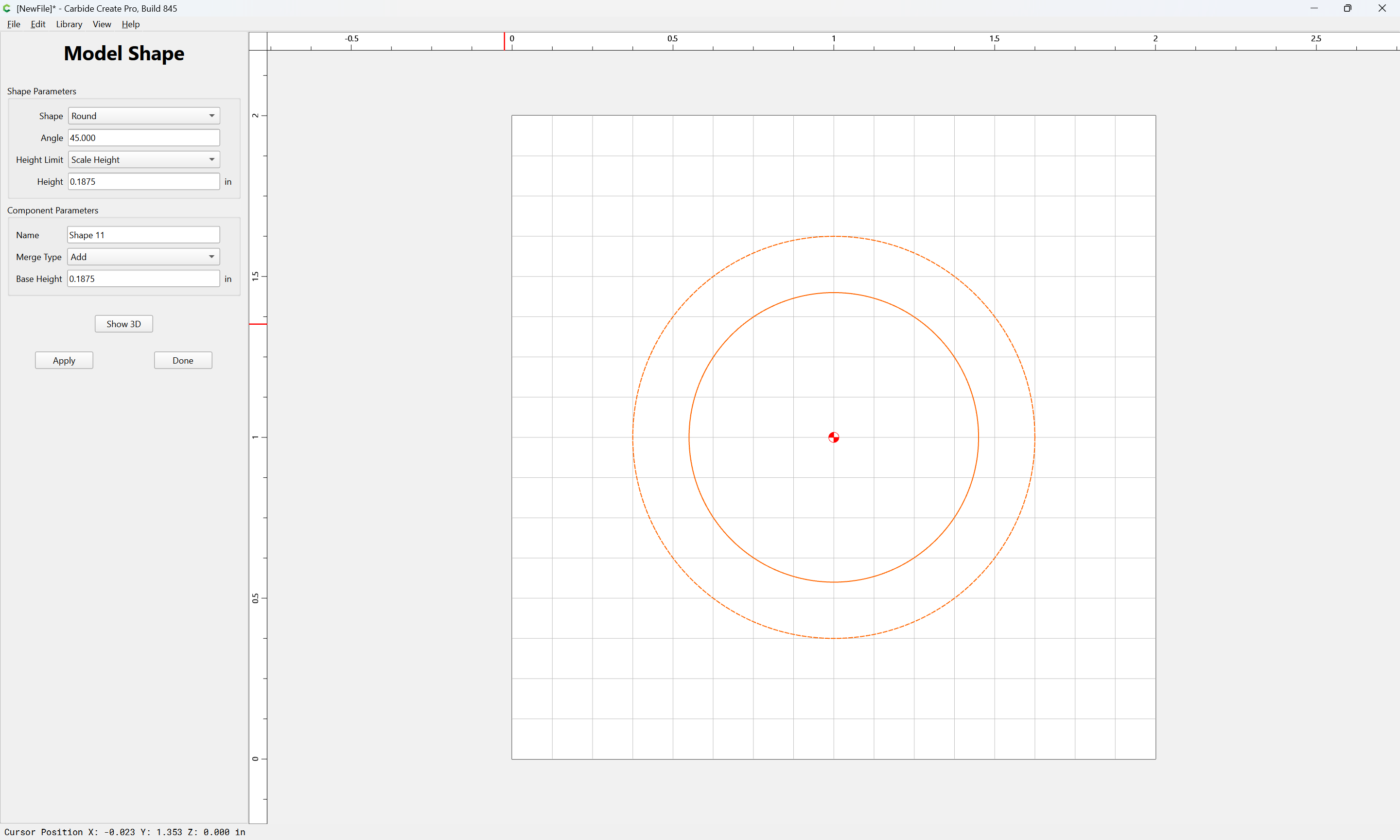

Draw geometry to measure the halfway point:

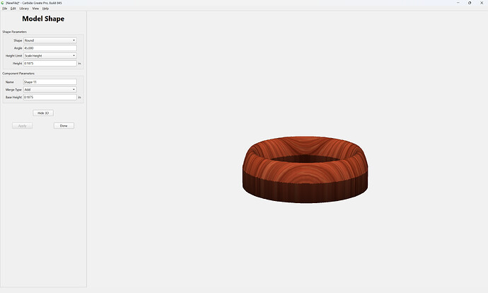

then use that to model the thickness:
Apply

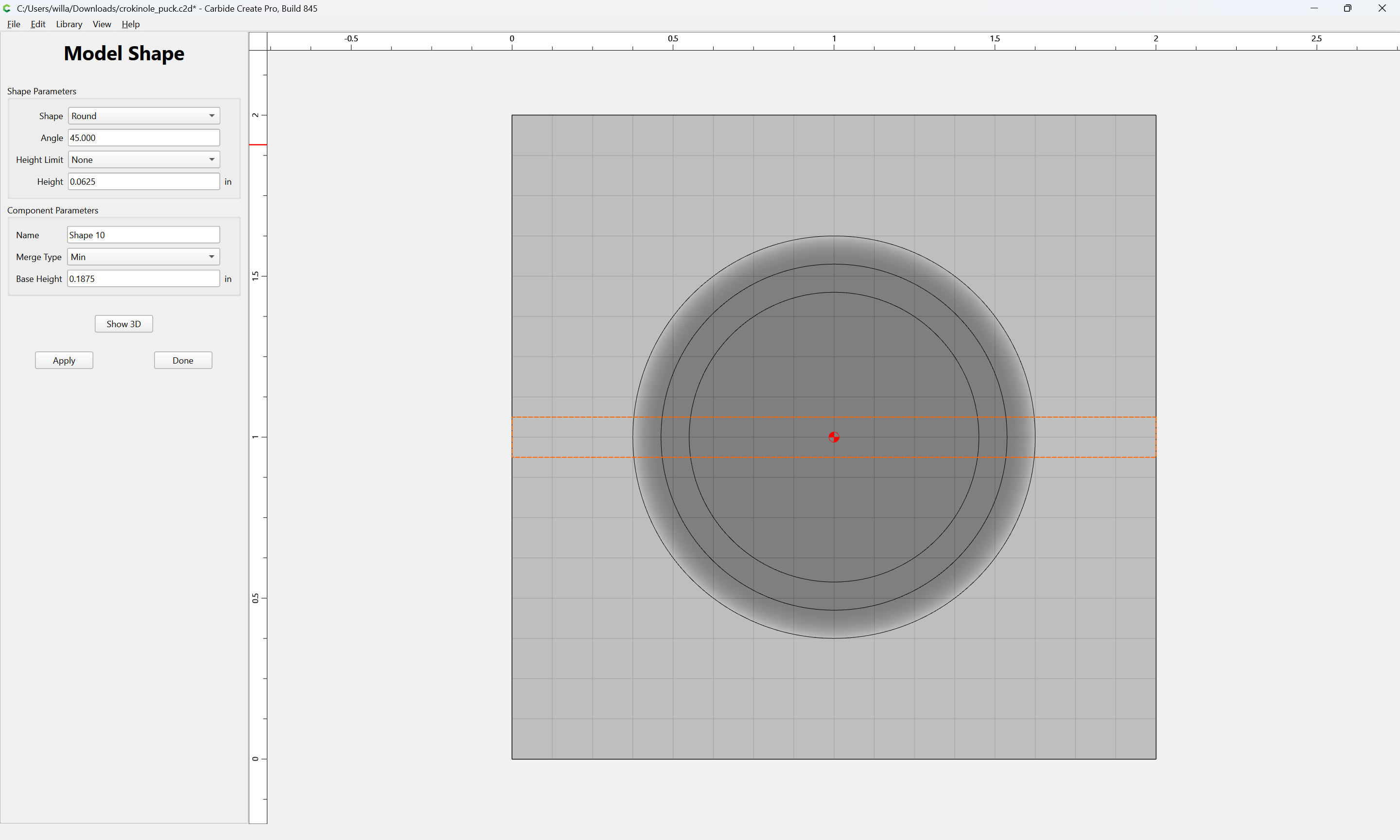

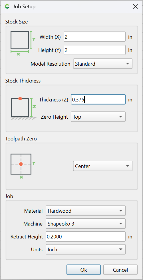

For cutting halfway through it will be easier if the stock is modeled to half thickness:
and zero out the Base Height:
Probably want to add a sprue to keep the part from coming free:
and adjust the balance of the modeling:
Attached as a v8 file:
crokinole_puck_v8.c2d (252 KB)

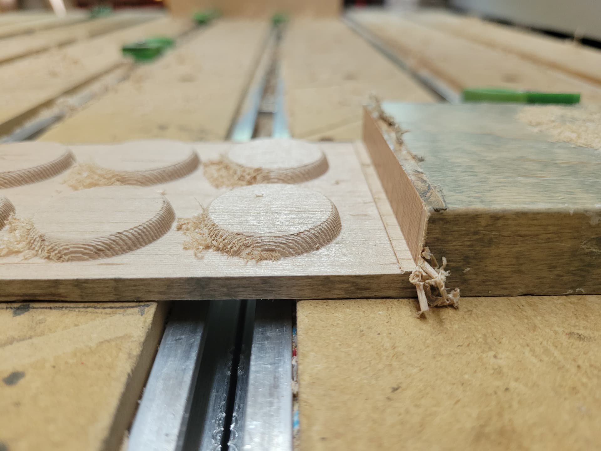

It’s been slow going because this is my busiest time of year but I’ve made some maple firewood and think I’ve got it almost dialed in.
