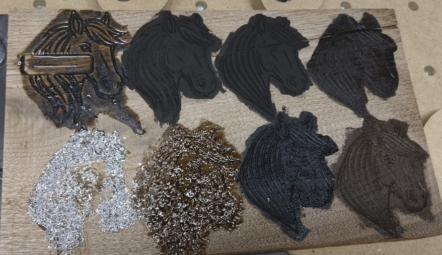

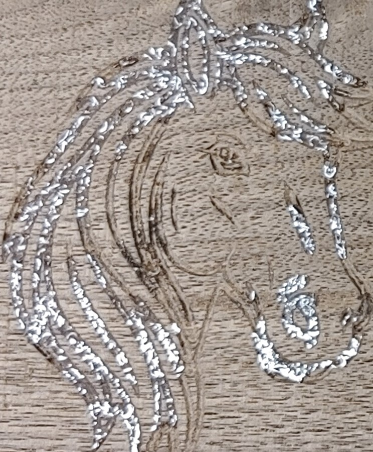

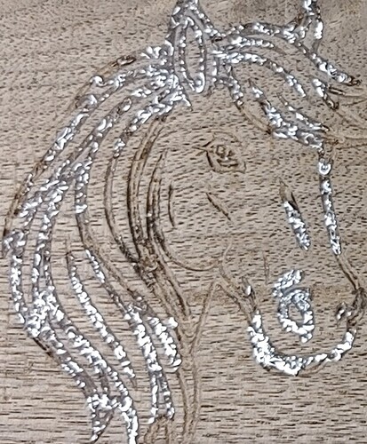

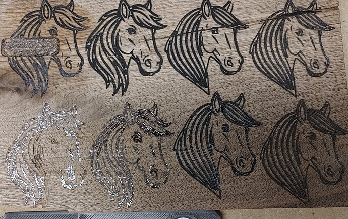

I did a quick test (I’m aware it’s a very crappy test) but just to give a very basic idea if it’s worth pursuing this strategy. I dumped full untouched chips into the milled out area with resin (terrible test because of the size of the chips). I just wanted proof of concept to see how it would look when sanded. Most of the chips didn’t even get into the pocket, but where it did showed very good potential.
Image attached, its worth the effort trying to make it work IMO.
Top left: resin + dark mica (resin was improperly mixed, wasn’t 50/50 so it scuffed result)
Bottom left: resin + aluminum CHIPS
Right of the aluminum chips is copper chips + resin
All others are stain variations.
If I can get that aluminum to look totally solid, or at least somewhat aesthetic in the vbit pass, it will be a game changer as far as shooting out higher quality products faster IMO.
To carve that horse head out of 1/16" aluminum would take probably 1+ hour.

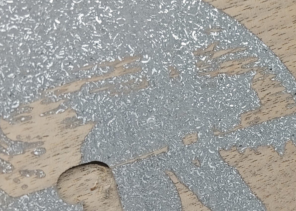

Been distracted with all kinds of other stuff, but I got some fairly fine powder made just by using a coffee grinder and crude home made filter. I’m currently waiting on a level 100 mesh which should keep the particle size just right.
I have some epoxy mixed with the powder I put into a test piece, it’s curing right now. Need to wait for cure, mill off excess then sand. I’ll share the results when it’s ready.
aaand it looks terrible lol
was worth a shot. mica powder it is.
It might have worked if the back material was black or something near that.
