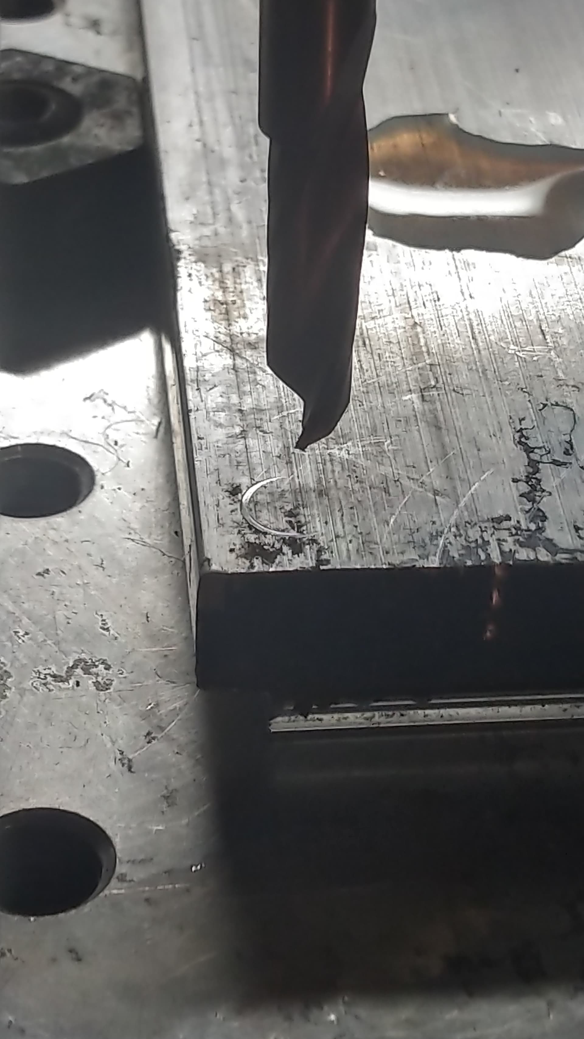

Hello,
I should be able to probe the corner as if it were the BitZero with the way my machine is set up. What do I do with the firmware to implement this permanently. I am lost at when I found gc_block.values.xyz.
I think I just need to change the offset probe type BitZero v1 puts by default.
No need to mess with the firmware…not sure where you were going with that.
A few options.
  1. Use the BitZero routine and then change your offsets manually.
  2. Enter the probe commands manually through the MDI.
  3. Use a sender capable of doing what you want (CNCjs).
I would like a permanent carbide motion solution.
Maybe it is here void mc_probe_cycle…
You’re looking at the Grbl source. Although Grbl (firmware) handles the probing, all of the commands are sent by the sender UI (Motion).
If I had to use Motion, I’d just use my option one above. The offsets the BitZero creates are known. A simple G10L20 command (can explain more) will give you the precise zero you want (as precise as probing with an endmill in a CM routine can).
you made me break an end mill because i have to put offsets in manually every time.
