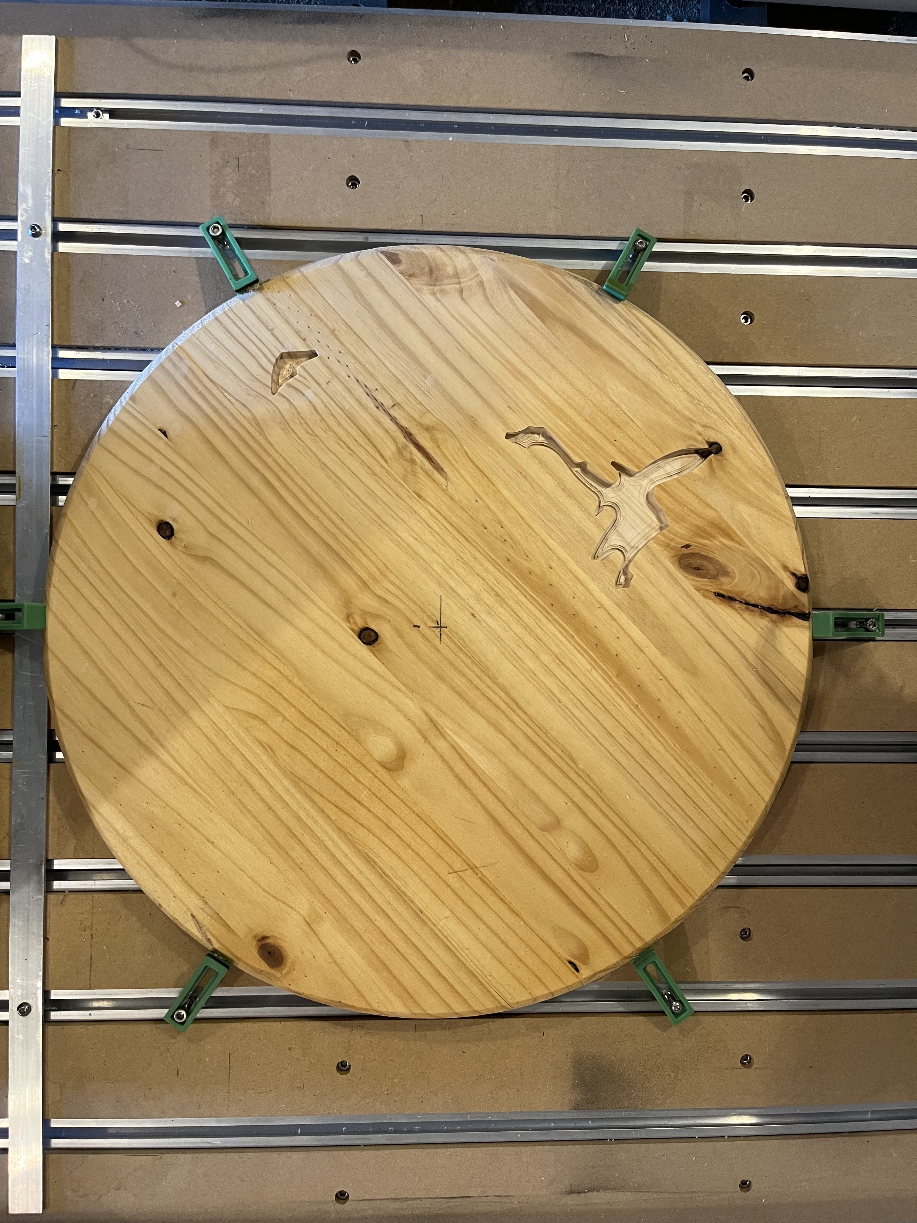

i could use help with my cut depth. I am running the xxl with the latest version of motion. I have my start depth at 0.00 and cut depth at 0.155. when I finally decided to stop the program I was at .375 and still going. I have triple checked tool paths and my zero, and they are all right. any advice? Iām stumped. This is the first time using the updated version of motion
pls post the project
Any possibility your cutter slipped out of the collet a bit?
Tried different bit to see, 1/4 and 1/8. No difference
Please send in the .c2d file and let us know step-by-step how you are securing your stock and setting zero relative to it and managing all tool changes, and send a photo showing the stock in place and the machine at the zero position relative to it (or a specified offset from that position) and screengrabs showing what Carbide Motion shows for Position and Machine Position (click on either to toggle to the other).
Most of that was over my head. I can say the project was saved as nc. Not c2d. Would that matter?
Here is a picture of the project on table, zero is center, using advanced v carve with 1/8 bit to start
The .nc file will not allow editing the file ā it is only G-code/toolpaths to be sent to the machine.
