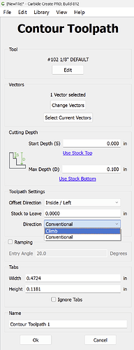

Hi all,
I need to cut two simple lines. Creating two lines is easy, making a tool path is easy enough on the two open (pink) vectors.
But, it only cuts on one direction, wasting a bunch of time pulling out of the material, travelling to the start of the line, and continuing the cut.
There doesn’t seem to be a setting to make this easy, so what is the work around?
Thanks everyone!

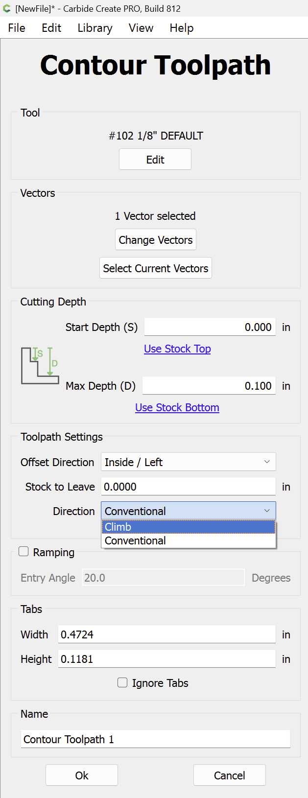

Note that Pro adds an option for reversing a toolpath.
Um, which toolpath? And where is it found?
Contour:
Direction: Climb vs. Conventional
OK…well that’s certainly not intuitive terminology!

Climb/Conventional is not available with No Offset. It could be, and the default conventional could cut the curve start to end, and changing it to climb would cut end to start. (?)
Other software has Climb/Conventional/Mixed, where Mixed will cut both directions as Dale suggested.
