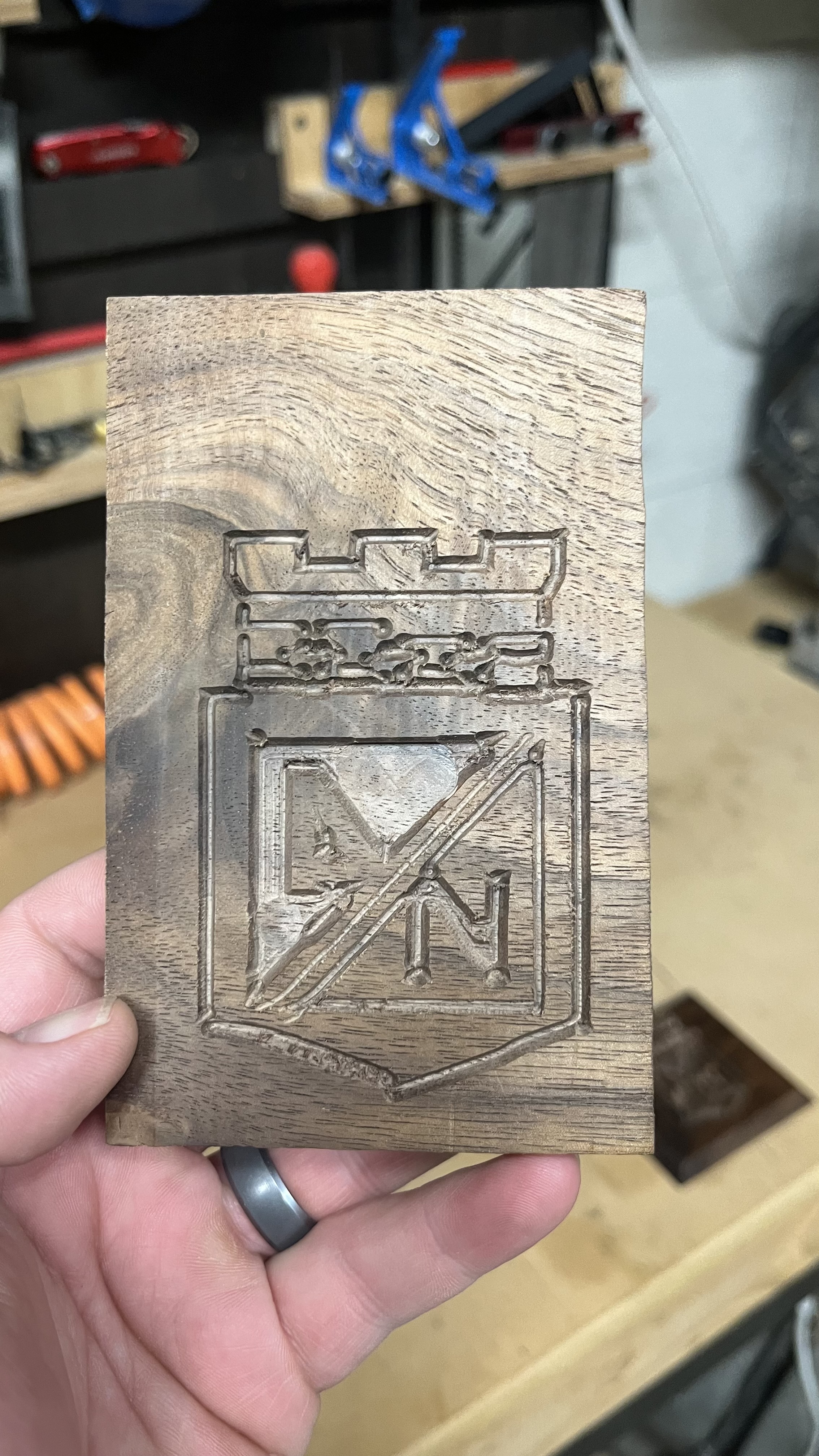

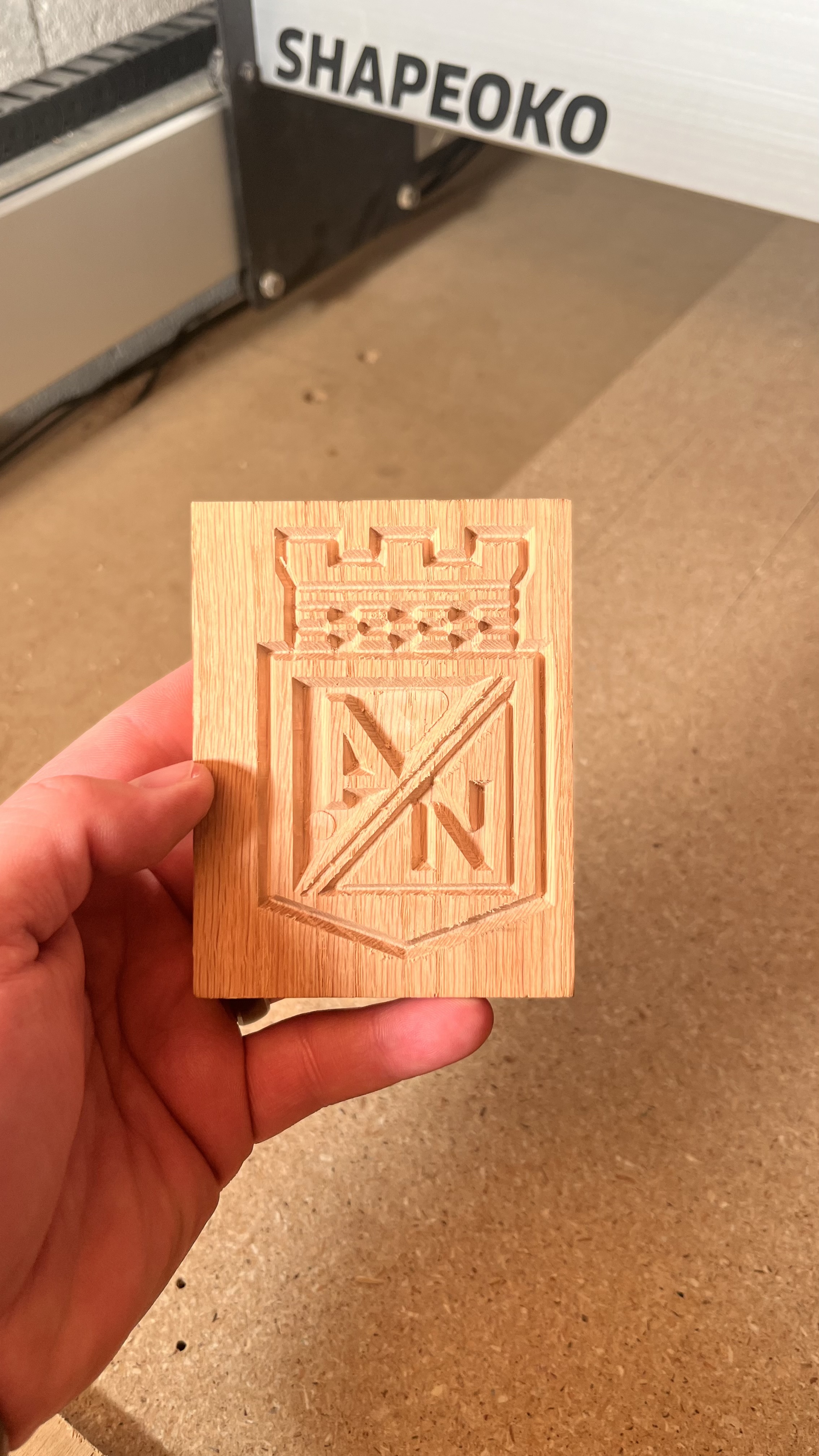

I’m very new to this and am not sure where to start with this. When I make a design in carbide create and then run the program, it looks different. I ran it a few times and the cuts look the same to each other.
I’ve attached photo for reference.
What am I doing wrong? Is it a problem with my machine or the program?

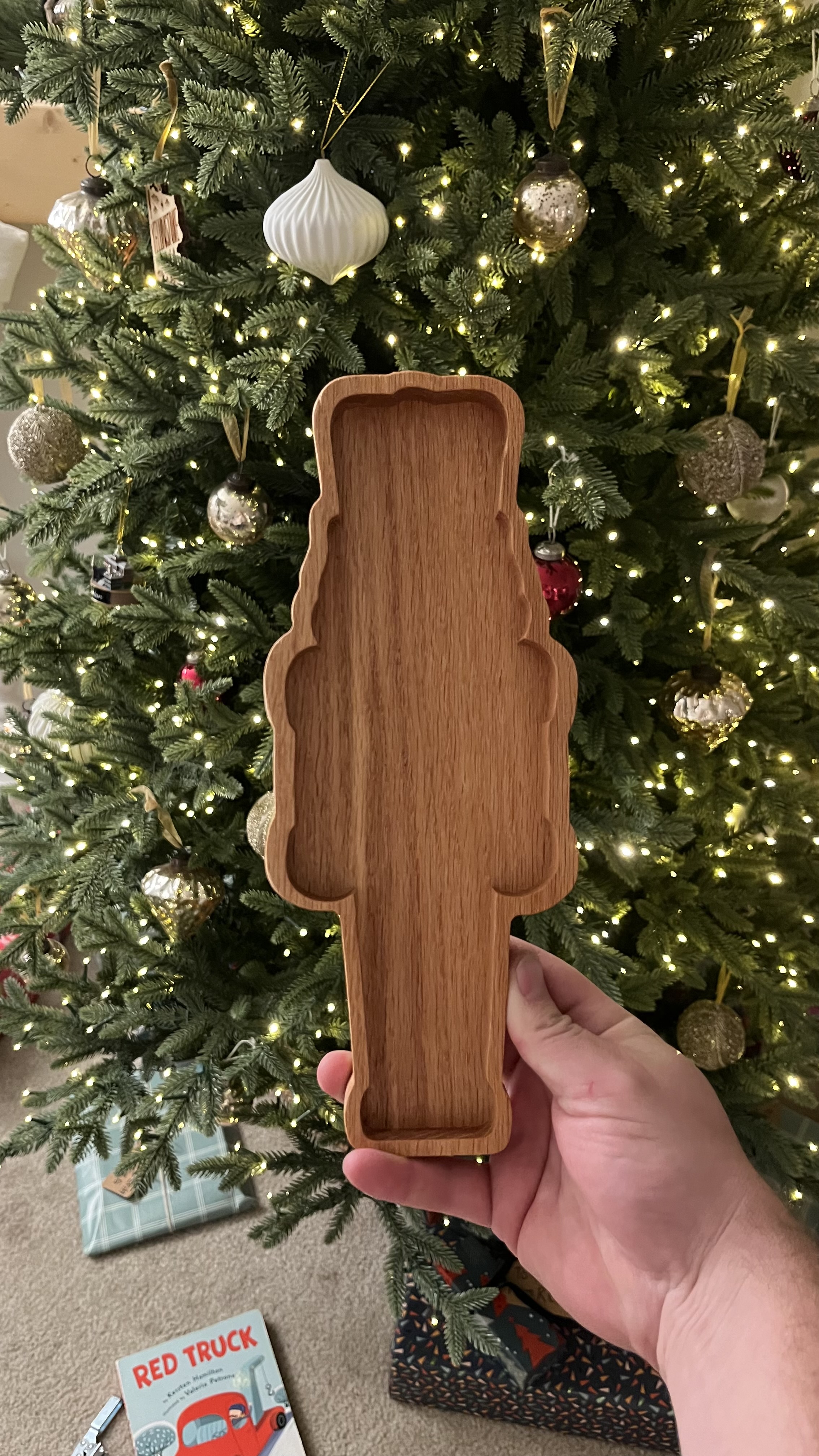

Not sure if it’s related but I have also noticed that the top right and bottom left corner of trays I cut out are thinner on the walls.

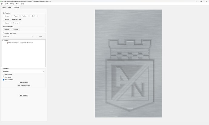

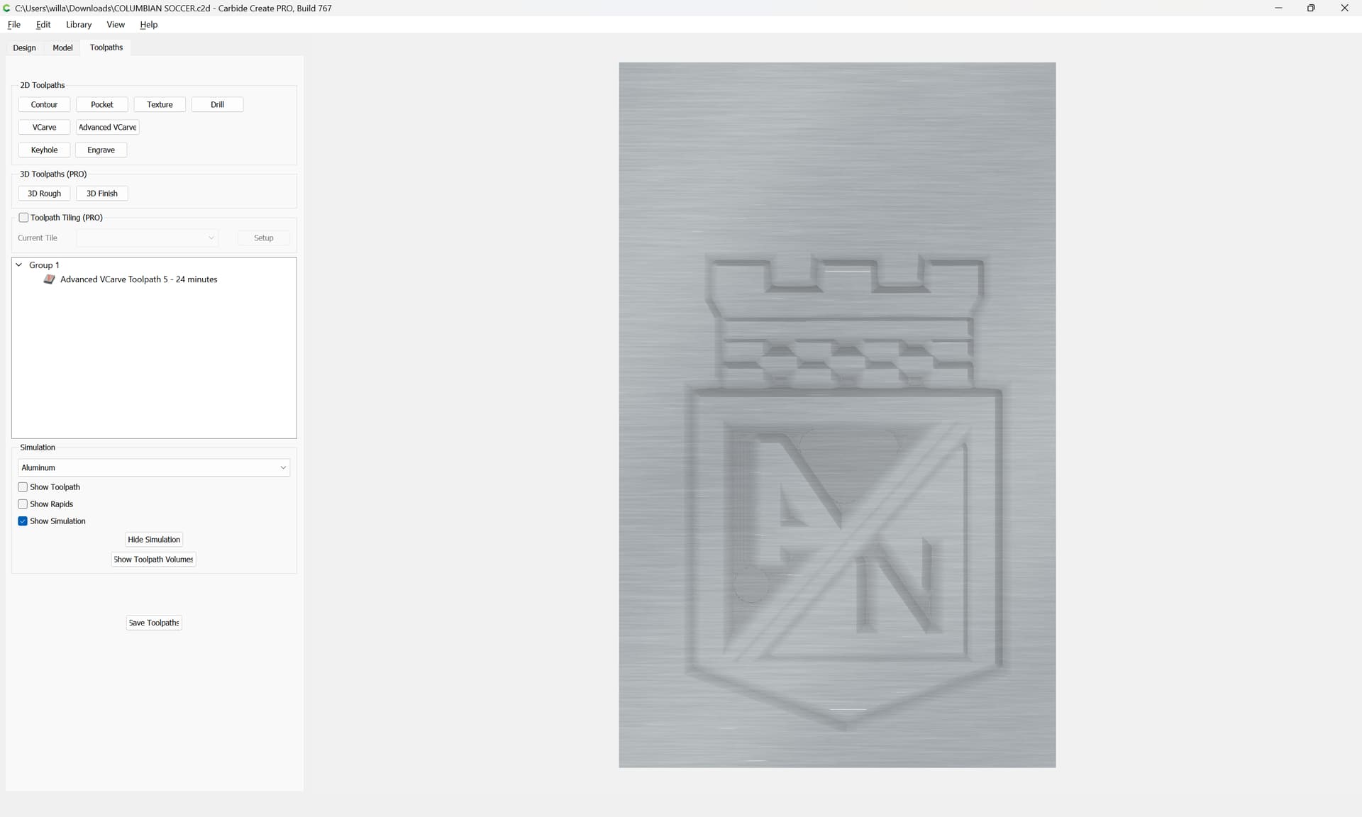

The preview of your file in Carbide Create:

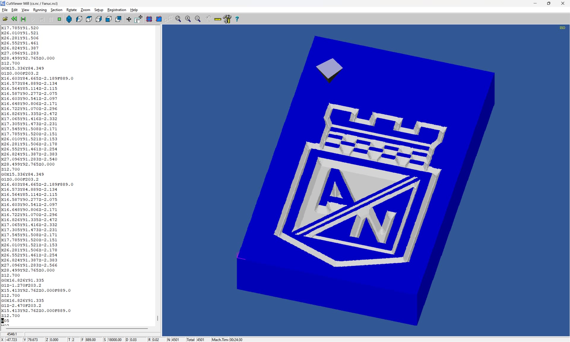

Matches a 3D preview in a 3rd party tool:
so if the tool geometry is accurate, then the problem is something mechanical (or electrical) on your machine or some sort of interference (say a cable or hose getting in the way).
The changing wall thickness in the other cut would support this — most likely something on the machine is allowing the tool to pull the machine into the cut.
Power up, put a probing pin in the tool and jog to the center of all 3 axes, then grab the tip of the tool and try to move it — push/pull, &c. — it should be rock solid — investigate any way in which the pin is allowed to move by the machine when the motors are working to hold it in place.
