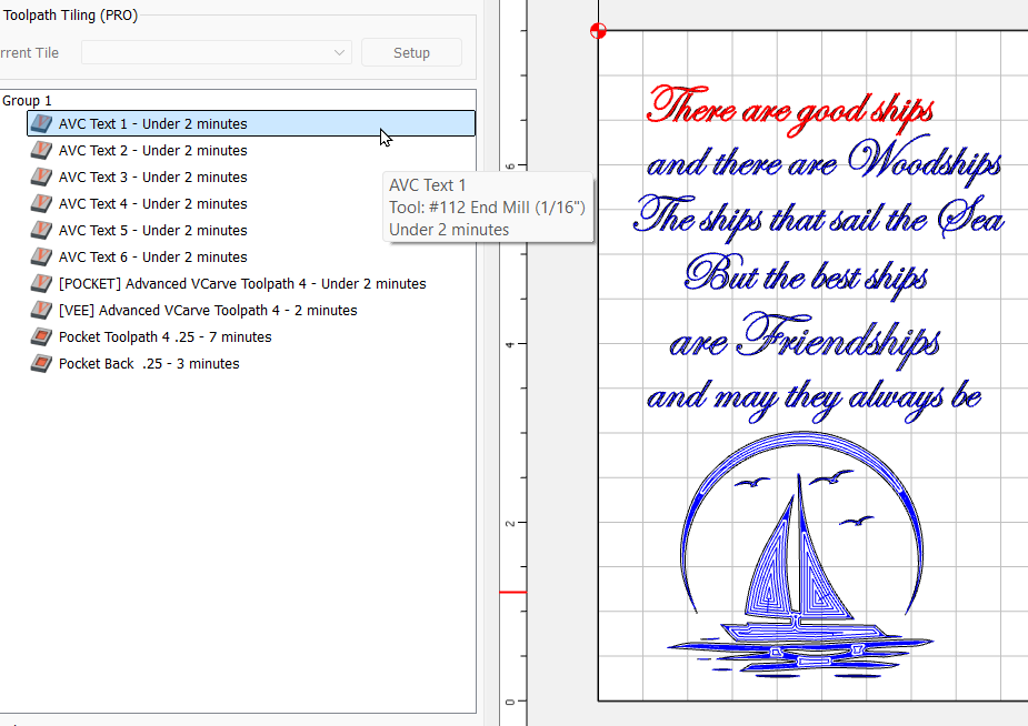

Cut times are too long on small lettering CC on a S3
I’m still a newbie after a year. When cutting sentences, I have found that CC goes all over the board cutting parts of letters here and there. Spending more time moving than cutting. Any script is worse than block.
  • 2 questions
    Whats a safe Retract height when using top of board? Some of my clamps are ontop of board edges, but not in cutting area.
    ** Does the machine always move all way up after a cut - before leaving the board area?
    -if i change retract height from 0.397in to 0.100 my cut time drops from 129 to 37min. - is this safe?
How can I get machine to Cut the letters in order to avoid all the rapid movements?
Using 60 degree V / advanced VCarve and setting a deep max depth, it still takes multiple movements to cut the round “flourishes” ends on scripts.
Converting lettering to curves and editing some area’s helps, but this is a pain as moving a node can alter the whole letter.

How large are the letters you are carving? If they don’t need to be pocketed/AVC’d you could change the font to a single line font and just contour the text (with no offset) as an alternative?
I wouldn’t set the retract height any lower than the clamp that is highest above your stock - plus some margin for error. If you want a lower retract than that you may want to consider using double-sided tape (or painters tape and adhesive).

If you cut each text line as a separate AVC path, it will finish each line before moving to the next, saving a little time.
You could also combine the lower parts (moon, boat, birds) into a single AVC path. I think it looks really nice with a 0.040" - 0.050" depth, and it closely matches the depth of your text.
I frequently set retract to 0.010" - 0.050". You just have to make sure the path isn’t interfering with any work hold downs. You can see the path in the simulation, and if it’s close you can draw in the clamps.

I split up the text lines, combined the lower stuff & it’s under 26 minutes.
You might save a little time if you convert the text to curves & union the outsides of the letters.

Tod, what is AVC Text? Something in CCpro? i’m still running basic. Breaking lines up didn’t really help much. I probably won’t get Pro till after the summer ( summer time is plenty busy outside )
I believe “AVC” == Advanced V carving.
Note that this is now the default/only option in v8.
thanks Will, that’s what i been using, but he shows a 1/16 endmill, and i cant put an endmill in a vcarve. no bother, making a few changes with everyones help, I got this down to an hour, from 2.
