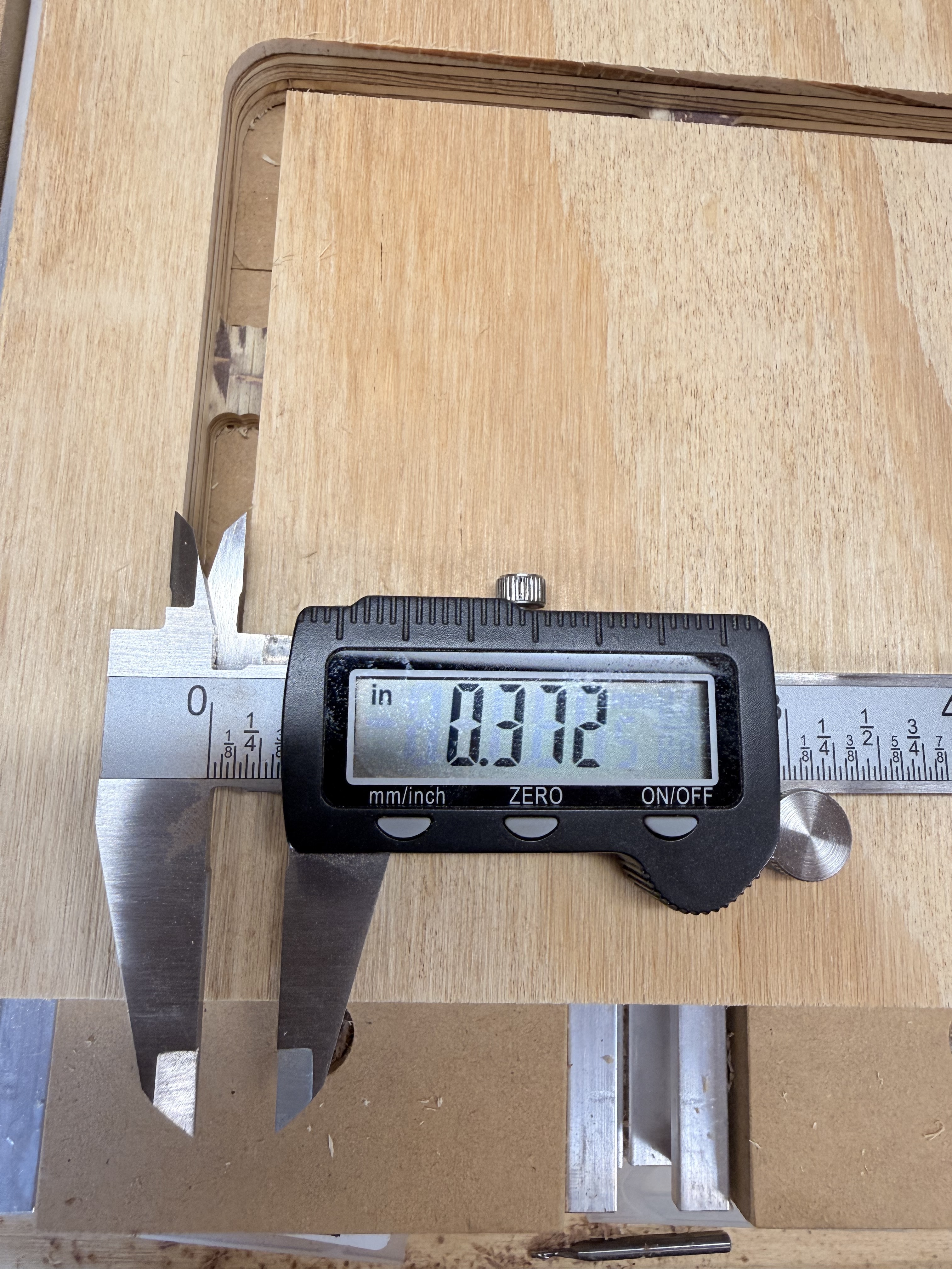

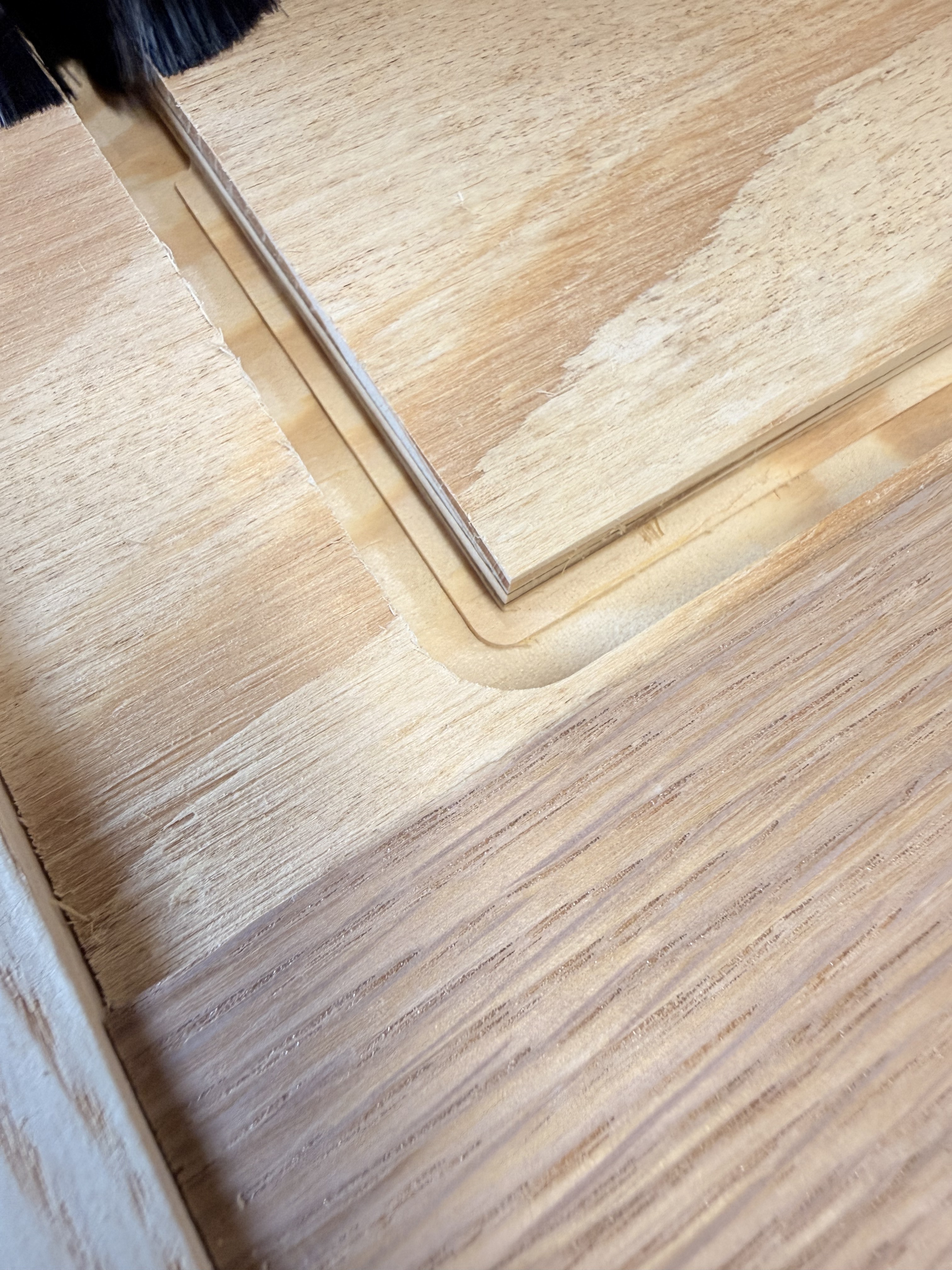

I couldn’t find a lot of information on the new cutout toolpath so I decided to test it on scrap. I used a 1/4” upcut bit. It actually adds a toolpath outside the “original” and alternates cutting between the two a little at a time. This will prevent a deep, narrow cut when cutting a profile. In my case it would’ve help the other day when my cross exploded due to built up sawdust in the cut. The 1/4” bit left a cutout of .37” so there is some overlap.

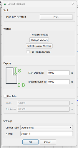

@WillAdams has given some explanation but I am still not sure about the “Breakthrough”.
I get the start depth and the reason for the Cutout Toolpath but I have seen conflicting ideas about Breakthrough here on the forum. If you just want to cut to the bottom of material should it be set to 0.0? If you want to cut slight below and into the spoilboard should the number be negative or positive. Likewise if you want to leave an onion skin should the number be negative or positive?
Breakthrough is how much additional depth is cut away (positive)
or how much is left uncut (negative):
I used a breakthrough of .001 and it came out great. It’s .001 below the bottom of the stock.

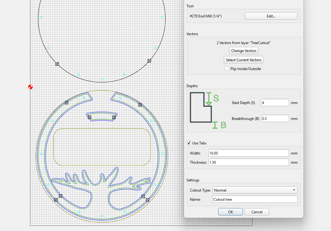

The Start Depth in the new cutout feature in V8 is not working. I can set it to any value and the simulator still starts the cutter at zero Z. G-code also doesn’t show the correct start depth. Can anyone verify this for me? So far I only have ChatGPT agreeing.
I will try it later. However we know that “ChatGPT is NEVER wrong” except when it is.
Nothing wrong with asking AI for advise but never take the answer as gospel.
ChatGPT error rates vary heavily by task, ranging from a low 5% on structured math to over 50% on complex coding and niche technical queries. Newer models reduce mistakes, but errors remain unpredictable because the AI presents wrong information with total confidence.
I was just playing around in V8 with cut out start depth. You’re correct, no matter what start depth you choose, it seems to start at 0 based on the simulation. I did not check G Code.
I did also notice that if you choose a start depth greater than 0, the breakthrough doesn’t “break through” in the simulation. However it works if start depth is set to zero. Not sure if this helps or not.

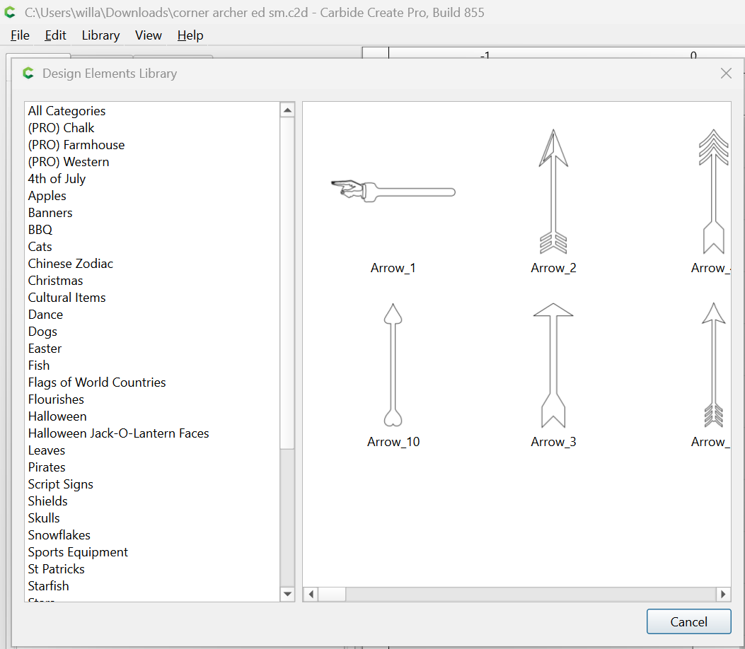

It was mentioned in another thread, but we posted an update yesterday that should fix a couple of bugs in the Cutout toolpath. Carbide Create Beta Downloads | Carbide 3D
I am downloading the beta version as I write this. I had went back to v853 because the library was missing in 854.
I primarily use bottom of material for almost every job I run. You should always measure your material carefully but even if you are not accurate you wont cut through the bottom of your material and scar up your spoilboard. The spoilboard is just that and is intended to get spoiled and replaced periodically but not having your spoilboard all scared up increases the length of time before replacement. Frankly replacing the spoilboard is a pain. Doable but a pain.
Library is back in 855:

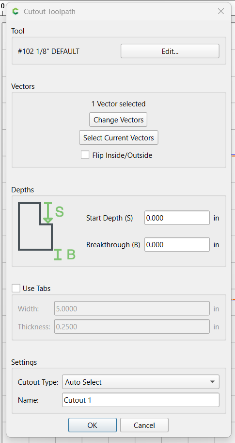

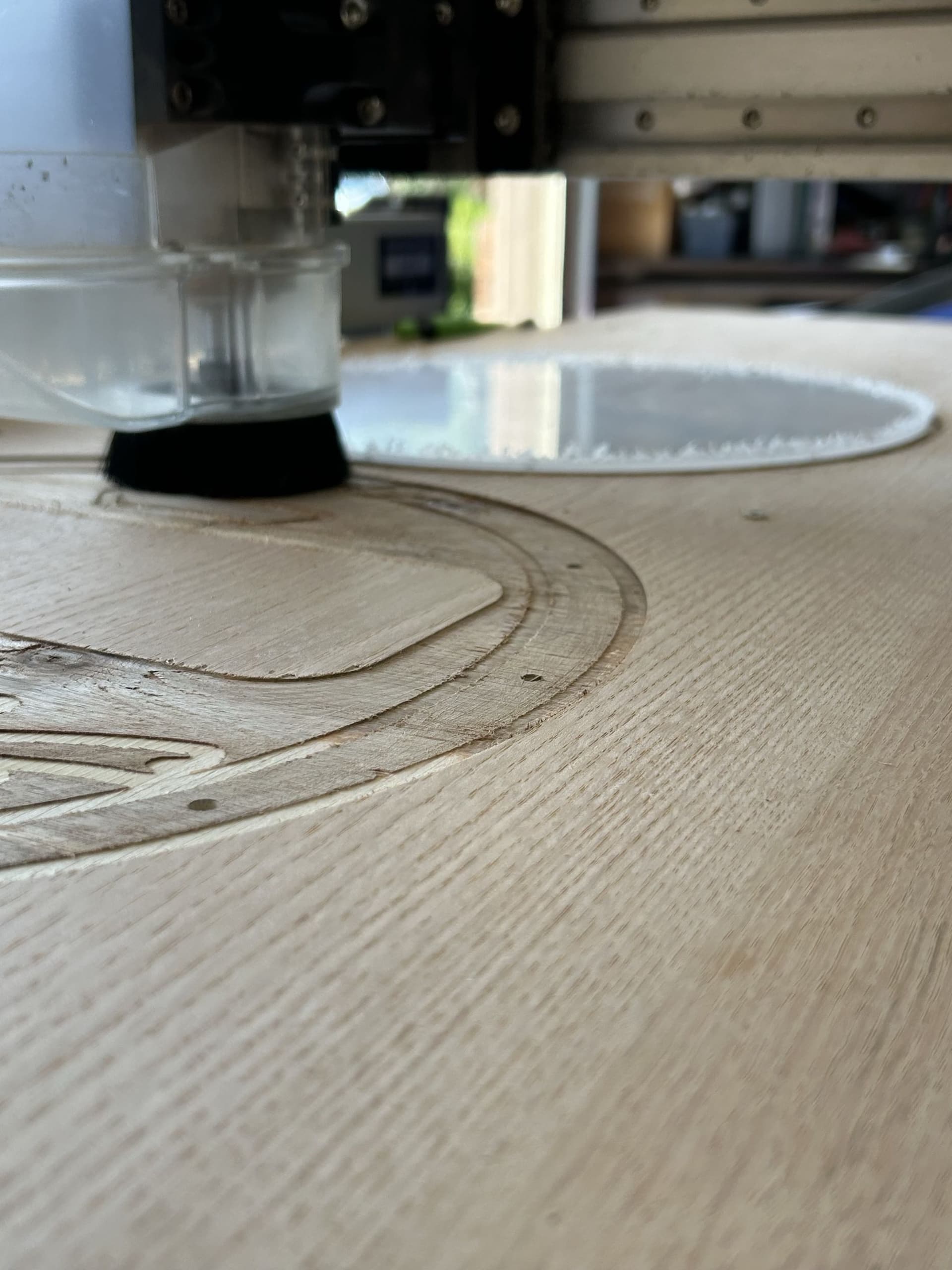

also found over the weekend that trying to use the start depth of the cutout does not work. I had to cut some acrylic and plywood and decided to just tape everything together. the acrylic was only covering the top circle so the bottom geometry is where I tried to have the lower start depth so I wasnt spending time aircutting.
which left me with this. (picture was at 99% final path for the gcode)
