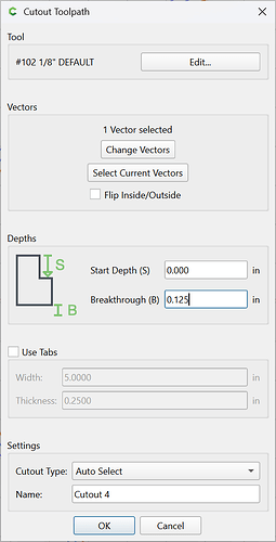

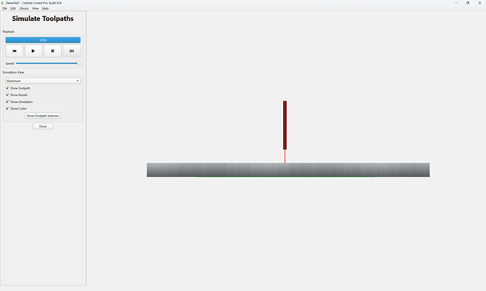

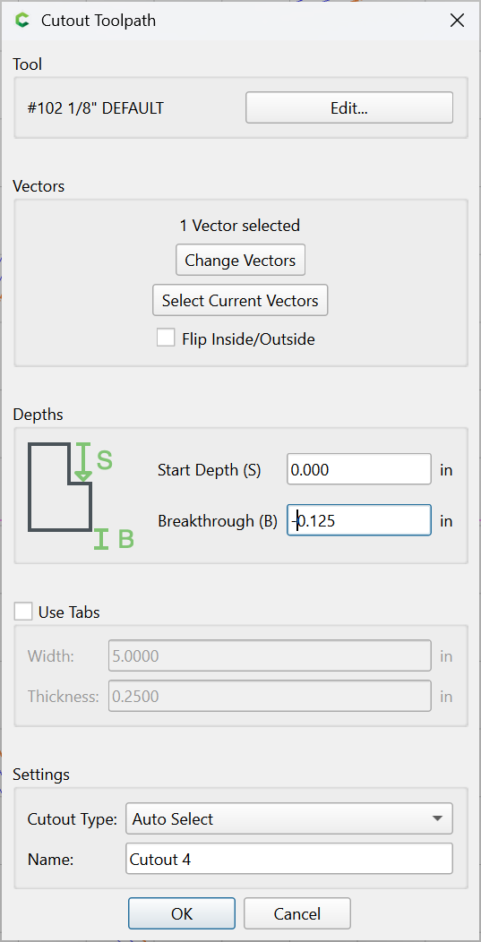

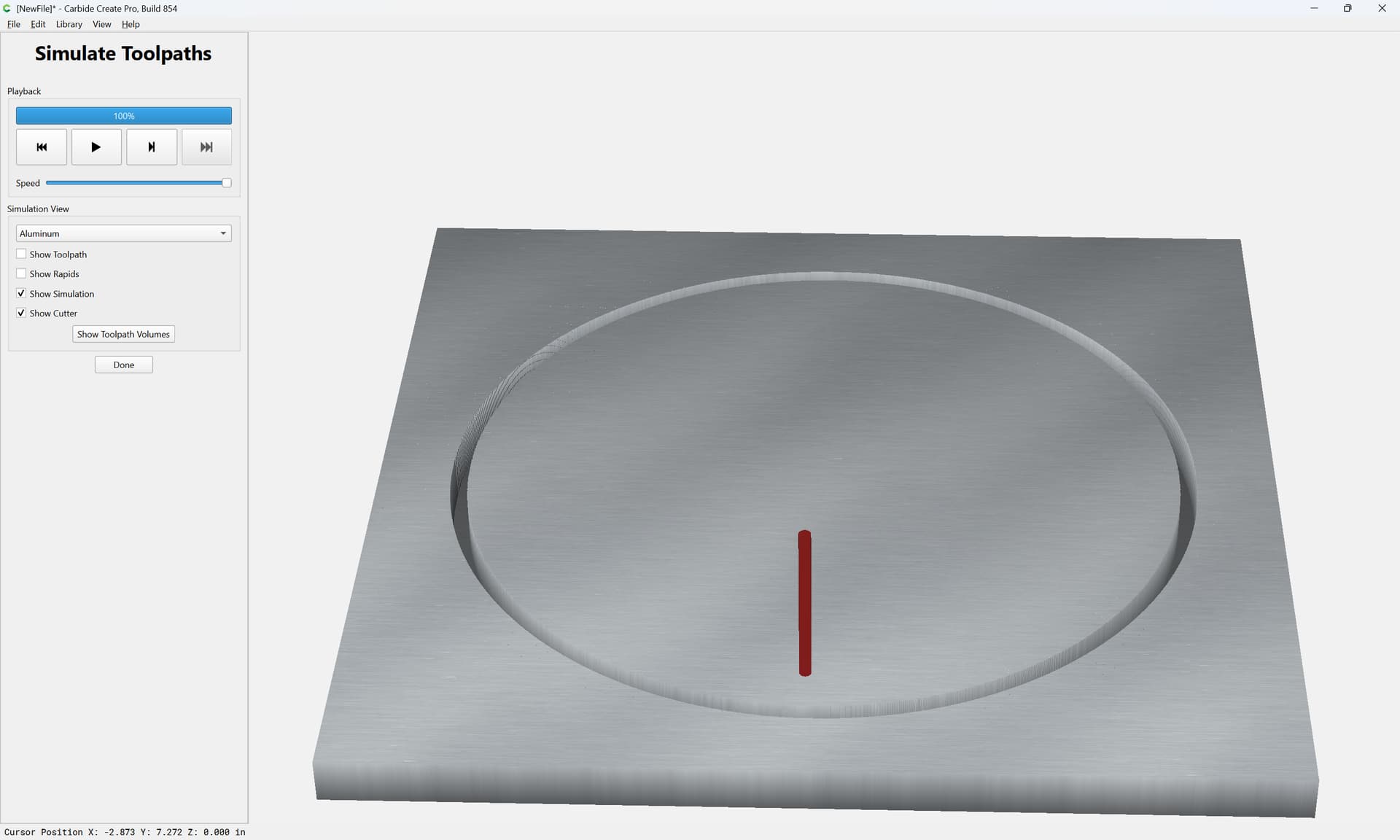

Cutout toolpath testing
Breakthrough is how much additional depth is cut away (positive)
or how much is left uncut (negative):
