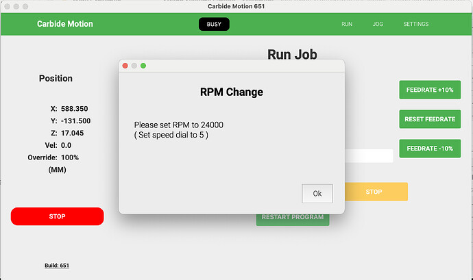

Cutter speed bug in Carbide Motion

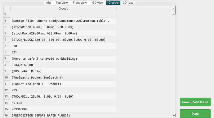

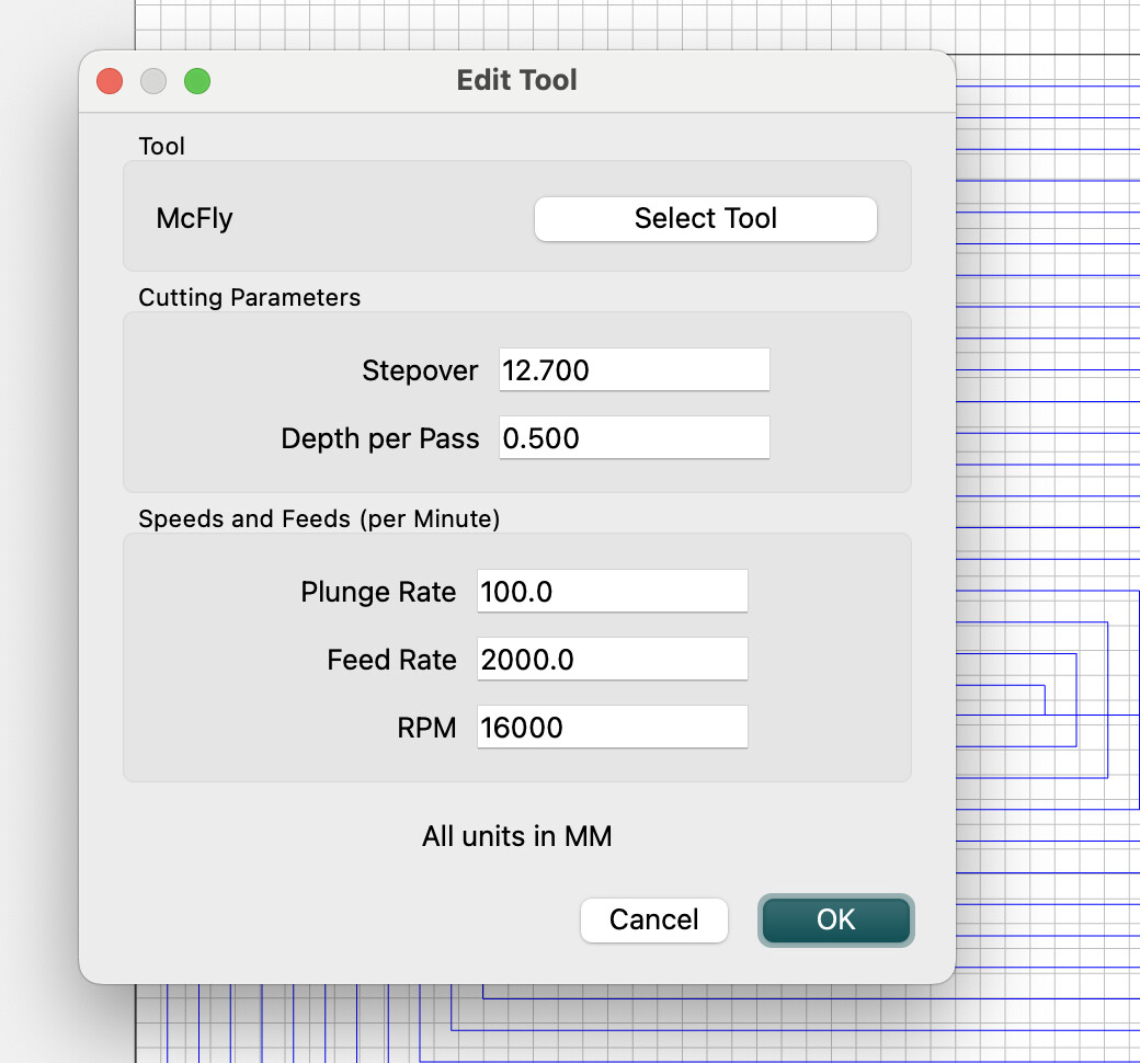

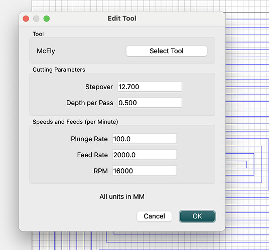

I have set the speed in Carbide Create to 16,000

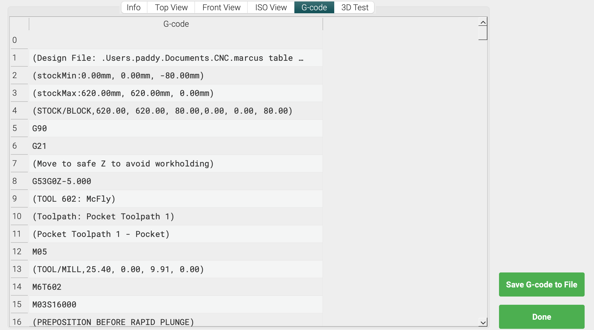

I can see 16000 in the gcode, but Carbid Motion reports 24,000
This problem has been reported in the last few versions of CM. C3D should fix it but the good news is you know what speed you want and CC is writing the code to set it. It is annoying to see the 24000 RPM but I just ignore it at this point. For a new user that changes to 24000 rpm it could be bad. So @robgrz please fix this problem before something bad happens. Seems like a major safety issue that should be addressed.
