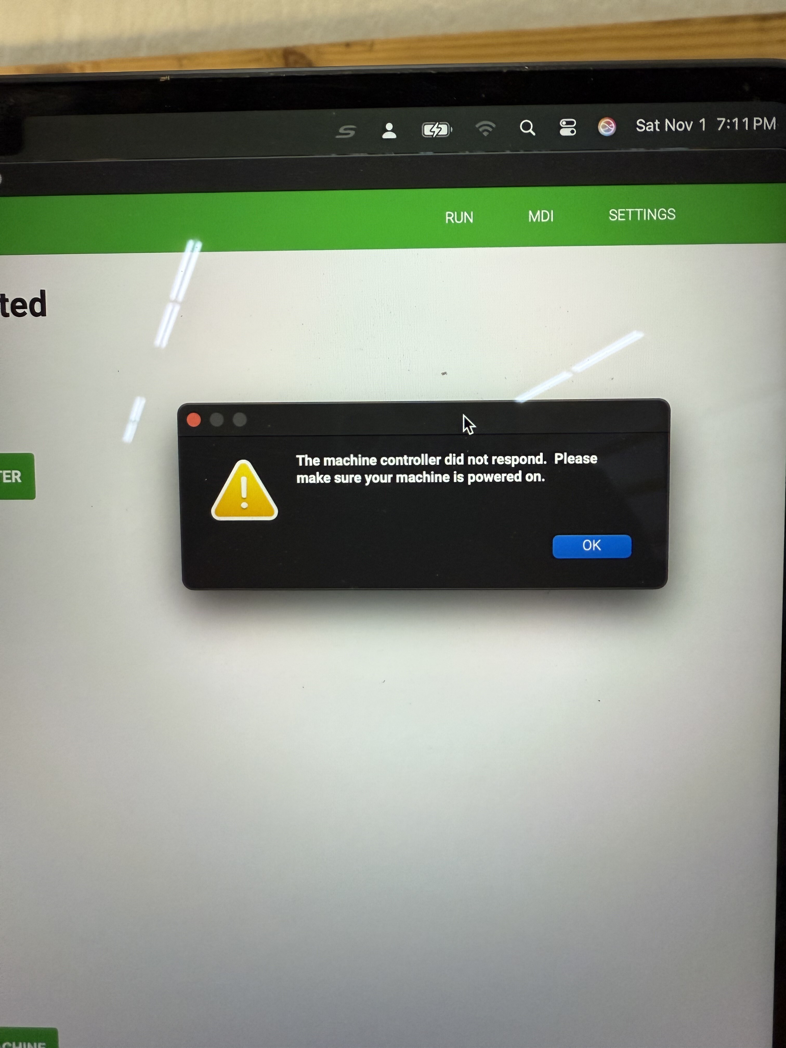

Have gotten the message “cutter stop responding” in the middle or first hour or so of a 6 hour. Then have had to start the v carve over watching it go over what it’s all ready cut to get caught up.
5 pro 4x4
Gotten the message with and with out shop vac hose hooked up.
After the error message i get the connect to cutter box. Click it and start the process over. Or I get “the machine controller did not respond. Please make sure your machine is powered on”

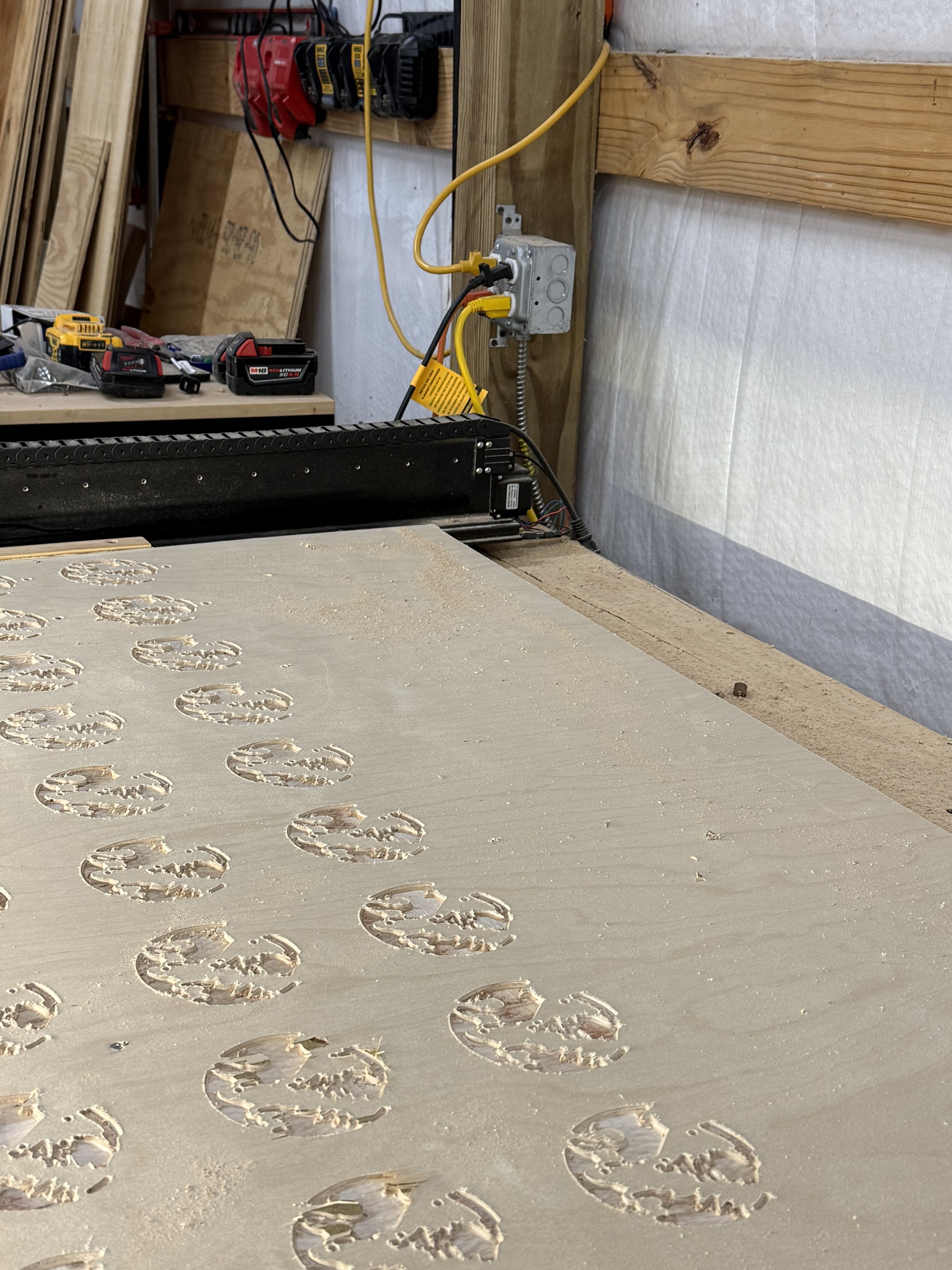

Is being so close to an electric outlet an issue?
I have taken off the vac and vac brush off the spindle and we are a hour and half in retracing. With a 60. No errors yet
It shouldn’t be, if things are wired properly.

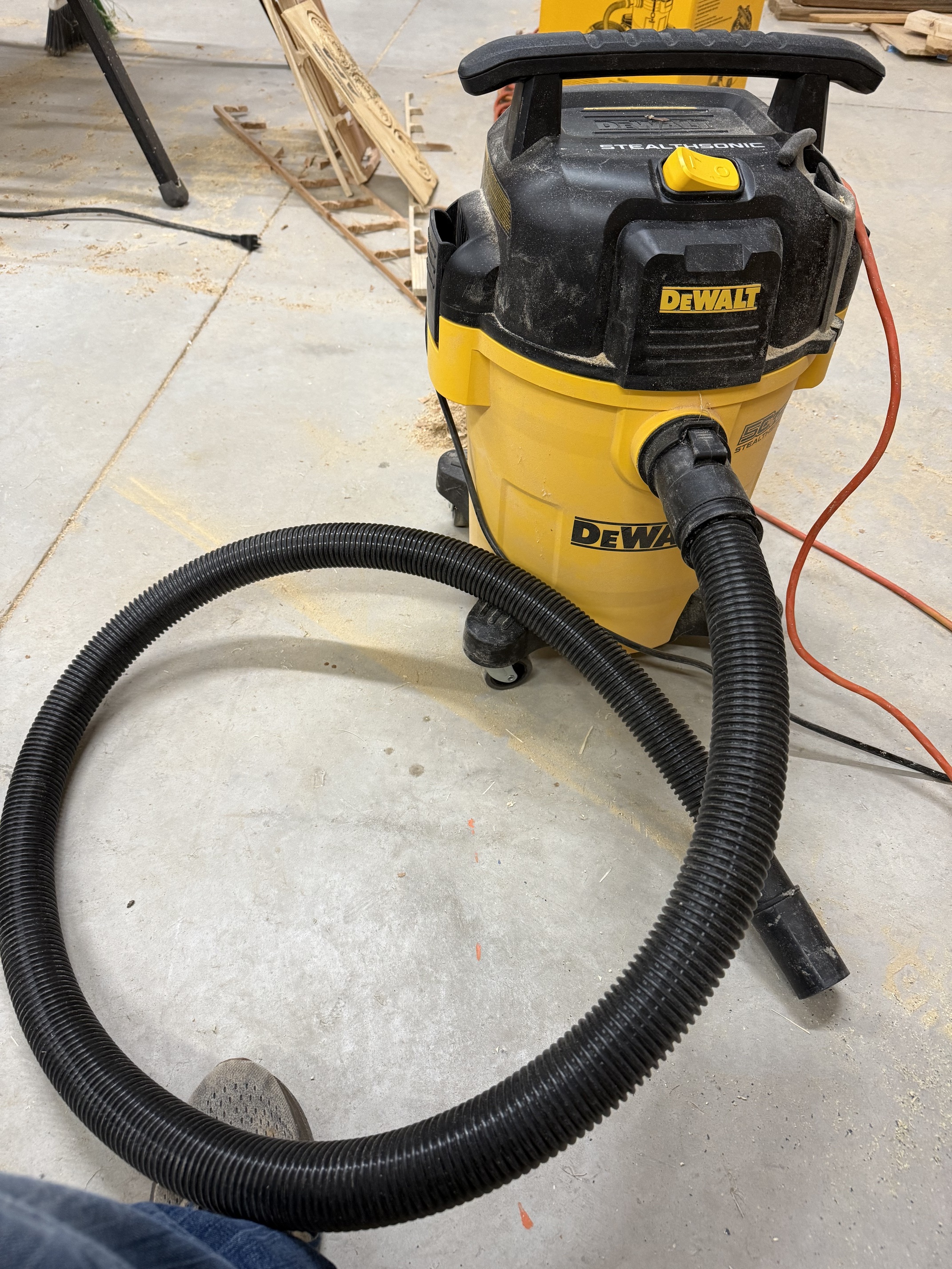

I guess to need ground vac hose anybody know how to do that???
How you ground the hose depends on how it’s constructed. Post a picture of the hose you are using.
Been using a dewalt 6 gallon shop vac. Plastic and more plastic. Sounds like an upgrade recommendation is coming. lol.

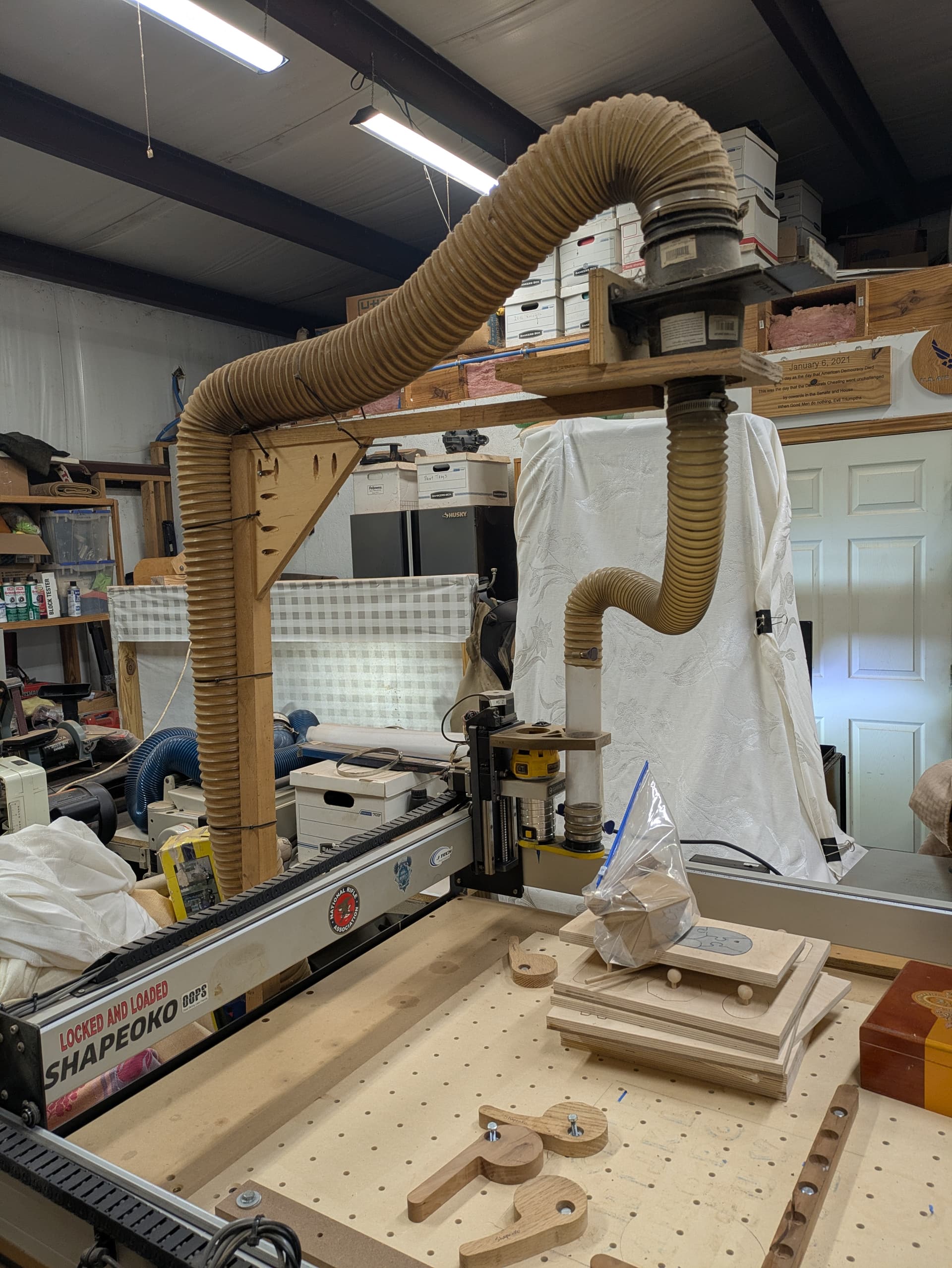

Have a 4inch hose system but have not routed it to the cnc not sure how to hang the hose above it and reduce it down to correct size.
If you decide to use the 4" system, you can get adaptors and 2.5" hose.
On my system, I have 4" going to a 4" blast gate. From there I use a 4"->2.5" adaptor, and run that to the machine. On the end of the hose is another adaptor for hose to the sweepy. It’s the same size as ‘standard’ larger wet-dry vacs use.

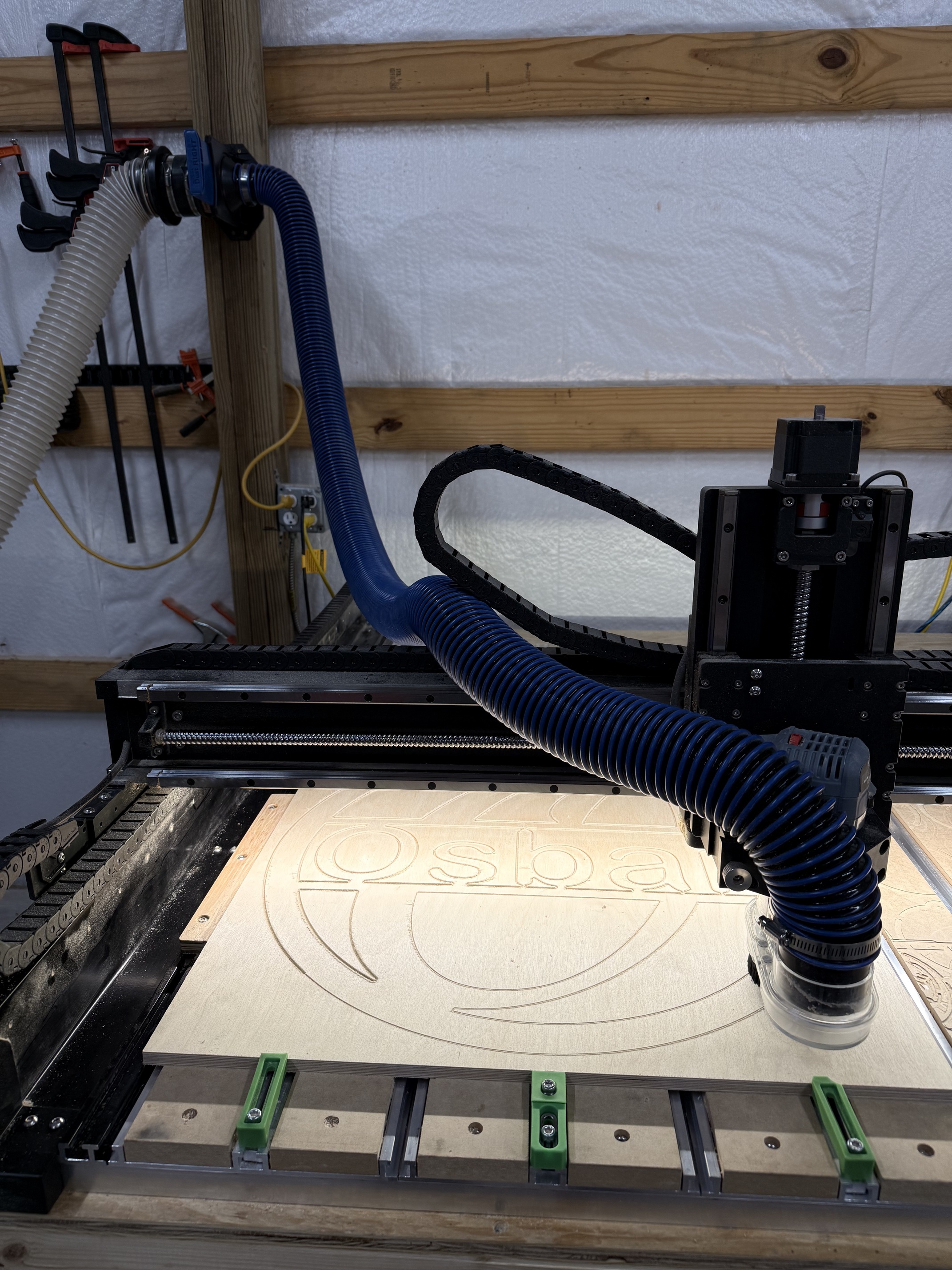

The hose I use is wire-wound for support. To ground it I just connected the wire to a ground, done.

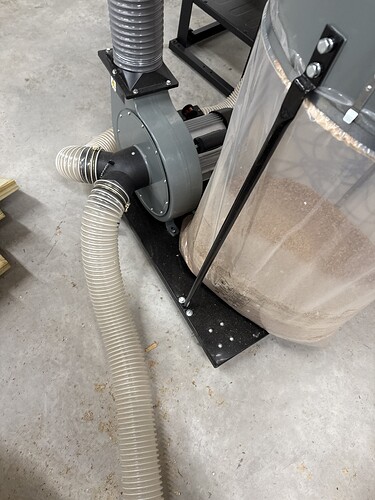

Hopefully fix my disconnects anti static hose hook up to my dust collector, no more shop vac
I rigged this up 5+6 years ago and never revisited it because it works. I have a Jet dust collector.
