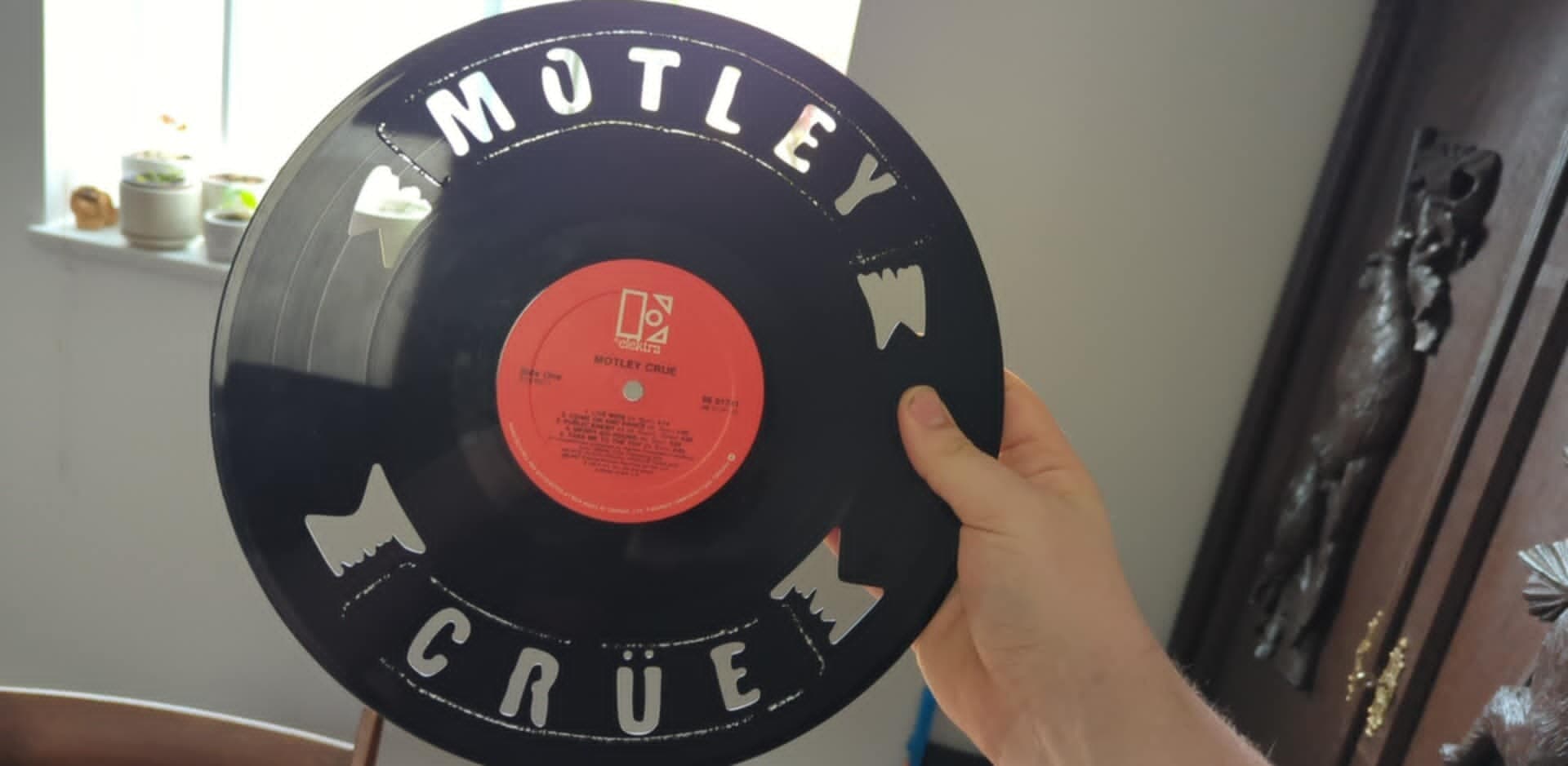

First attempt with a 1/8" O flute at Mike’s recommended feeds and speeds. Zero melting, good size chips. Tape was a nightmare but kept all of the cuts in place so as to not get caught in the sweepy and begin melting. (definitely didn’t stick my fingers in there to make sure.)
Edit: Going to try the next one pocketed and see if we release any fancy gas or if this is a tried and true method all around so I can reduce fixturing time and mess by skipping the tape.
That is (was) a great album! :metal: :nerd_face: :metal:
You might be disheartened when you see the Motley Crue 1982 too fast for love album I do next…
My wife may shed a tear if she were to see that one, but I’m good with it being out of circulation LOL

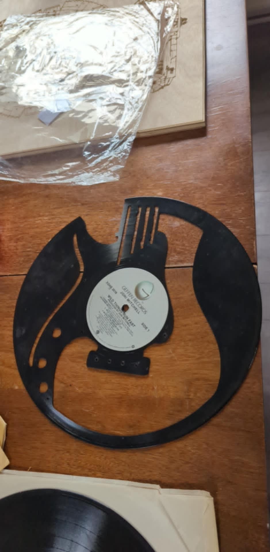

pretty coool. I tried it with nothing securing it and I have minor regrets but for the amount of workholding that went into it and requiring no cleanup? Worth.

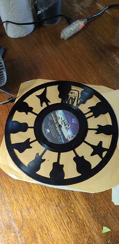

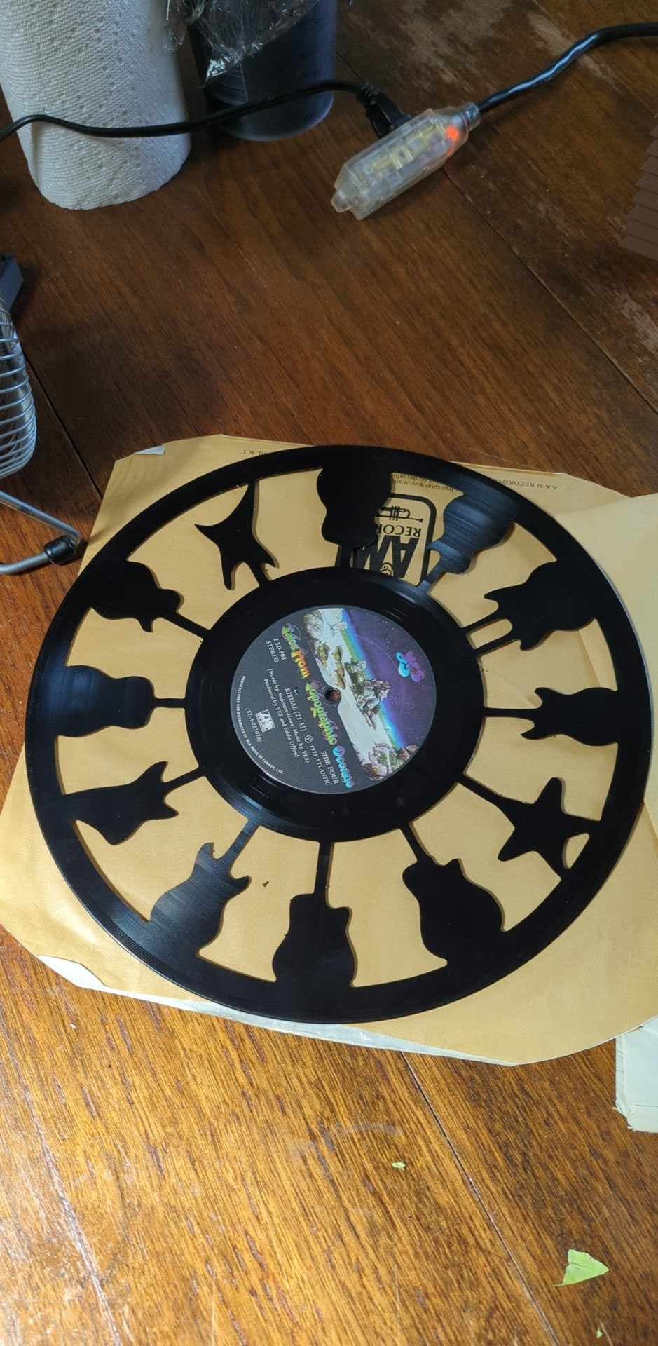

Done for the day. It’s a cheap medium for sure if you don’t use fancy records.
Also the one above was backwards and the text was inline with the bass strings
*I knew the ribbon would end up like this as I only had a 2 flute downcut endmill it was requested anyways
