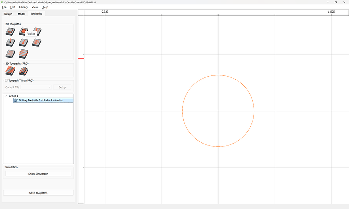

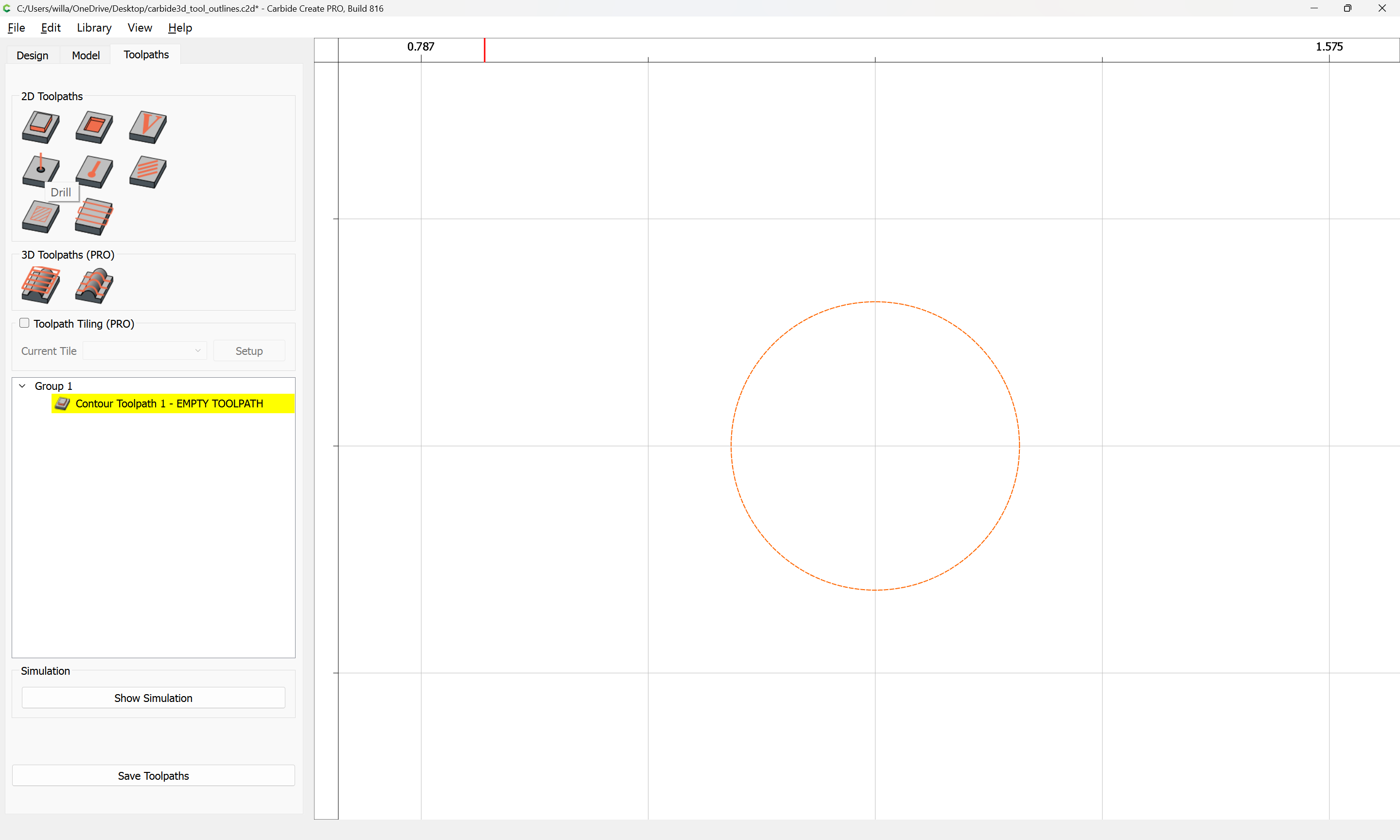

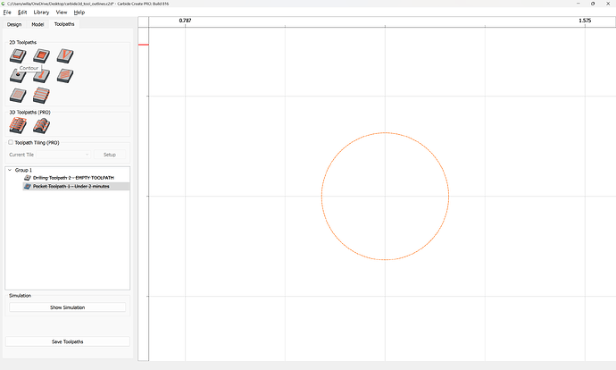

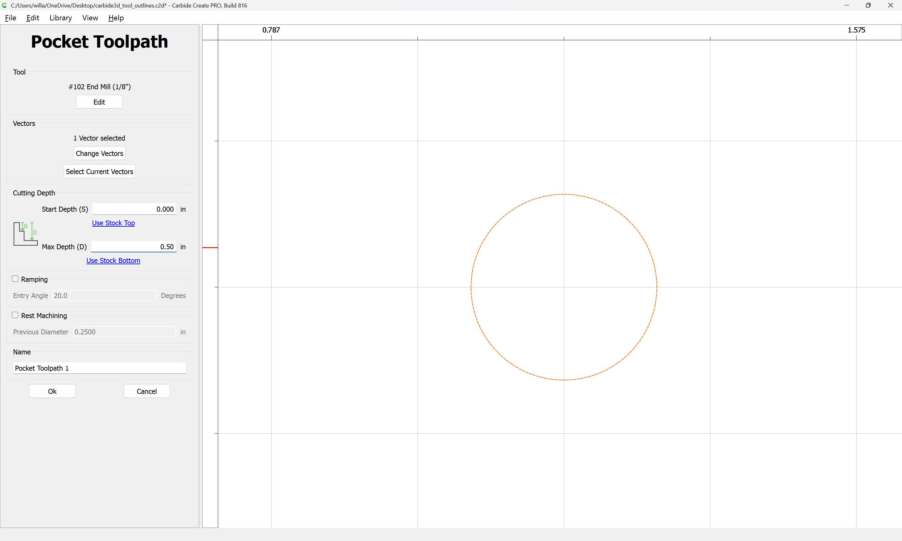

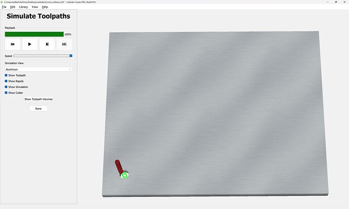

What size tool are you using?

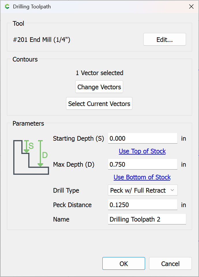

If a 1/4" tool, then you should use a Drill toolpath:

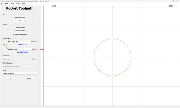

If a smaller tool, then machine as a pocket:

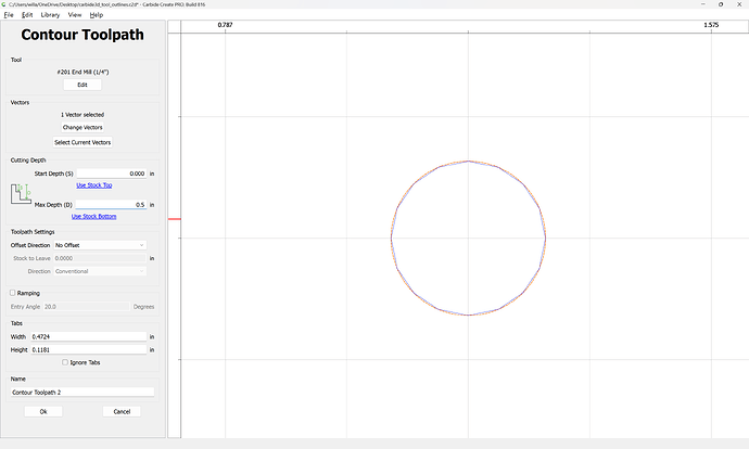

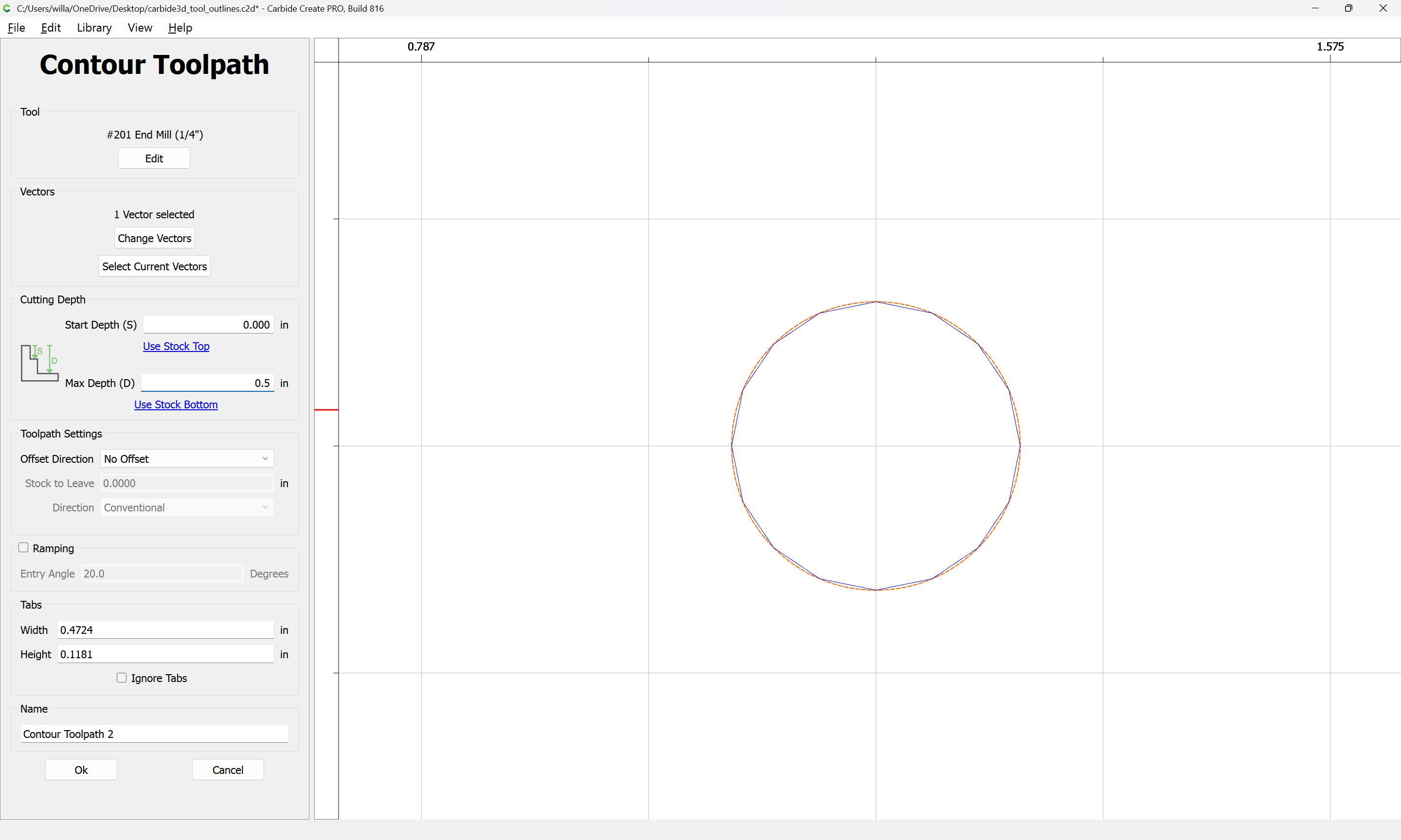

However, you should not cut as a No Offset Contour:
which will result in a 1/2" hole.

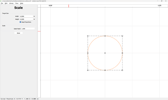

And just to say it out loud…the circle option asks for radius not diameter
I can’t tell you how many times I’ve accidentally made a circle twice as large as expected because of this :sweat_smile:
