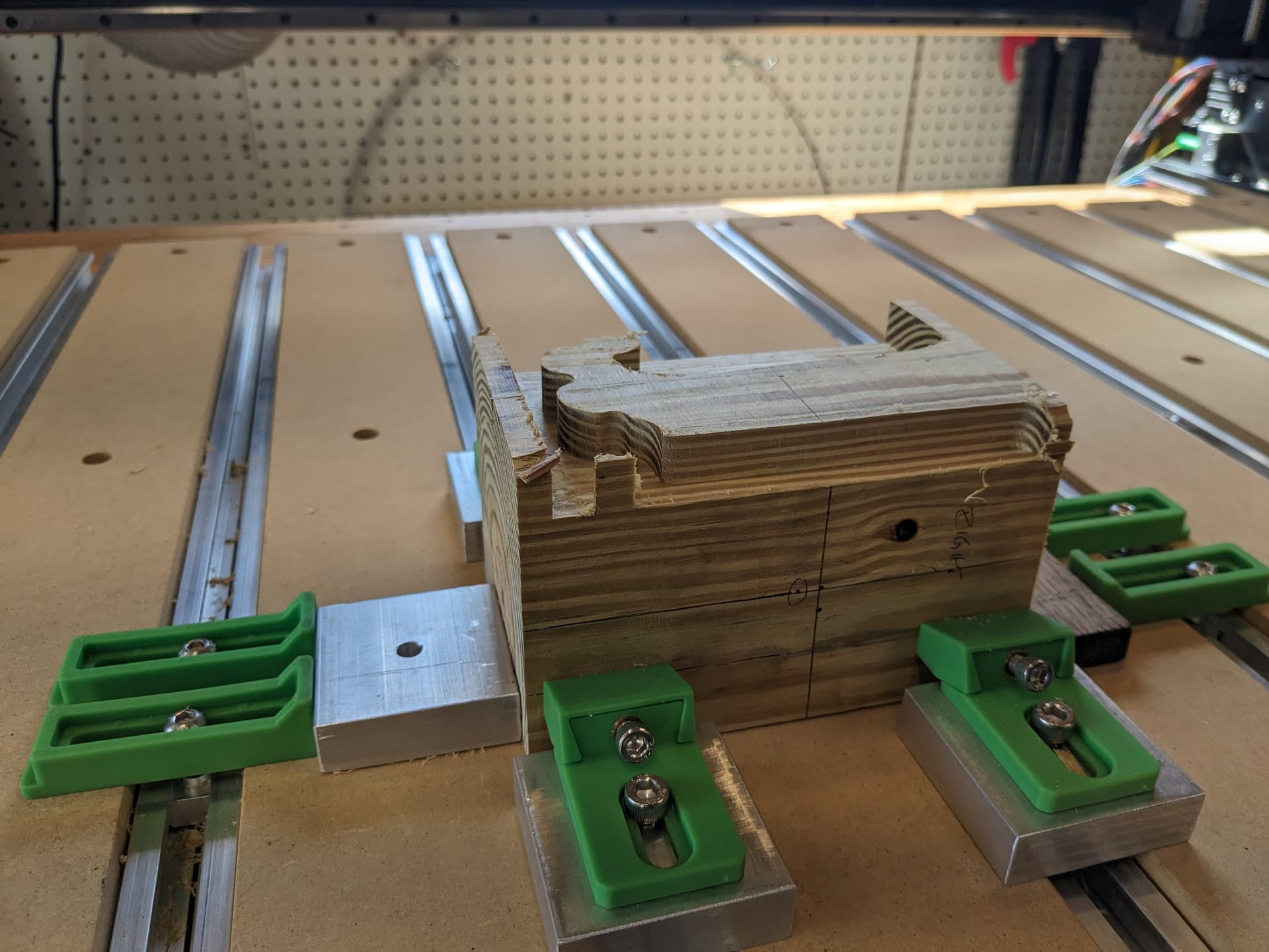

I am holding the 4x4 like this.
I noticed the part rocking a bit, so I slowed the feedrate to %50 to stop the stock from moving as much.

I think I need a better clamping arrangement.
I will machining 4 sides and the top, so re-justification of the part will be an experiment.

I squared it up @ 3.375 to clean surfaces on a bandsaw.
Cut ends as well .
I may make aluminum end plates and screw them on before milling. The would steady the clamping surface.
The part is just under 4.5" tall. I was intending to have a 1/2 of shelf on both ends to hang onto, but I set the stock to 5.5", but forgot the 1/4 cutter width so the shelf is only 1/4 wide. I will restart a new piece of stock.
I will cut the top shelf before milling.
I have to mill the top in two paths, in order to clear Router and have enough reach.
Then cut off the bottom shelf.
Too many hours in and learning a lot !
Those plastic clamps are convenient, but for tall material, the Tiger clamps are what would really help.
Or the new Crush-It clamps.
If the clamping surface was higher it would help. I noticed a major change putting 5/8 aluminum under the standard clamp.
I had not checked the Tiger clamp, thanks. I will check the new Crush it clamps.
Toe Clamps are available at MCS or McMaster, but finding a 1/4-20 /6 mm version is limited. The rest are overkill. An aluminum version would work.

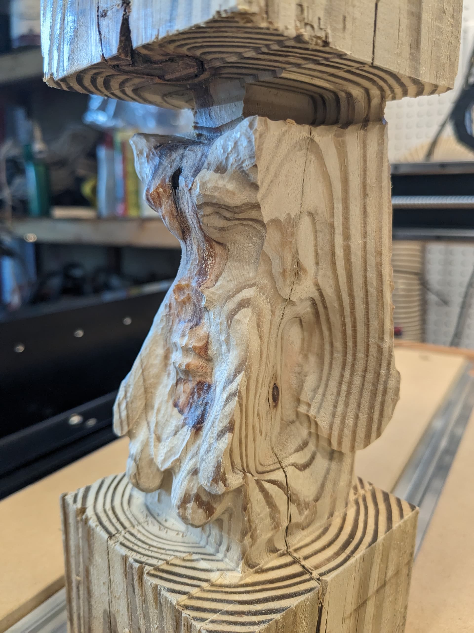

Update: 4 sides completed. Top is the next trick.
Of course I pick stock with a branch inside.
@Tod1d is correct, I found my bandsaw does not cut flat enough, so I had to plane the sides.
I also need to be more careful on the ends being square.
I reduced the DOC to 3/8" to reduce the lateral movement.
I think the top will have to run shallow, it will be 5" off the table.

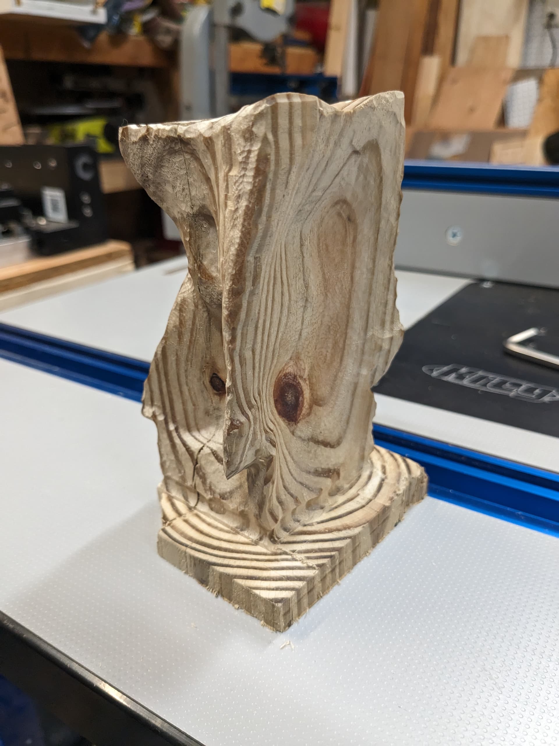

This experiment is complete.
Correct except for a bit of overcut due to alignment issues.
Learned to watch , stop reset Zeros, restart.
6 Setups ( Front/Back and Sides and two for the Top ( Front and back ).
A lot of path generation time. I need to learn to script Fusion.
One first pass for the Top Front I ran the part over with the Gantry going to set the bit, I had placed the part about 6" front the South edge. Moved the part to the max South edge, much better
The 1/4 ball end mill cleaned the surface ( No leaving material )1/8 ball end mill ( again leaving no material ) put the texture of the “stone” back into the part after the 1/4 ball end mill pass.
I never realized the effect of busy grain on visually recognizing detail.
