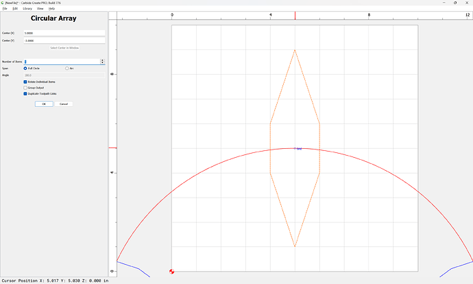

Given the need to cut out a design for aerating a lawn:
one would draw up the basic design by first setting up the file:
Then use the polyline tool to draw up a pair of opposing points:
Then use the Circular Array tool to make as many duplicates as desired:
“Select Center in Window”
click where the center should be:
If need be, adjust the various parameters, OK.
Use Boolean Union:
to join things together:
