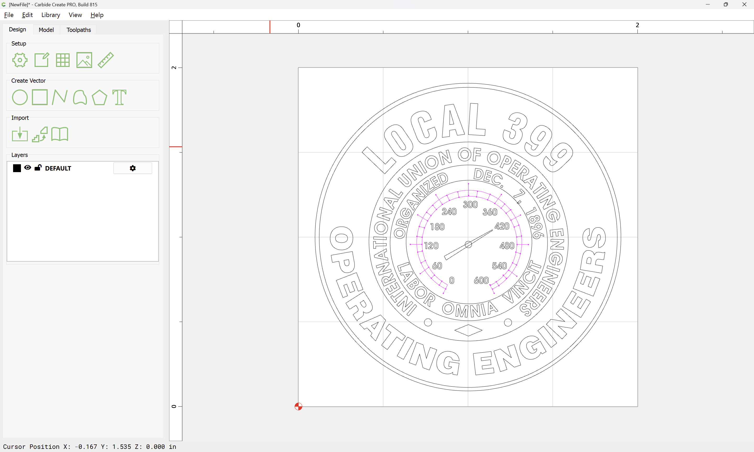

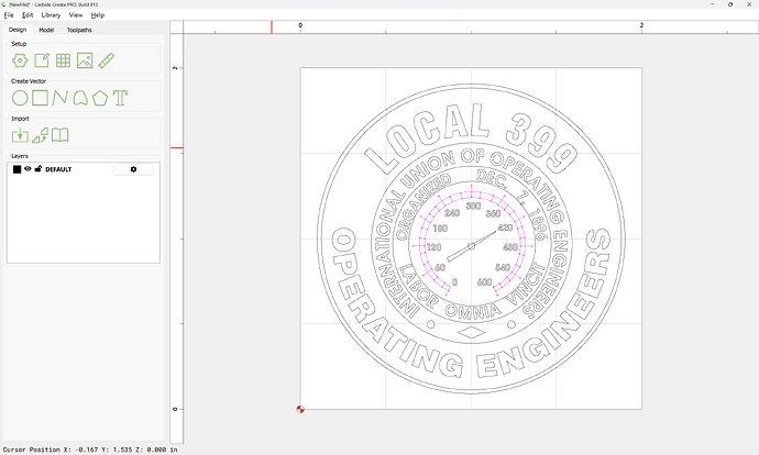

Hello, I’m having an issue with a project I’m attempting to make. This image, I’ve tried uploading as an svg file and it then prompts that I can only trace it since some of the properties aren’t compatible. Any tips on how to get this image to come in clear on the create software?

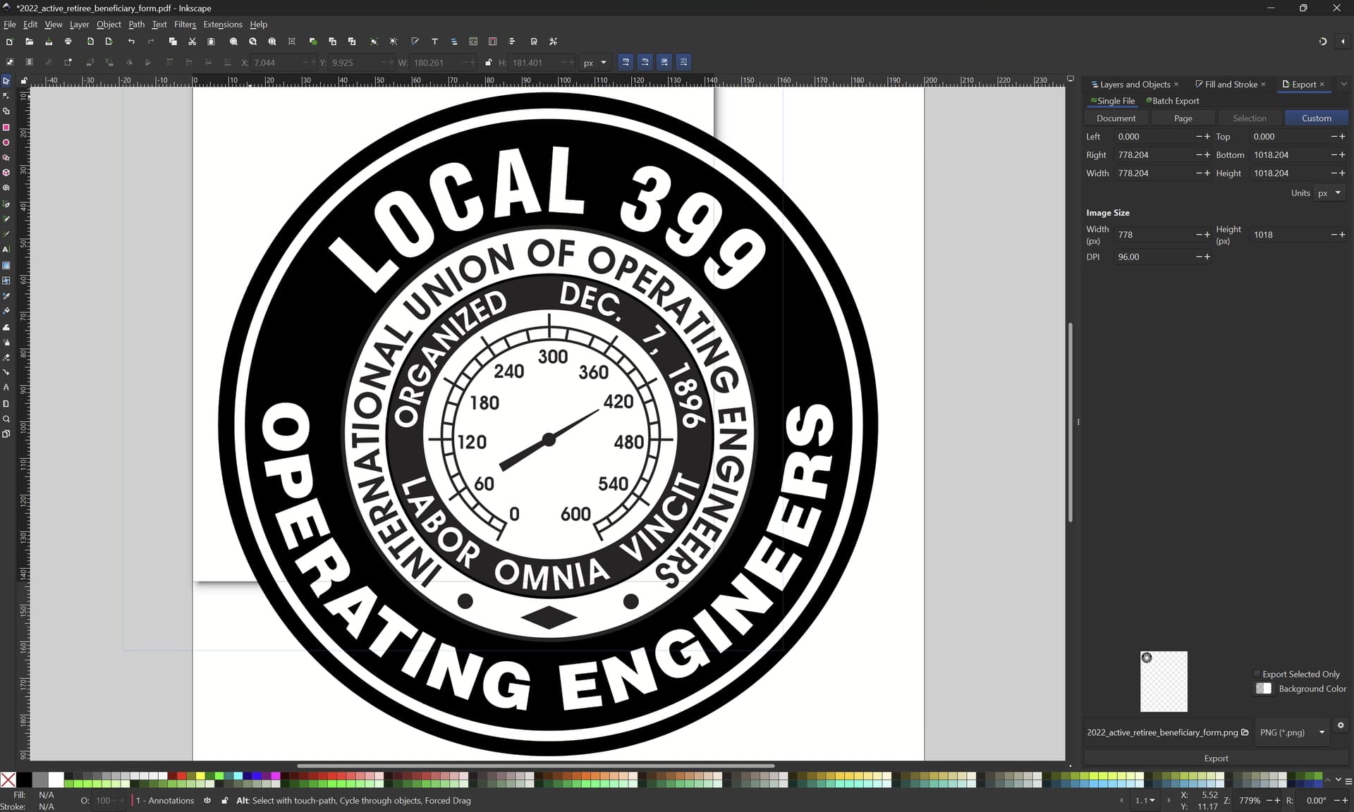

The solution is to source a good quality vector image — fortunately, the site:
https://www.iuoe399.org/
is replete with such vectors, so it is a simple matter to get a file which when loaded into a suitable vector editor:
may be re-saved as an SVG:
local_399
which loads as expected into Carbide Create:
