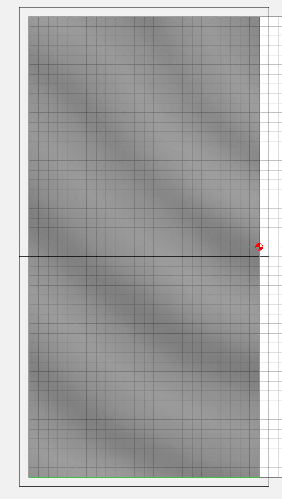

Could you set it up like this, like you’re doing manual tiling? Create a boundary (black) for each tile, and a 3D path for each. You’d have to keep track of the zero corners. The second tile in this one the lower left corner would be X0 Y20…
