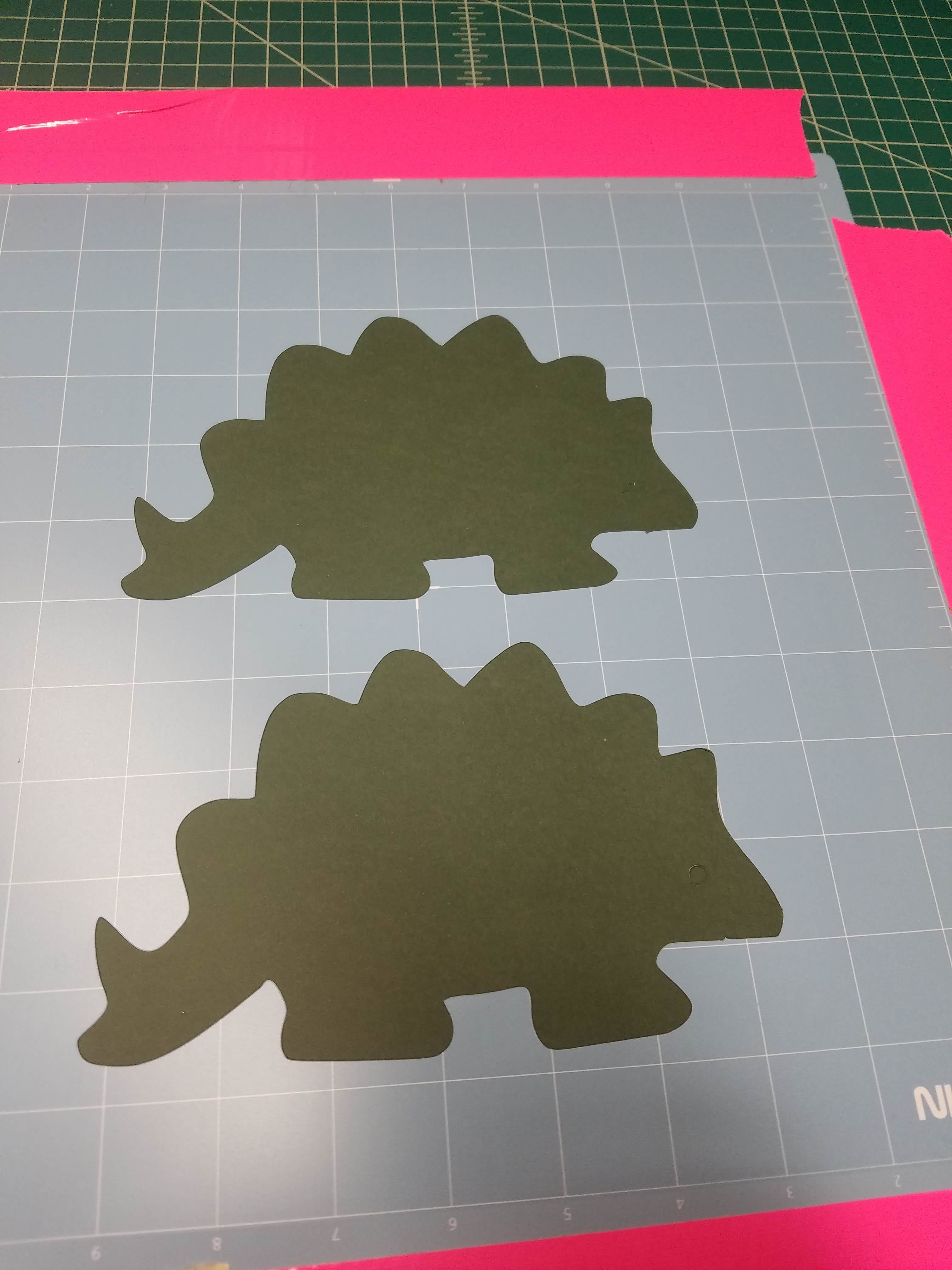

We are having a party for my daughters first birthday and my wife wanted some dinosaur decorations cut from cardstock. My sister has a cricut, but the dino cartridge for it was $100. I purchased this vinyl cutter on amazon
I drilled out the top nut to 1/4 and superglued a snapped off 1/4 drill bit to chuck it in the makita. It cuts fairly well on the large shapes.

How did you do you cad/cam setup?
Did you consider making a drag knife?
https://wiki.shapeoko.com/index.php/Spindle_Overview#Drag_Knives
The cricut cutter addon linked in the wiki is actually where i got this idea.
I have a friend with aspire that created the dragknife gcode from the files I sent him.
