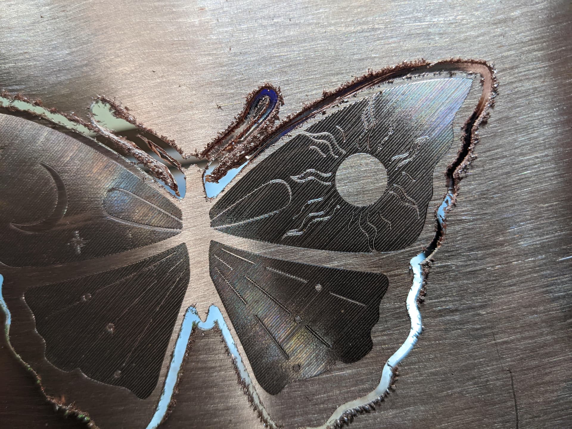

I did a test a while back on a thin-ish copper sheet for someone.
Decent results from the 1/16th endmill with a stepover of .118 inches and depth per pass of .006 inches.
Plunge of 6 inches and feedrate of 10 inches with 24000 rpm.
This was done on the nomad though.
Sheet was .04 inches thick
Winston has a few videos that I referenced (probably stole the feeds/speeds entirely):
You should be able to hit those numbers with the shapeoko 3.
One thing I found is the edges looked a bit rough. I think I either sanded it down after cutting things out or maybe ran a very small depth contour pass with no offset.
The antenna features were too small, so they ended up not surviving well.
This was quite a while ago (a bit over a year ago), so I don’t recall any other specifics.
