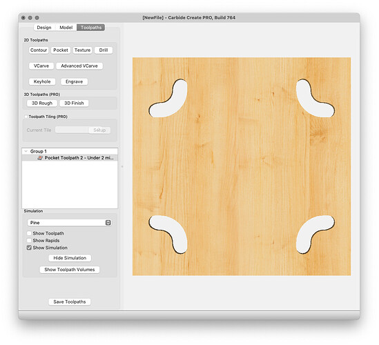

New here. I created a sign out of 3/4” red oak for my second project. Happy with the sign, but now would like to fillet corners from sign. How do I cut off only the corners without having a tool path around complete stock? I don’t know how to create just these four individual tool passes. Then I would like to create an inside outline of entire sign 1/4” from edge. Hope this makes sense

Draw a rectangle with the desired corner treatment:
Offset to the outside by tool diameter plus 10%:
Apply
Draw in a square which isolates one of the corners using ctrl (or command on a Mac):
Then use that square to draw a larger one:
centered on the corner.
Then select the original rectangle and duplicate it, then select it, and the offset geometry and the larger square:
and use the “Trim Vectors” command to isolate what you wish to cut:
If need be, use Node Edit to delete anything which won’t delete:
Done
Select the open geometry which isolates where one wishes to cut.
and use “Join Vector” to close it:
Yes
Apply a suitable toolpath:
and verify the cut:
Then duplicate the geometry 3 times:
and use the Mirror or Rotate tool(s) to adjust each for orientation:
and drag each into position:
using a Node to snap against the original rectangle.
Attached as a v7 file.

Can also do this using Boolean Subtraction, with no Node Editing.
Start with the desired profile:
Offset buy bit width + ~10% (I used .300)
Draw a rectangle than covers the top and bottom portions you
don’t want:
Select the inner boundary, the outer bounday, and the rectangle (last!). The rectangle is now the ‘Key’ object:
Boolean Subtract:
Repeat with a horizontal rectangle:
For each corner, select the outer boundary then the inner boundary, then boolean subtract:
Repeat for each corner, then pocket each area:
You could also draw both rectangles first, Boolean Union to create a cross-like shape, then use Boolean Subtract with that.
Now treat each corner as above.
