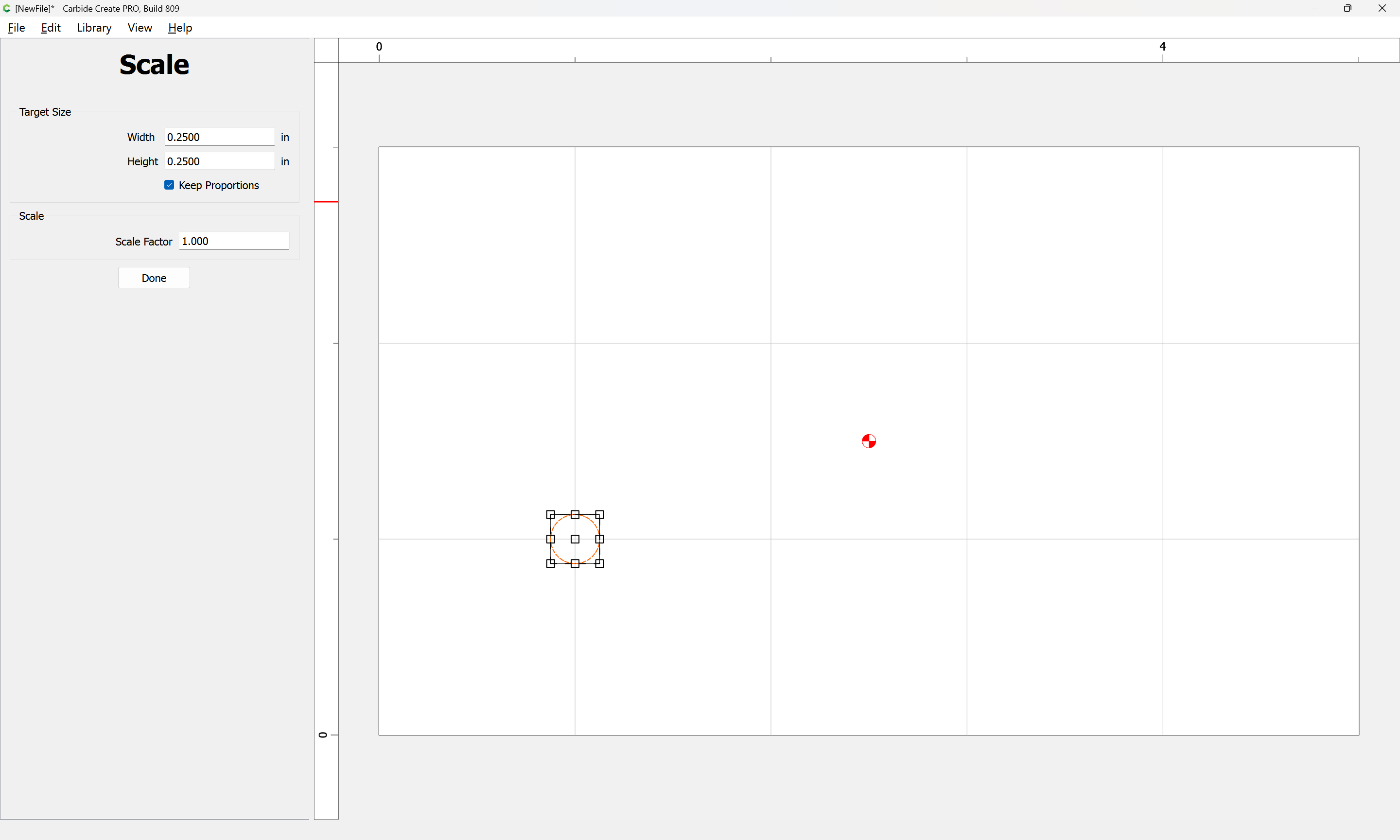

Consider a rectangle which is the desired dimension and matches the diameter of the tool being used:
and if we add some geometry to indicate the dimension:

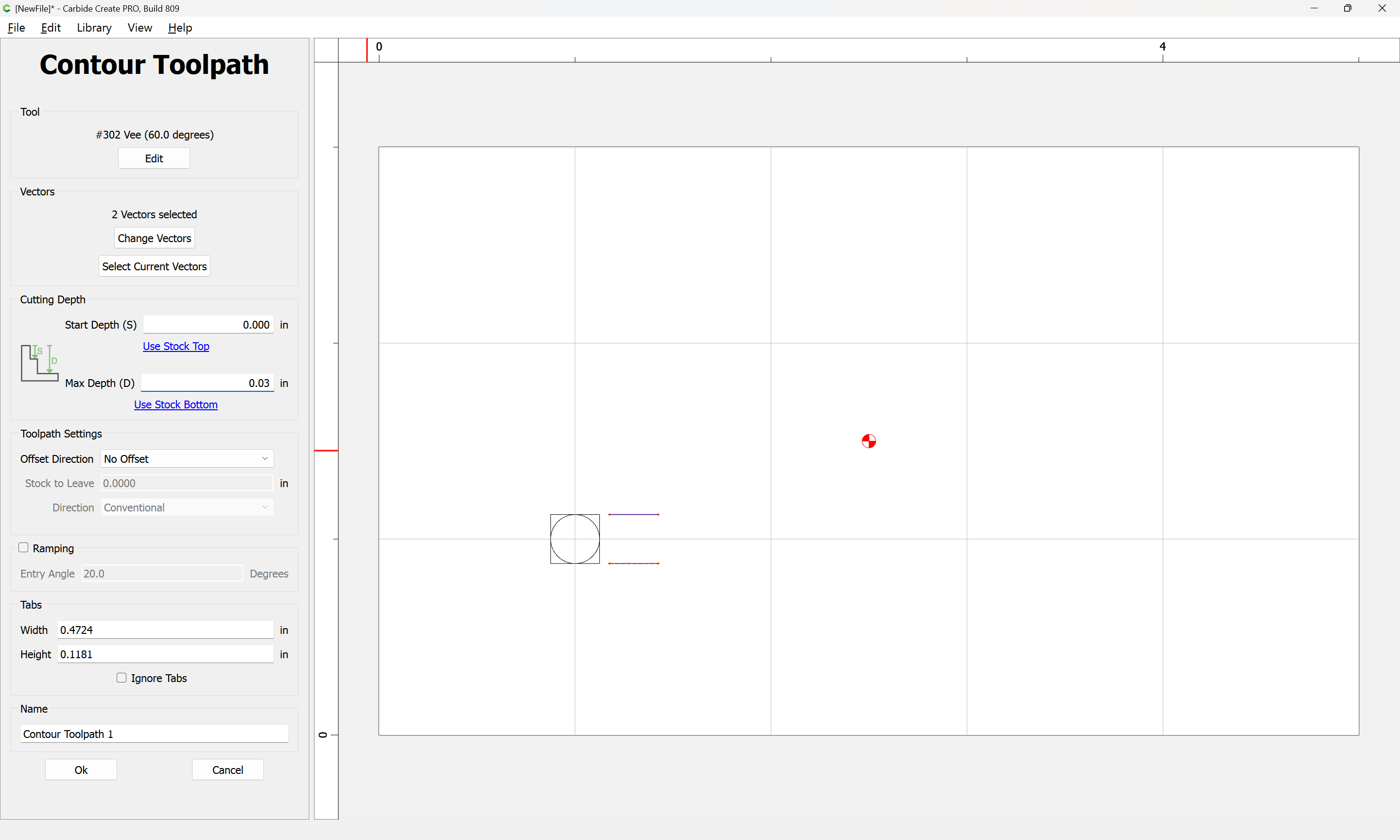

and assign toolpaths to mark that out:
We will agree that those marks are 1/4" apart?

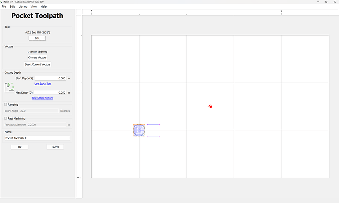

If one assigns a Pocket toolpath to the square (with a suitably small tool which will fit in it):
we will agree that that is also 1/4" in dimension?

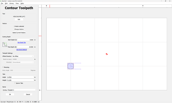

If one then selects that and assigns a No Offset Contour toolpath along the geometry with a 1/4" tool:
The cut necessarily grows by the radius of the tool:
as can be seen by moving the drawing of the tool to a corner:
drawing in additional copies at the other corners:
and filling in the interstices:
and unioning things:
which I believe we will agree if assigned a pocket toolpath would remove the same material as is removed by the No Offset Contour toolpath applied to the original square with a 1/4" tool.
