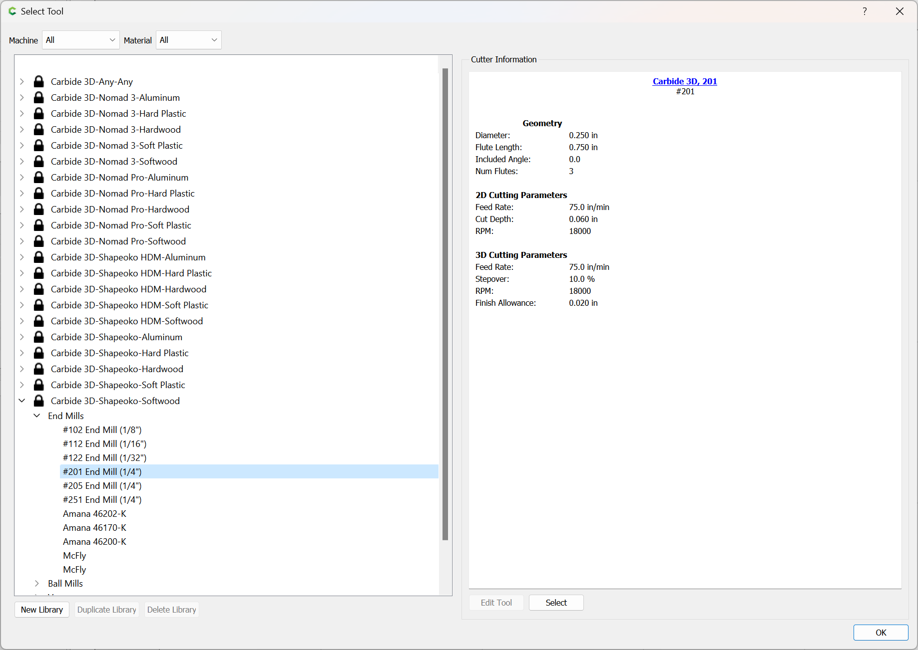

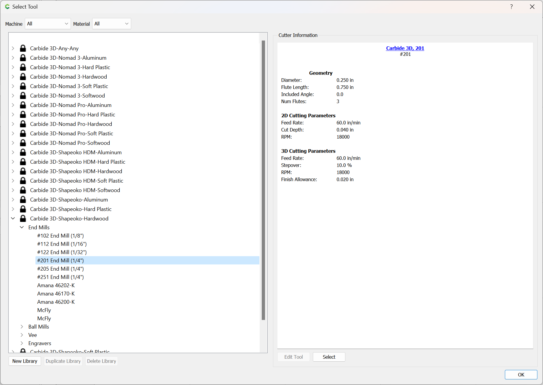

Question for you veterans might save me from some trial and error. What is the reasonable cutting depth soft wood and hardwood for a 1/4 end mill. I have a Shapeoko pro 4 i’ve been reading that a proper cutting that is one times the diameter but I don’t know if the machine can handle a 1/4 cut. Also, I find that I’m making a lot of dust and my dust collection isn’t catching it, It goes straight to my shop vac bag.
I just use the settings in Carbide Create:
and
If you want to adjust them experiment w/ feed rate override in a piece of scrap and see:

If I am understanding your question I think you want to know the maximum depth of cut for a 1/4" bit. The rule of thumb for a router is no more than half the depth of the router bit diameter. So for a 1/4" bit no more than 1/8" depth of cut. Now that is for a hand held or router table router. The Shapeoko can maybe handle 1/8" cut in softwood but hardwood would likely put stress on the whole machine. Most depth of cut is much less than 1/8 (.125") for any material in the default doc for C3D bits.
Now if you are asking for the maximum depth of a cut that is depending on the bit. Most bits have a maximum cutting depth. That is determined by the cutting tip and the flutes on the sides of the bit. When you go below the flutes often you get burning because the solid part of the bit is rubbing on the sides of a cut. So on some woods like cherry it burns quite easily. If you need to cut deeper than the flutes of a bit then you likely need a bit with more cutting depth on its flutes. I have a Melin 4" OAL 1/4" upcut bit that can cut up to 1.5". However that long bit puts a lot of stress on a trim router. The run out is much greater for a long bit and causes more vibration and can cause the collet nut to loosen.
So it depends on which machine you have. An SO5 can likely handle more aggressive doc than an SO3/4. The SO5 is ball screw driven with linear rails and the SO3/4 are belt driven and are not as rigid of a frame as the SO5. You can modify the conservative F&S of the builtin C3D tools but they are recommended for a reason. Although conservative they are likely to work for the material listed. Many CNC router bit companies give fantastic recommended F&S and are intended for industrial CNC machines and not hobby type CNC machines.
