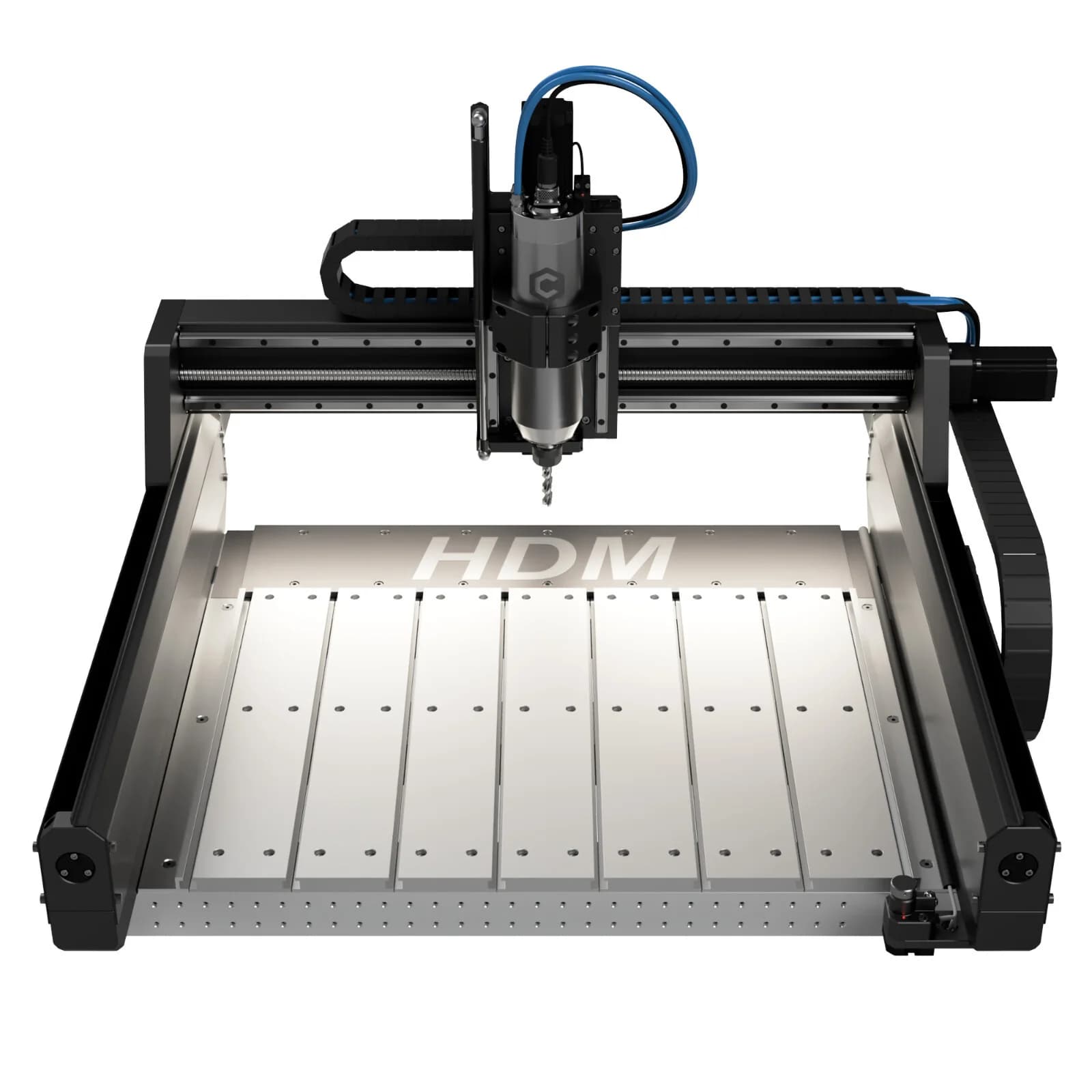

Is it possible to cut beyond the edge of the pro 5 table? For instance if I wanted to cut into the end of a board. For some reasons I feel like that is the case… but it might have been something I saw in a dream.
The Pro 5 has “Gantry Shift”. You can move the gantry forward on the Y slides so it hangs over the front edge. You can then make a fixture / clamping system to hold the boards vertically.
