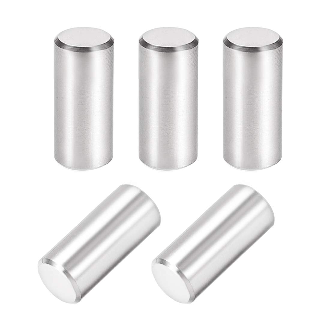

For the record, I was testing the following 8x25mm metal dowel pins:
And the following 8x25mm wooden dowels:
