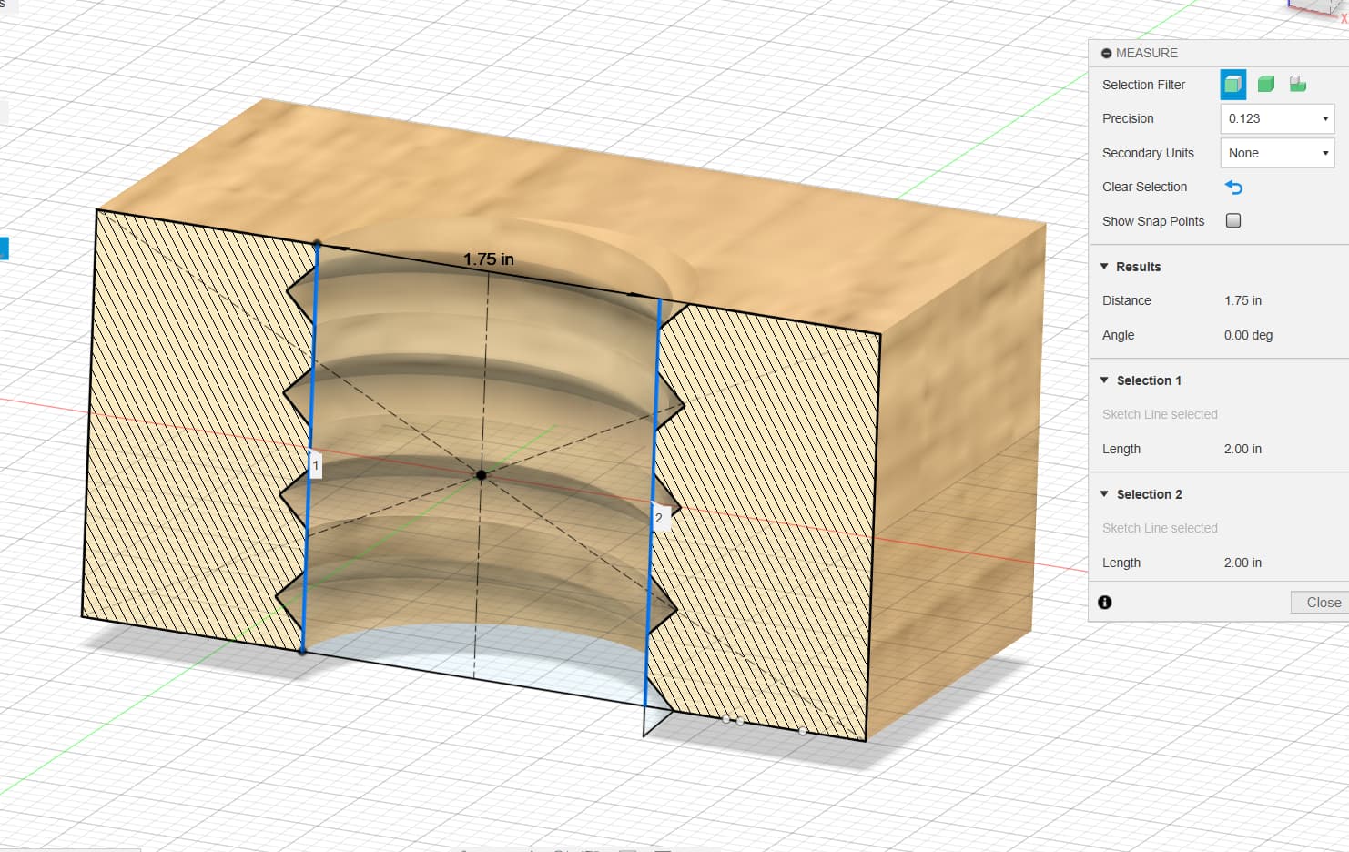

I want to make a screw/nut for a wooden vise. My thought was to use my 5 Pro and a thread mill to do the cutting. It would be a 90 degree v thread, 2tpi.

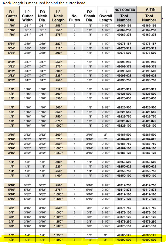

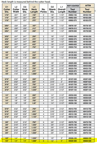

The toolpath is easy enough but I’m having a real hard time finding a bit long enough to make it down 2".

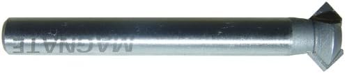

The only thing I can find is this bit from Magnate but the shank length is only 1.5".
I would need at least a 3" shank length. Does anyone with more experience than me have any suggestions where to look? I’ve searched thread mill but most of the results are for ISO threads in metal, not a 90 degree v thread.

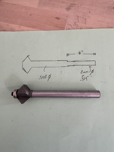

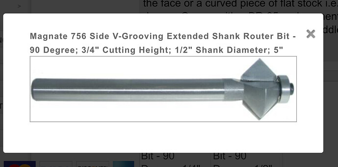

Ok I think I found a solution. Magnate makes a similar bit with a 5” length, but it has a 1/2” shank and a bearing. My spindle is a 1/4”, but I have a buddy with a lathe and he could turn it down for me. Then remove the bearing.
Thanks for checking… I’ll thought this was a slam dunk easy project, but alas…
I would suggest turning it down to 8mm (5/16") and sourcing an 8mm collet.
Roger that thanks Will.

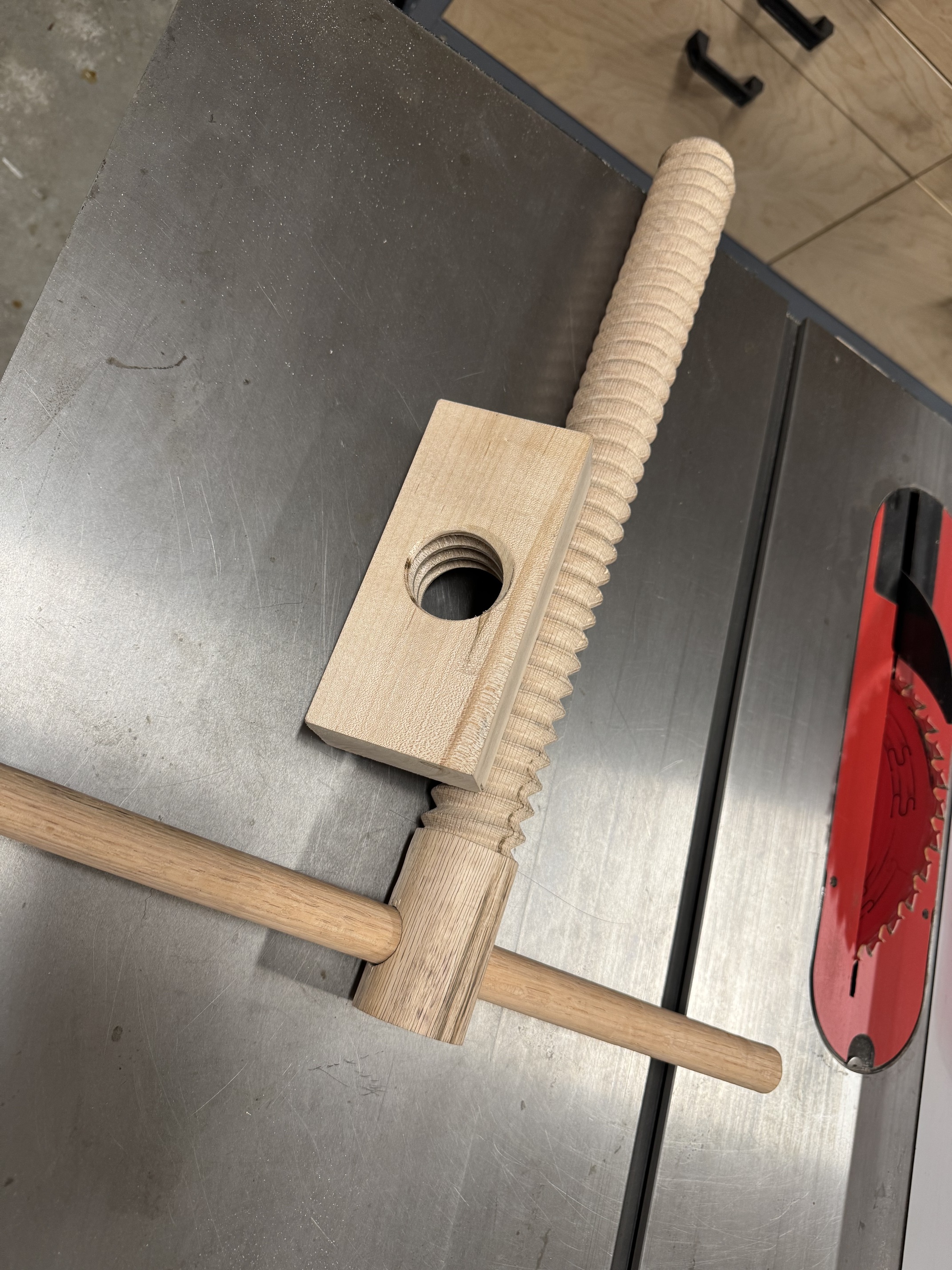

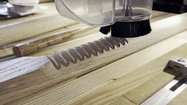

In the meantime I figured out how to cut internal threads manually and was able to do this:
But my goals are to make a 2.5 inch screw with lots of holding power. I cut the screw on the Shapeoko using 4 quadrant setups and a tapered ball mill. Just rotating 90 degrees for each setup.
Cutting:
