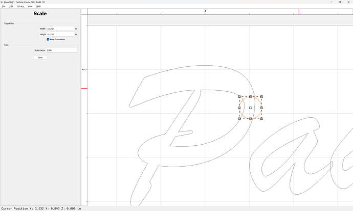

For my first toolpath I choose the interior parts of letters correct? I tried to put pic but I’m new and only allows one pic.
Then my second toolpath I highlight all things and create a toolpath for it?
When I show simulation the name doesn’t show as cutting out the name completely.
I am sure I am missing something important but that is what I need you guys for. Attaching simulation pic.

I may not have been clear but I am trying to use the cut outs on a sign. So I would like to use the actual cut out of the name and it just didn’t turn out well. The shapes cut out fine. I love that font and just need to determine the correct settings to achieve the cut out of the name. I may need to make larger.
Only if you need to edit the vectors in any way. If you are cutting the text as-is, no need to convert to curves.
Depends on how much detail you want. Round tools cannot fit into sharp corners. A 1/8" tool will leave a 1/16" radius in any sharp corner, or corner where the radius is less than 1/16".
Contour path traces the vectors you choose. I just cuts along the line, no where else. You can trace inside, outside, or right on the line (No Offset). This is the only path type you can use on open vectors (Pink / Magenta)
Since you want to cut out the letters & keep the letters, you would choose Outside. You can select the whole letter or the whole text, and it will figure out that the inside of the “P, a, l” need to be cut inside rather than outside.
One thing to consider here is the thickness of your stock. With an 1/8" cutter, I would not simply contour anything much thicker than 1/4". When you cut a slot the same width as the cutter, the cutter is “fully engaged”. That is, it’s cutting with the full diameter across the leading edge of the cutter.
As you get deeper with subsequent cuts, chips will get jammed between the tool & material, and can create enough force to exceed the force of your stepper motors to hold the tool in position. This is what’s referred to as “Losing Steps” and when it happens the tool is no longer where the machine thinks it is, and will result in a staggered slot, or multiple depth of cut that don’t line up.
When cutting thicker or harder material, it’s better to offset the vector by the diameter of the tool plus at least 10%. I usually go 25-50%. Then select both the letter & the offset & do a pocket path. Pocket removes all of the material inside the outermost selected vector. And will stop cutting at a nested vector.
