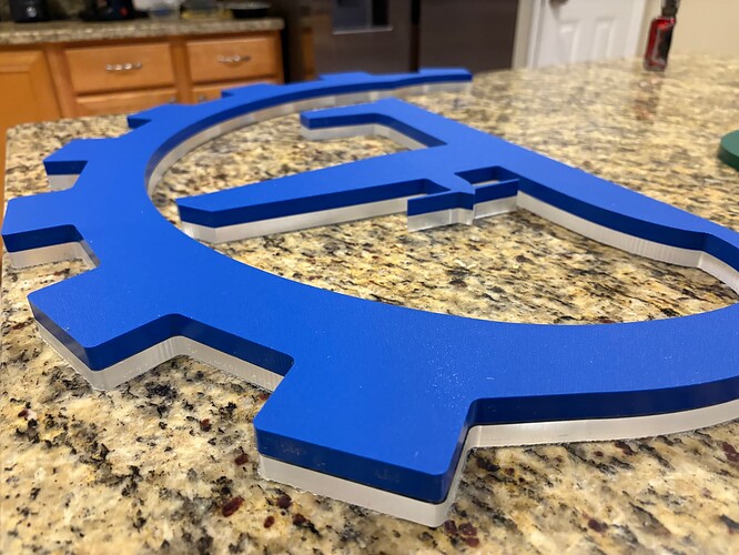

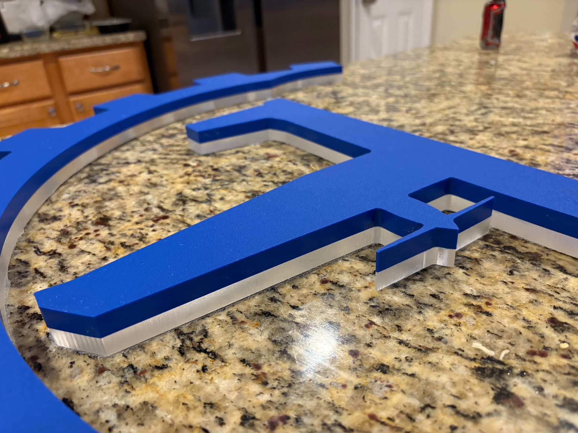

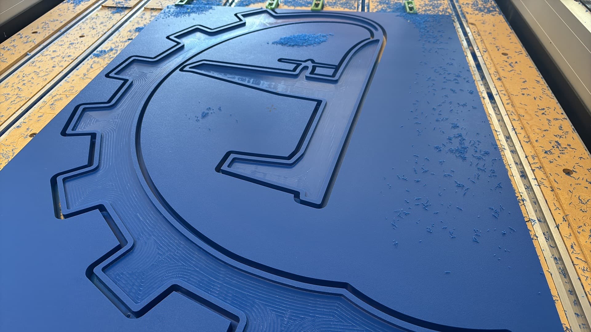

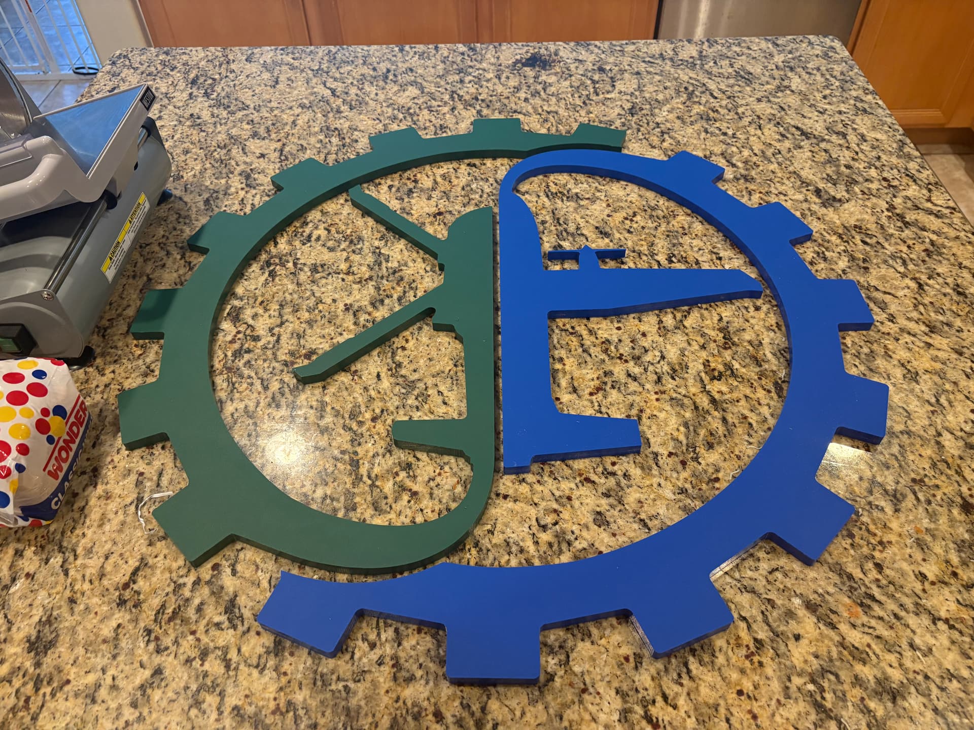

Awhile ago I posted about how to pocket the back of a piece easily. I got a bunch of creative answers but not the right one, I got it down in Vcarve then found out it has a limitation of 23 or 25 inches. So back to carbide create. And viola, playing with the toolpaths I saw offset vectors. That did it after a little experimentation

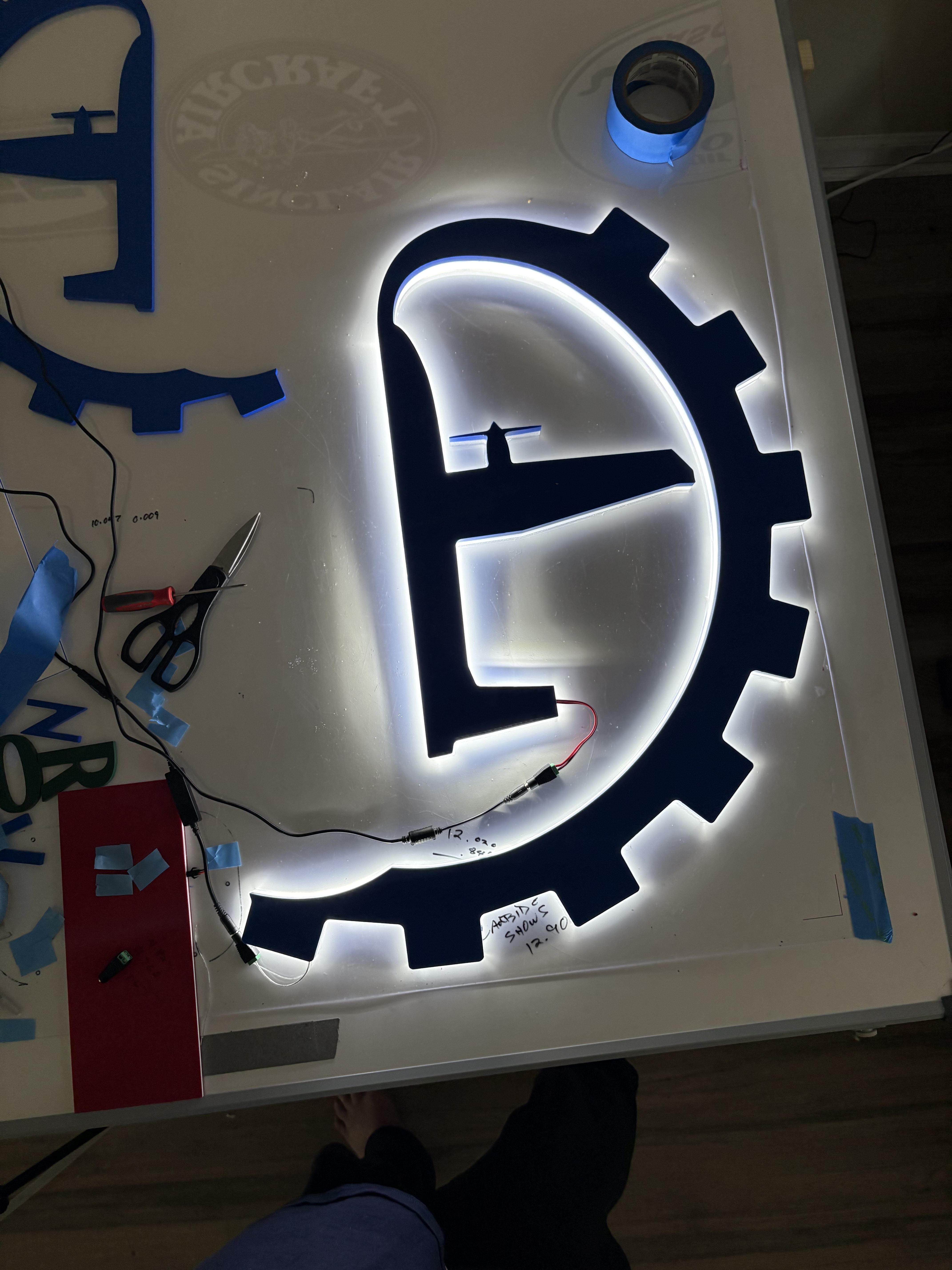

I got it down perfect. This was my intent. Now Ill glue in the LED’s facing down in the pocket and light the bottom piece of lexan, giving an amazing backlit silhouette look.
Pretty cool project!

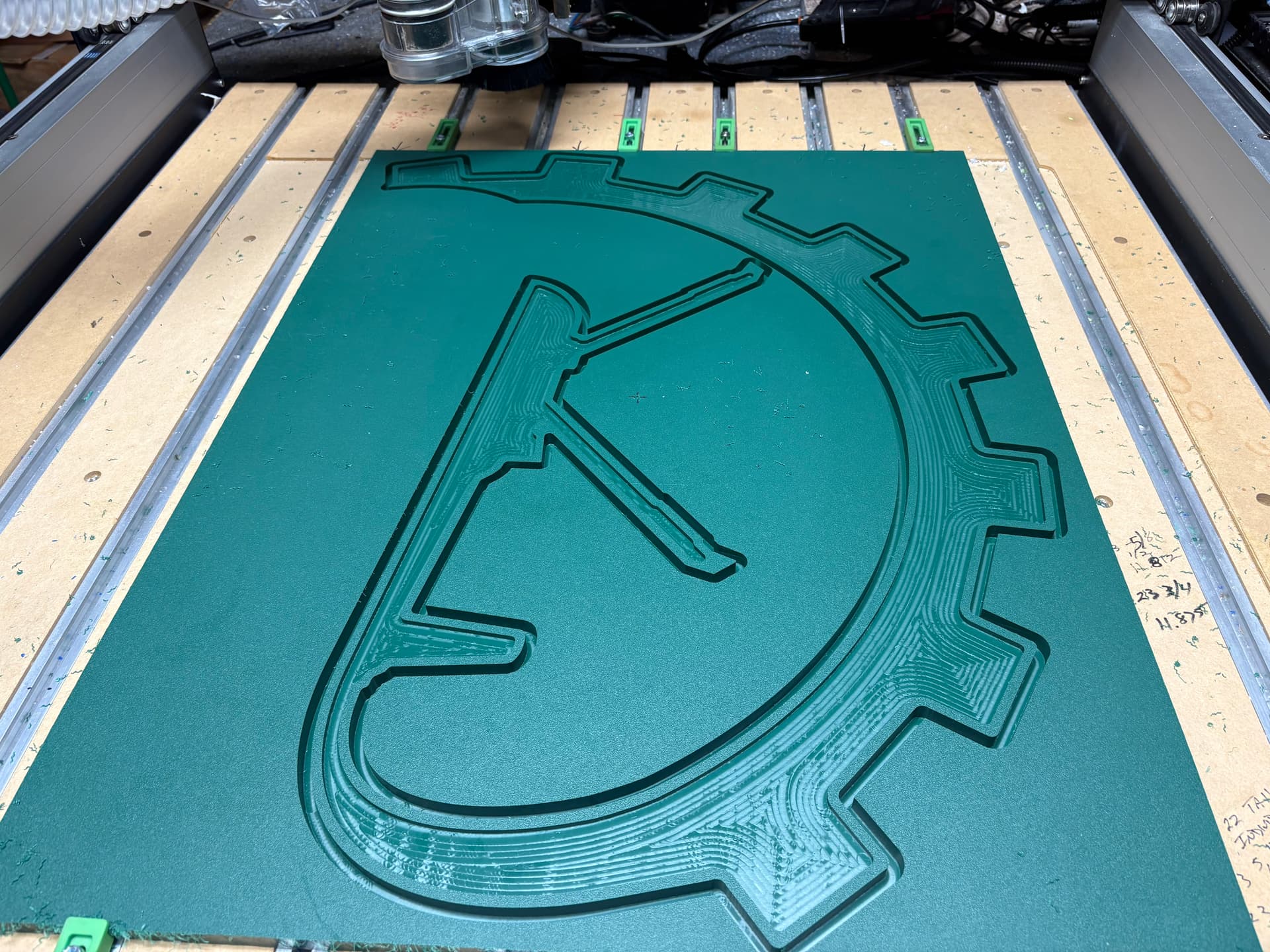

Thank you Here’s half almost done
