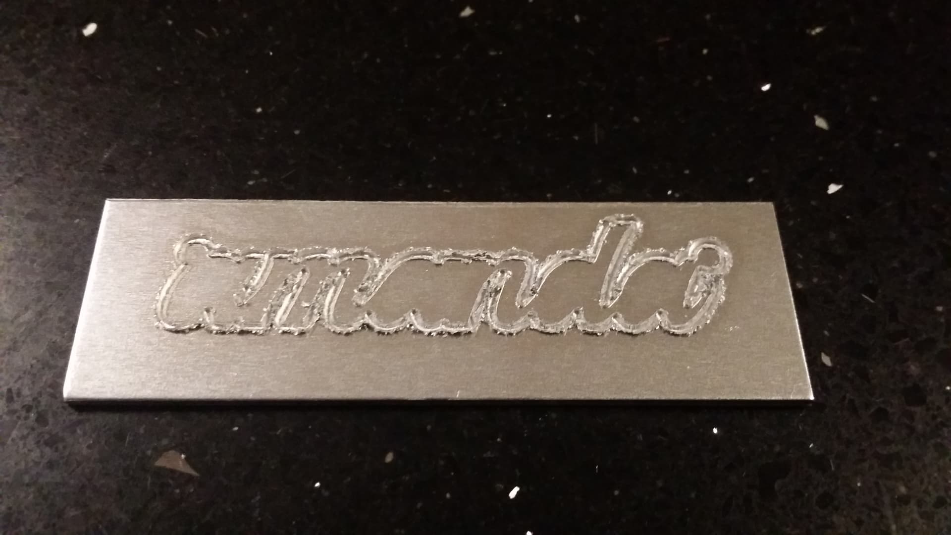

For an example, I was trying to make a name necklace for a friend and it was cutting out with some pretty nasty burrs. This is with the 122 1/32 endmill from C3D with a depth of cut of .004, feedrate 10 ipm, 10000 rpm and a 5 ipm plunge. I played around with those settings a little bit but the results were always similar. I suspect part of my problem is i think the alloy is 3003 which i’ve come to learn isn’t ideal.

You can get really clean result in Aluminium with the Shapeoko, but it’s tricky to get the recipe right.
First, as you say 3003 is not the best Aluminium to cut on a high speed machine without coolants. I try to use 6083T6 (6061 equivalent) and it generally chips rather than goops when cutting.
Second, single flute endmills survive a lot better in Aluminium as they tend to have a lot more space to clear out chips, I use DLC coated single flute from this local supplier, here’s what I was running today
Third, some lubricant helps, especially on these small cuts, try some Isopropanol, it evaporates off on it’s own and leaves a clean workpiece and doesn’t leave the machine oily. I squirt tiny amounts into the cut with a syringe, especially when drilling.
Fourth, I think it might be better to be able to feed faster through the aluminium, to get chips and not spooge and avoid local heating, try for 15ipm, 20 for a bigger cutter, go shallow depth of cut to avoid overworking the tiny cutter. You got away with a DoC of 0.04 at 10ipm so try 0.02 at 15 or 20ipm just to see if it helps. I don’t know what the suggested feedrate is for that cutter but it’s certainly not machine limited at this size.
Fifth, I’ve found that a chamfer mill (90 degree V bit) putting a small chamfer on the edge of the text can do a nice cleanup job in wood, plastics and metals.
This is a bit larger, it’s 5mm 6083T6 plate and the smallest cutter I ran was 1.5mm, you’re a bit smaller than that. I squirted some Isopropanol into the cut for the toolpath which cut the base of the letters to get it shiny, deliberately left the tool marks as it was meant to look industrial
