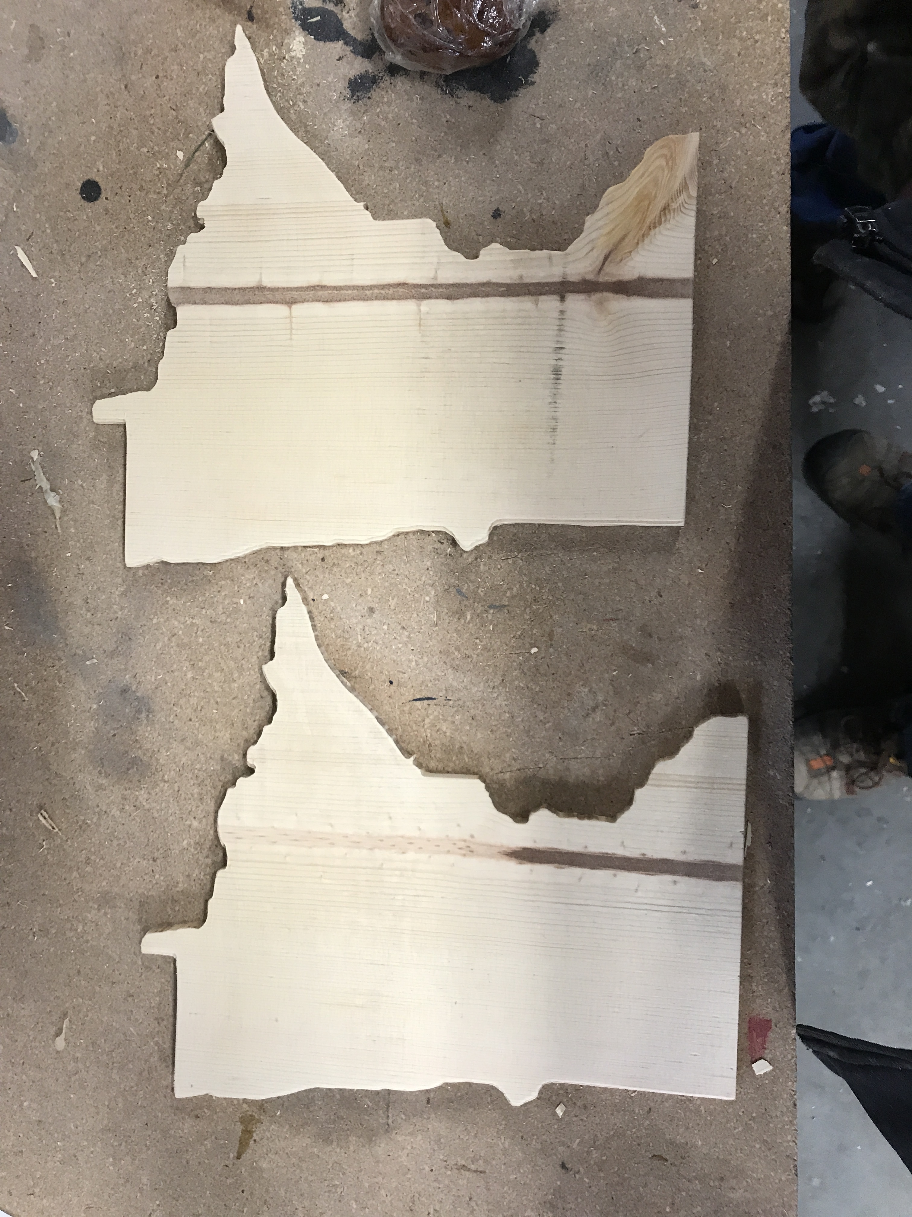

I was able to do some testing after work, there is good news, bad news, and of course ugly news. So what I did was download a new DXF recreated it in vcarve with a 60”/minute feed and did the same in Carbide create. I tried running my original file just as a control method of sorts and the bad news is it still cut really slow. So I then tried the carbide create file and it cut as fast as expected ~7 minutes.
So with a little encouragement from that and some beer I prayed the new vcarve file would produce the same results. Loaded and ran it and it ran along like it was the FLASH (when compared to the original attempt) and was also right around the 7ish minute mark.
So I can only assume it was something wonky with the original outline that I downloaded. I was super excited to try and toss together a couple more vcarve files just to make sure it is all working as it should but alas that was not meant to be.

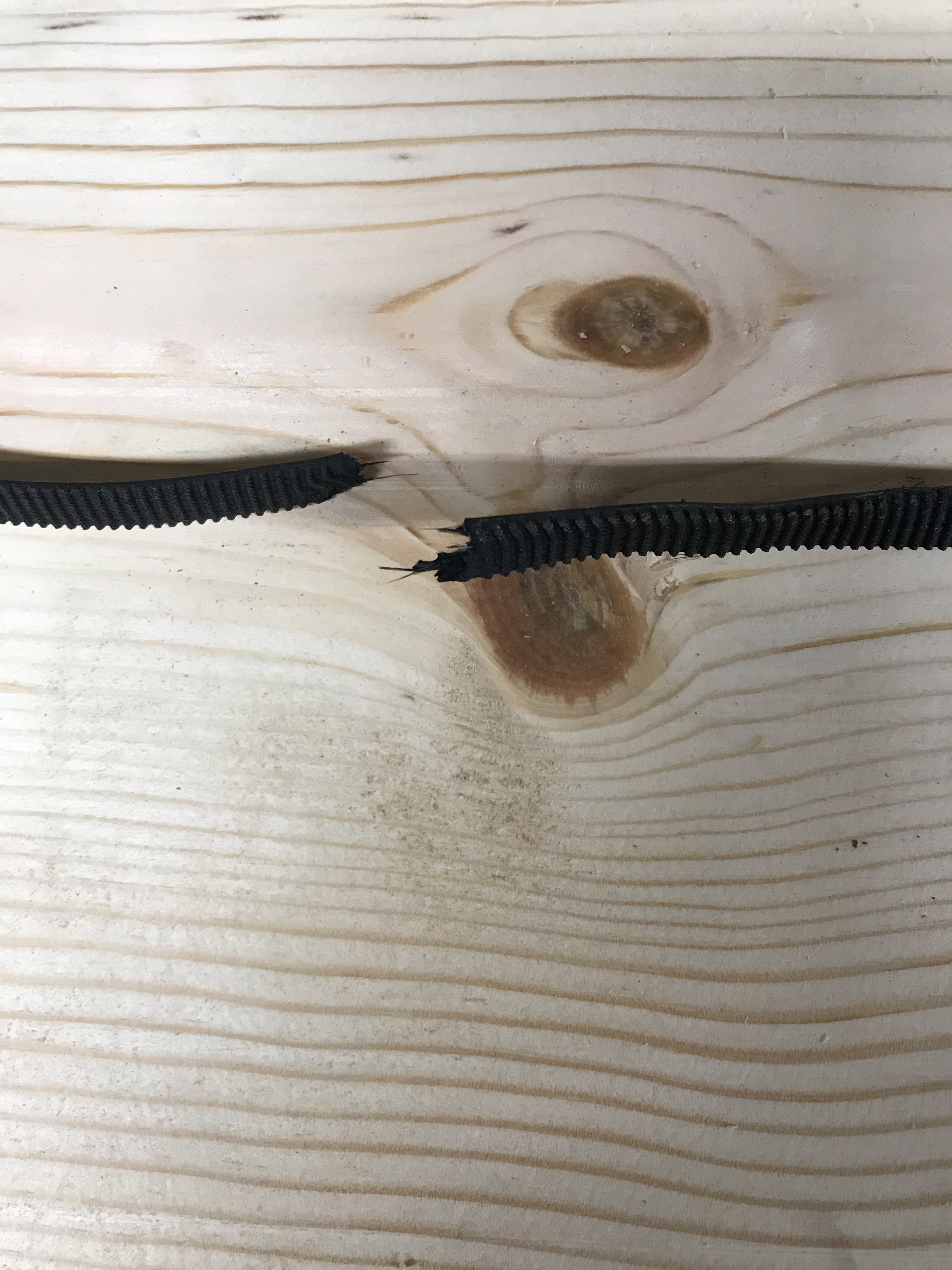

There goes the left Y axis belt I think the temperature drop might have cause some shrinkage and too much tension. So now I have to wait for amazon to deliver me some more before I can do further testing.
