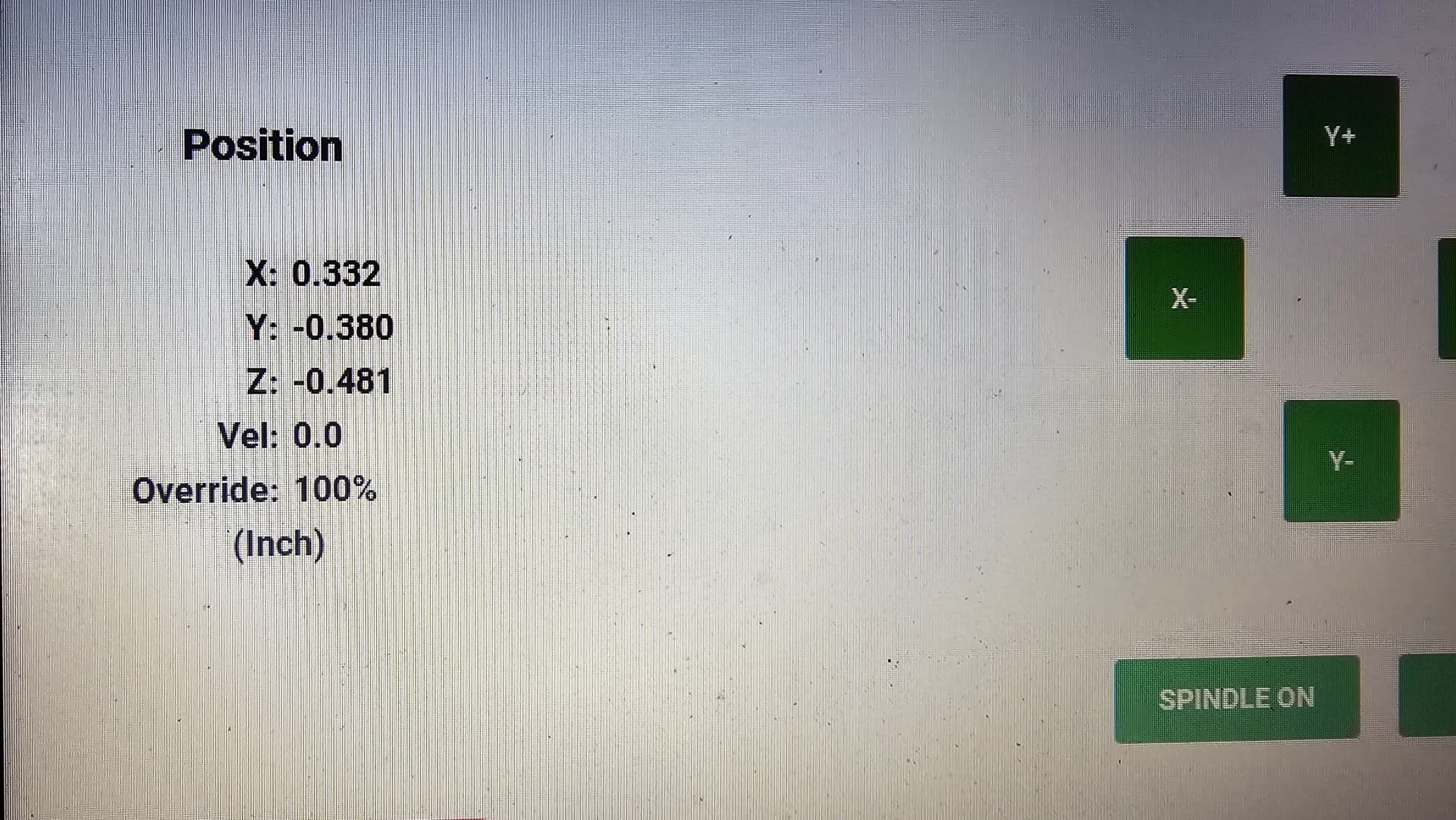

So i did try checking the z value after i zeroed the work. At the top of the stock it read 0.000. At the waste board it would only go down to .481 and my stock is .75 thick. Checked my limit switches it seemed to be working. I had my bitzero get a little warn out and the light would not stay on. So i rewired it and secured had it worked fine. But still not able to touch my waste board.

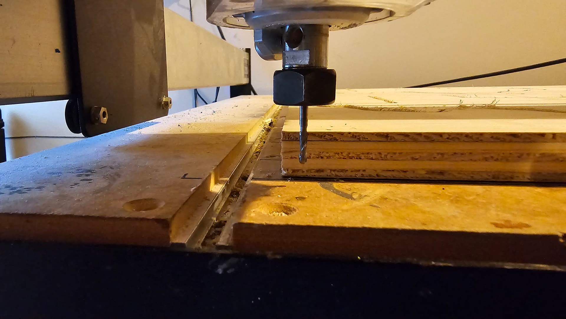

Looking at where the Z Carriage is, do you think it should go further down? It sounds like you just ran out of Z travel. Have you been able to jog down using this bit to the wasteboard before?
CM will limit your Z travel to how far it ā€˜thinks’ it can go. During a cut, CM will just send the commands, so it’s possible your Z distance is too small in CM. You can change this.
You can also look at how the router is mounted, if it’s high in the mount you could move it down.
Finally, maybe you need a supplementary wasteboard. When I got my S3 XL, I found that a 1/8" bit wouldn’t go down to the factory wasteboard no matter what I did. I added some MDF on top of the factory wasteboard. As an additional advantage, I can replace that instead of the factory board when it’s time.
One other thought. If your using that 1/8" bit for a through cut, don’t. It only has 1/2" long flutes and will end up rubbing the shank as it goes around for the last 1/4" of depth of cut. You need a bit with flutes as long or longer than the thickness of the stock when making a through cut.
The Shapeoko 3 w/ Z-Plus has its working area higher up relative to the baseplate — use longer tooling when you need to reach lower or add a supplemental spoilboard to lift things up.
A bunch of us don’t use the ā€œbaseā€ board as a ā€œwasteā€ board. We add another ¾" wasteboard on top perhaps with additional clamping points. Solved a lot of that kind of problem.
