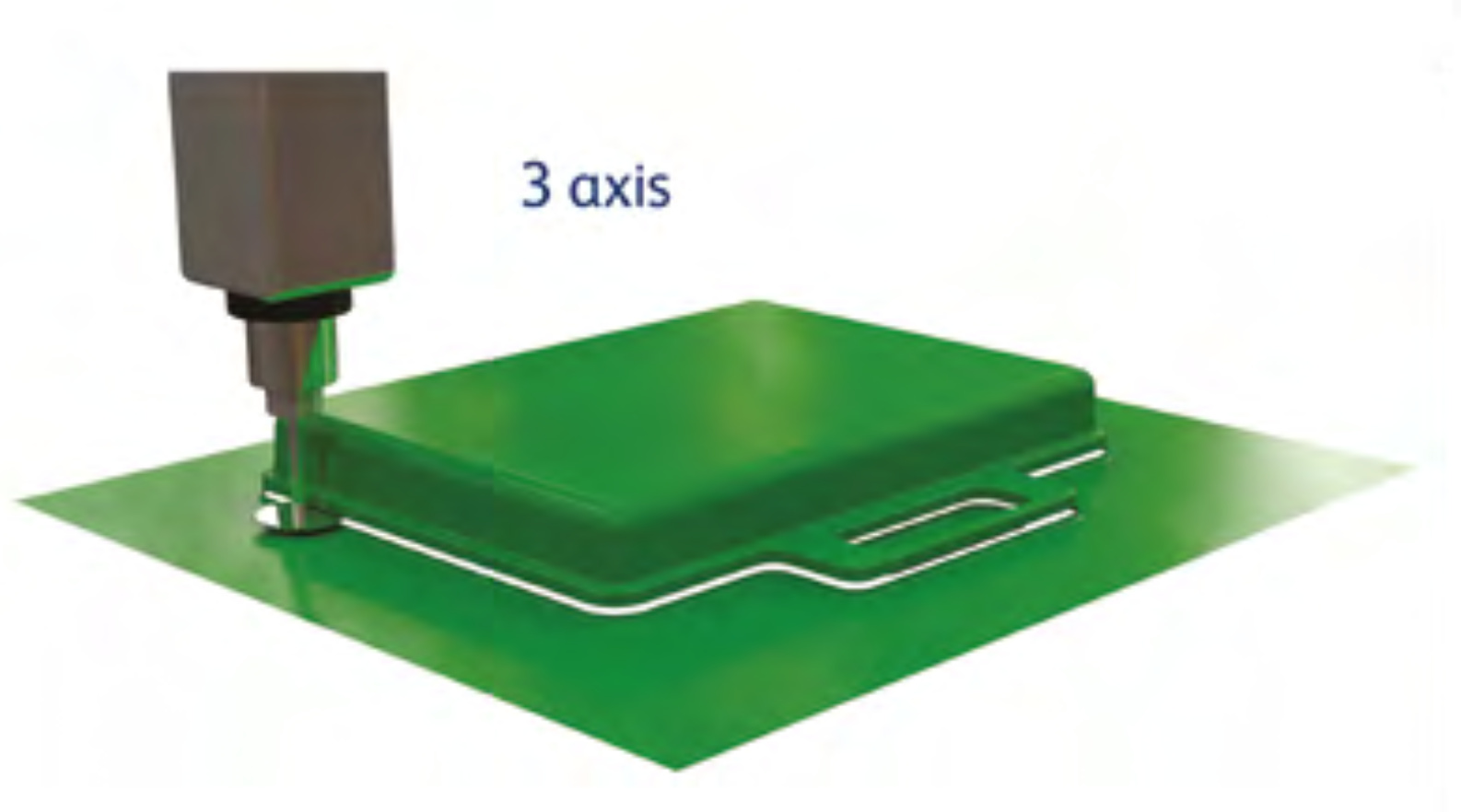

Hello,
where can I buy tool (what is it name of this tool), which is on the picture, for cutting the plastics at Shapeoko XXL?
Thank you!
Tom
It’s a slitting/slotting saw —
https://www.mscdirect.com/browse/tn/Milling/Milling-Saws/Slitting-Slotting-Saws?navid=12106272#navid=12106272+4287624246
(note that I haven’t used one and am not specifically vetting the use of one — please check the rated RPMs for the tool, and ensure that the router / spindle is matched to that, then work up toolpaths carefully, setting suitable feed rates.)
