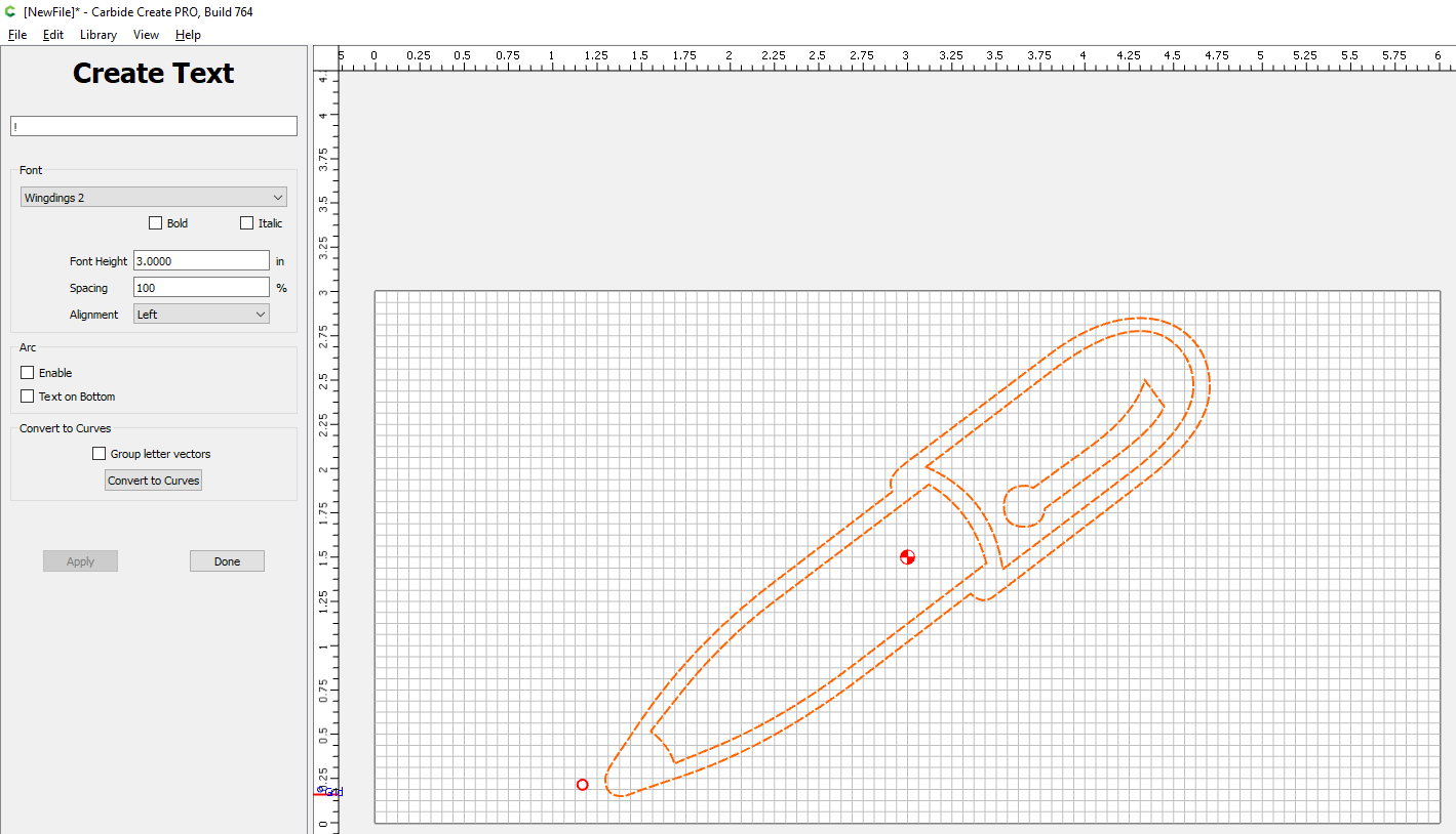

This is pretty random, but I needed some additional fonts. I finally figured out how to get fonts from Dafont into CC with Install for all Users. I found a wingding/dingbat there with a nice selection of guns. So I installed it, but does anybody know how to get to a specific gun/wingding? If someone wants to look, it’s at Dafond.com, Theme, Dingbats, Army, Guns 2. When you choose Text in the project, and go to Guns 2, it just brings up a couple of random guns.

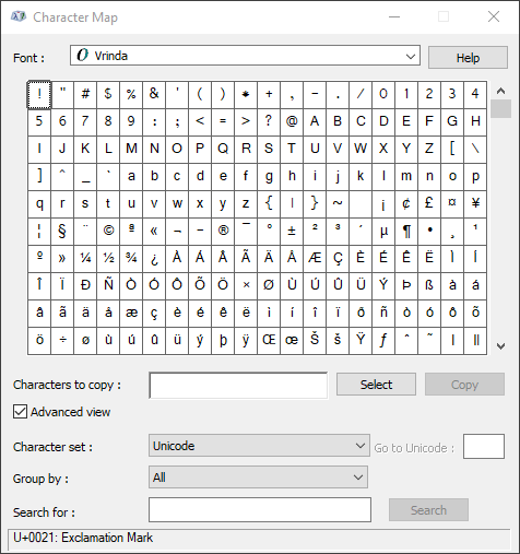

Each “character/glif” within the font is mapped to key on your keyboard.
If you are using windows, run a program named “Character Map” to view all the glifs.
Once you locate the image (row and column) switch back to a traditional font and see what character that is.
So my example that character that looked like a pen was the ! character. So in Carbide Create I just select the font and type the ! character…
Thank you so much, that solved the problem.
