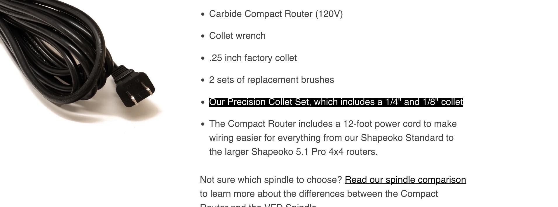

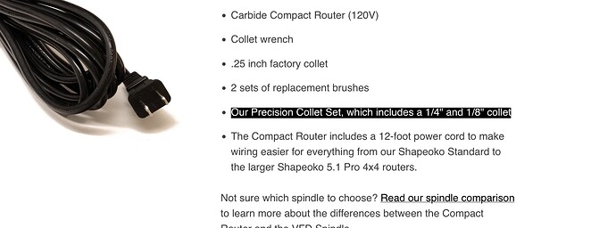

Main complaint is the collet being a pain and no option for 1/8" bits. Thoughts?
Checked them; about half used.
There is an included 1/8" collet in the box.
