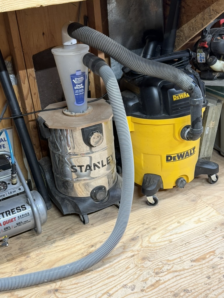

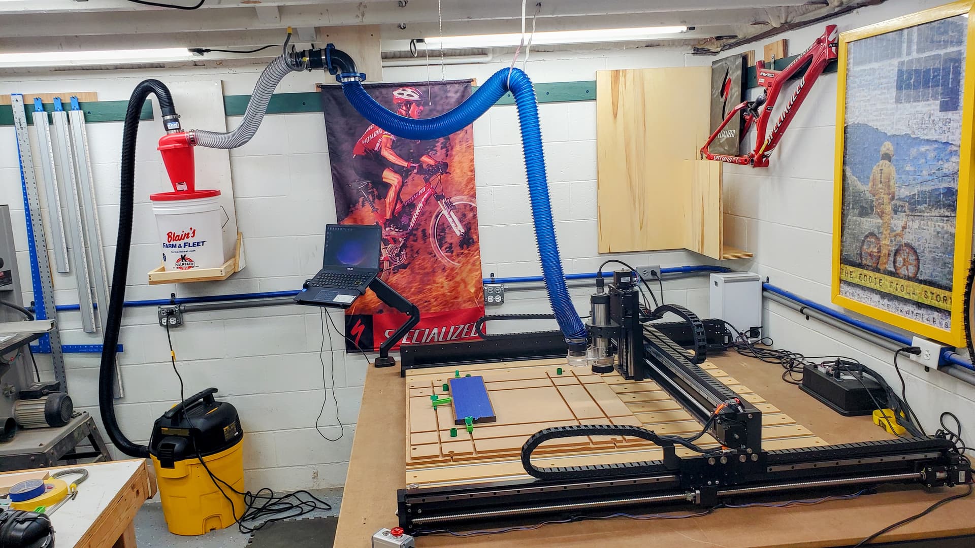

I recommend to have a separate DC for the CNC, as long as there is no sophisticated remote control for the vacuum and the blast gates. IvacPro has a nice affordable system, I use the remote vacuum switch for the CNC.
